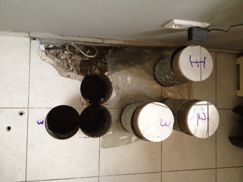

Since 2011, progress has finally been made. A lawyer has been involved, and a court-appointed expert visited the site. Numerous photos were taken of the damage, and core drilling (3 holes with a diameter of 16cm (6 inches) each) was carried out in the utility room.

Could you please share a photo of the core drilling?
The core drillings are approximately 16 cm (6 inches) in diameter and about 30 cm (12 inches) deep – they had to go through the screed, the concrete slab, and into the ground. After that, several photos and measurements were taken, and the tiler professionally sealed it again.
The first drilling was done too close to the wall, which caused a short circuit, and the power went out here for a few hours until the emergency electrician arrived. That’s why there is the elongated hole; they had to repair the cable and chip open even more.
