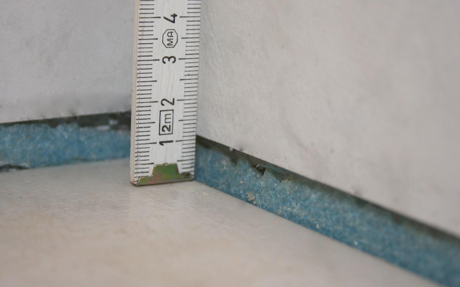

After completing our house, we were told that some settlement cracks might appear. What is still considered normal?
On the ground floor, in the kitchen and living room, there’s enough space between the floor tile and the edge to fit a finger. On the first floor, there are horizontal cracks in the wall. The ceiling on the first floor has already been patched with plaster, and the silicone sealant in the bathroom has cracked... *frustrated*.
Honestly, I don’t want to remove all the joints and regrout them, but I probably have no other choice, right? I wanted to ask here first; otherwise, I’ll have to talk to the builder.

Thank you very much for the detailed response. I will try using gypsum to repair the transverse cracks on the wall; the plasterer had suggested acrylic when he filled the cracks on the upper floor ceiling. We noticed the transverse cracks after about three-quarters of a year, although we have been living here for two years already. Scraping them out with a screwdriver doesn’t work very well, unless I want to redecorate the wallpaper.
I will remove the expansion joints and redo them. BUT the expansion joint cracks in the kitchen and living room look very bad, I will try to take a photo :-(
