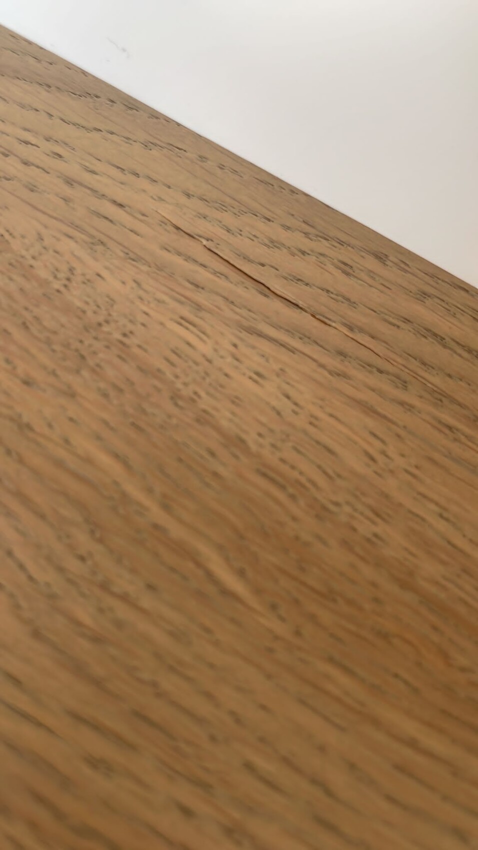

Hello, in our new house (solid construction) we have a straight concrete staircase.
The treads are made of 4cm (1.6 inches) thick stained oak wood. The risers are made of birch.

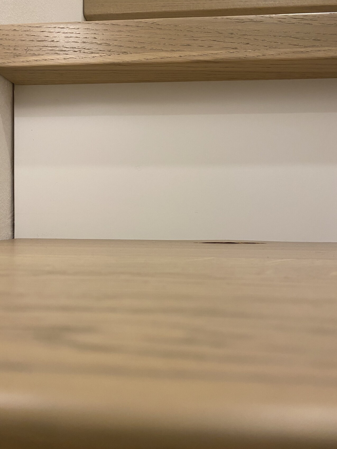

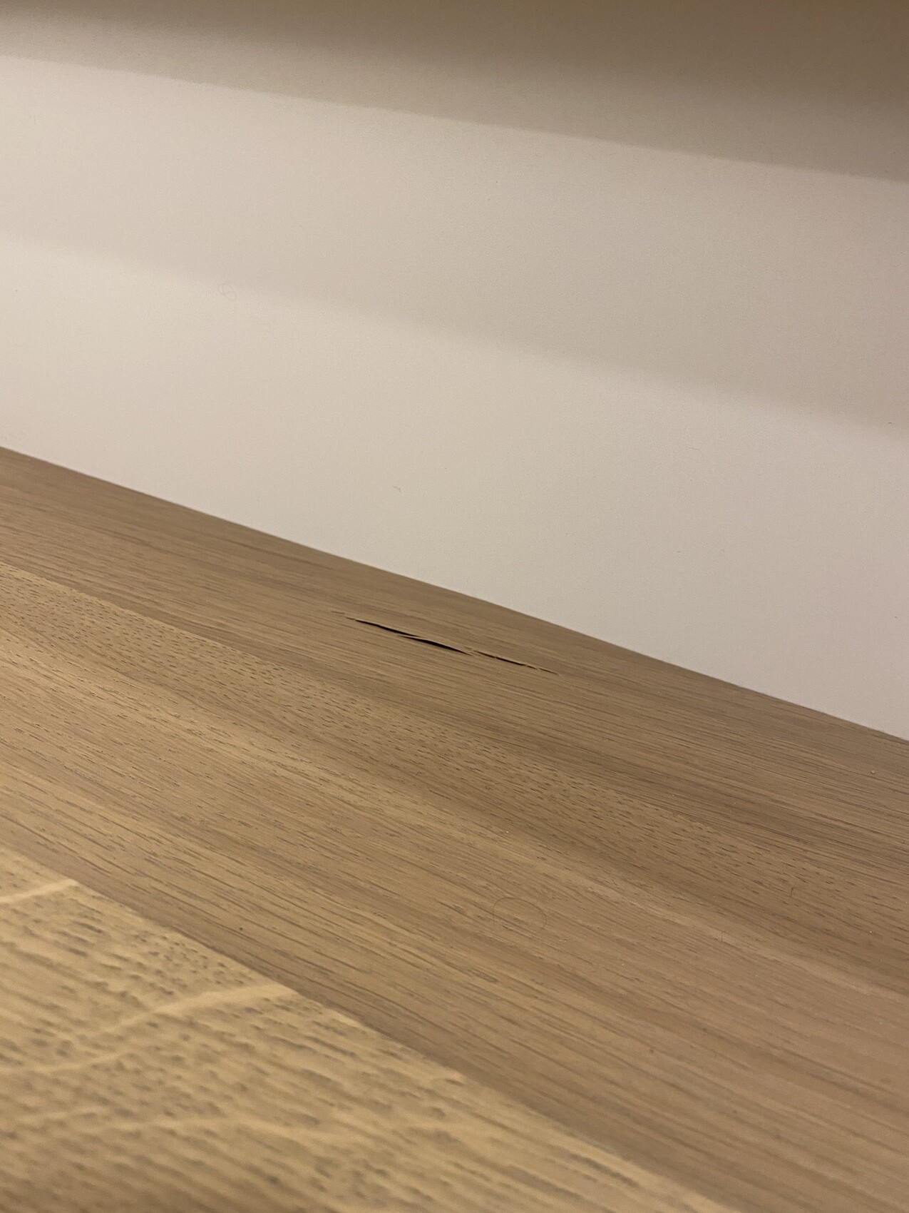

The steps were installed in mid-March. The treads are developing more and more cracks. I first noticed this on an upper step, where there is a bulge and also a crack. Since today, the bottom step also has a crack.
There is clearance on both sides to allow the wood to expand.
Do you have any idea what might be causing this?
Myrna_Loy12 Apr 2022 17:02This is too dry for wood. At around 55% relative humidity (rH) wood is stable; 35% rH is a level where visible drying processes occur, especially if the wood was significantly wetter during installation in the house.
Coletrickle_780812 Apr 2022 17:11So a 4cm (1.6 inches) thick oak stair tread would split after just three weeks?
Coletrickle_780814 Apr 2022 12:44Since yesterday, we have had a relative humidity of 42%, and today it is at 49%.
Perhaps the low value was also due to the fact that we only moved in recently, I’m not sure.
The stair builder was here, and the 3 steps will be replaced. He has the following suspicion: since all the cracks are always at the back right or left, and the steps are additionally screwed in there, he assumes it is most likely the screw.
