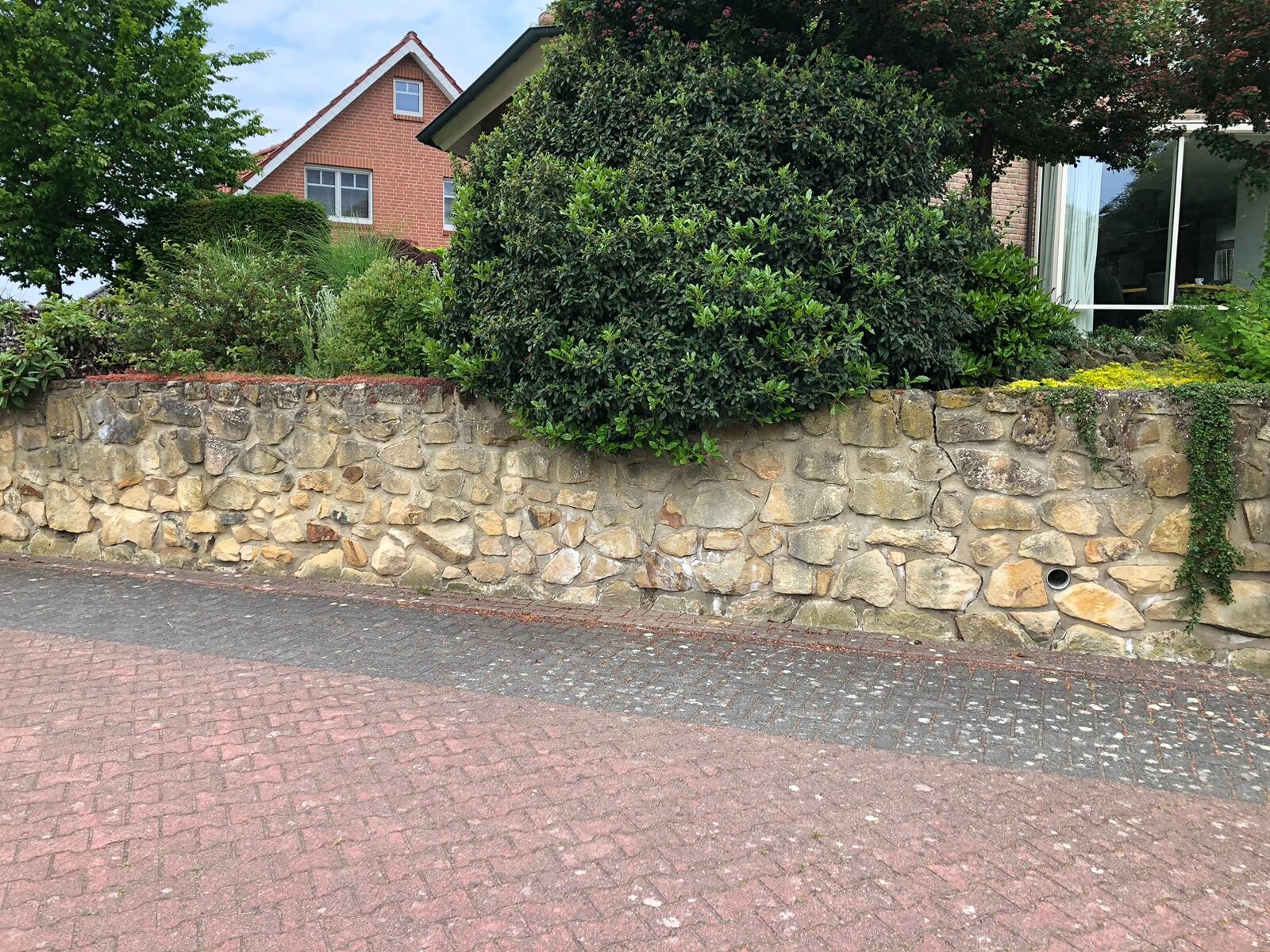

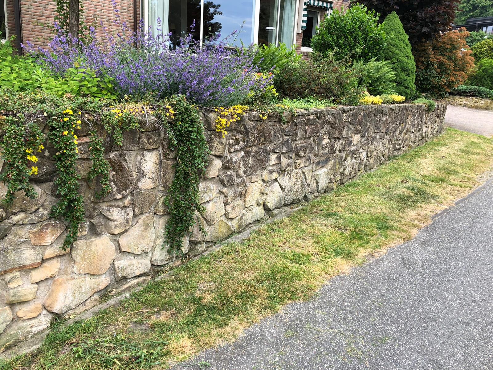

Two years ago, I bought a house surrounded by a sandstone wall. However, the wall has some (few) cracks in certain areas, and I am a bit concerned about its stability. I would also like to improve the appearance by "removing" the cracks. The largest crack can be seen in picture 3.
What would you recommend doing here, and how extensive is the work needed to ensure the wall’s stability?

Is a part of the wall leaning forward more? Otherwise, I would attribute this to uneven settling.
Thom321
12 Jun 2023 22:10
No, the wall is perfectly straight. There are just some isolated cracks visible. As mentioned, the largest crack can be seen in the last picture. The question is whether this is mainly a cosmetic issue or if I should be concerned about the structural integrity. Obviously, I would prefer it to be a cosmetic problem... Unfortunately, I am far from handy. As a layperson, the only thing I can think of is to fill the crack with putty. That would be the cosmetic solution...
haydee
12 Jun 2023 23:18
If the wall is perfectly straight, I would proceed with pointing. Do not use cement mortar.
Thom321
13 Jun 2023 06:02
Ok, all clear. Thank you. So it is more of a visual issue? I will start looking for the right materials for grouting and begin researching the topic...
haydee
13 Jun 2023 08:02
I believe it was caused by some settling or something similar and is more of a visual issue. I'm not an expert either.
It's not that difficult. I inspect my wall every two years.
