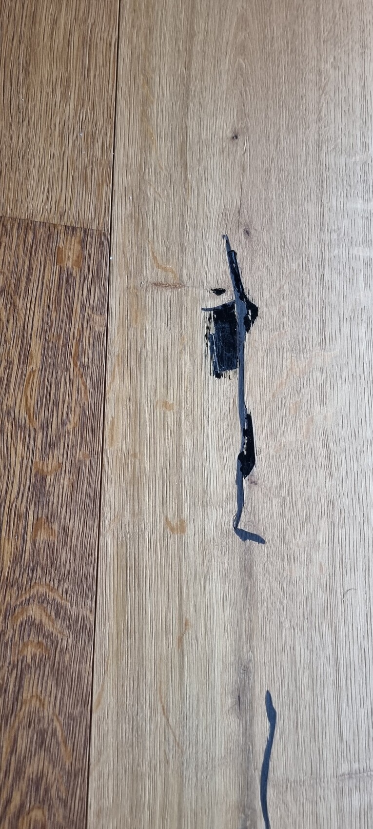

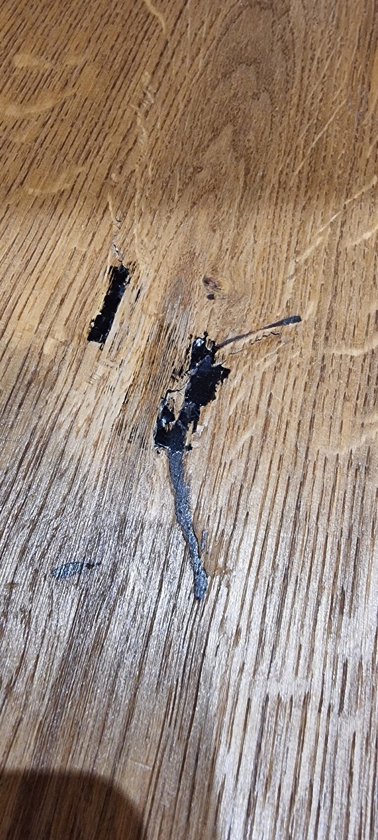

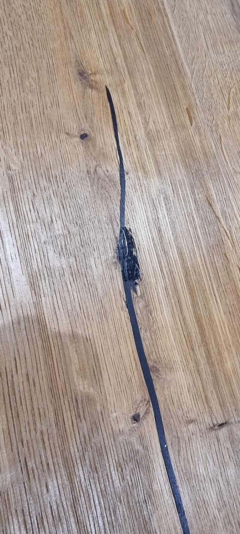

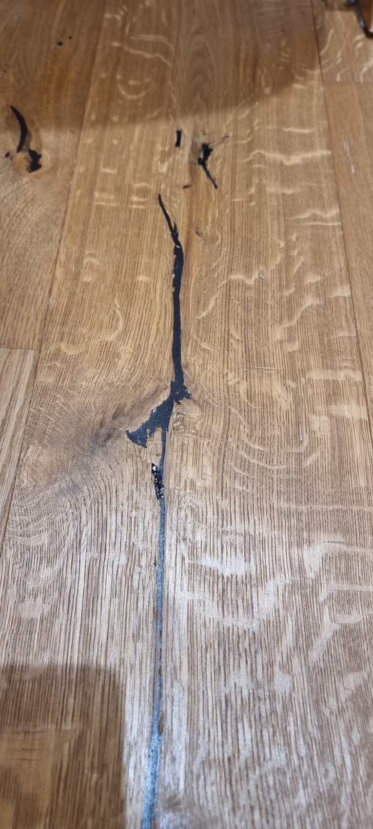

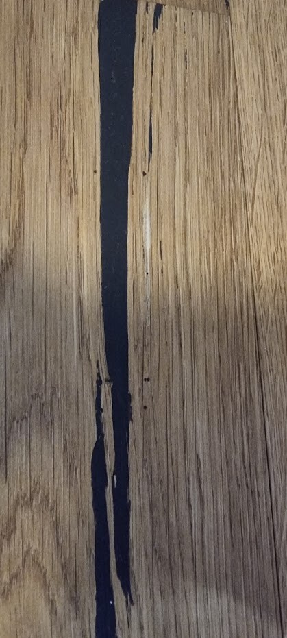

If a fabric cleaning cloth gets caught or if you can get splinters, then I definitely consider that a defect. If it's "only" a visual issue, one might see it differently. We are certainly a bit more sensitive, but also because we have small children. In the kids’ room, a splinter about 20cm (8 inches) long came off a floorboard, which is obviously dangerous. Visually, however, it’s not a big deal for us—it hardly shows:
It’s wood, and it naturally expands and contracts, which is understandable and acceptable to me. More unpleasant, however, are the spots that have already been patched but are partially "splitting open" again, with the explanation that "there are air pockets under the top wood layer, so it sometimes just comes loose, which is completely normal" (quote):
Are we being too sensitive? These are only a few examples. The spot in the office is visually the worst. It is now supposed to be replaced, although a “built-in” office cabinet stands on that floorboard. The board will be cut, and only the half with the repair will be replaced.

Basically, for wooden floorboards, decking boards, and all wood-based materials:
Splintering, which poses a risk of injury, must not occur under any circumstances!
Depending on the grading criteria (which can be found on the product datasheet or should be indicated on the packaging),
any cracks filled with black filler have already exceeded the limit of reasonable acceptance.
There are different grading requirements depending on the grade the customer has agreed on with the retailer (or as advertised for the flooring).
For the grade with the lowest requirements, the following apply:
However, the color difference of the filler must not be as pronounced as shown in the picture/photo, and the size or length of the cracks would also be a reason to question the original grading.
As soon as the visual appearance is significantly impaired by filled cracks, knots, or sapwood, the retailer can no longer justify a lower purchase price.
Unless the builder was clearly informed about these aspects before purchase.
Regards, KlaRa
