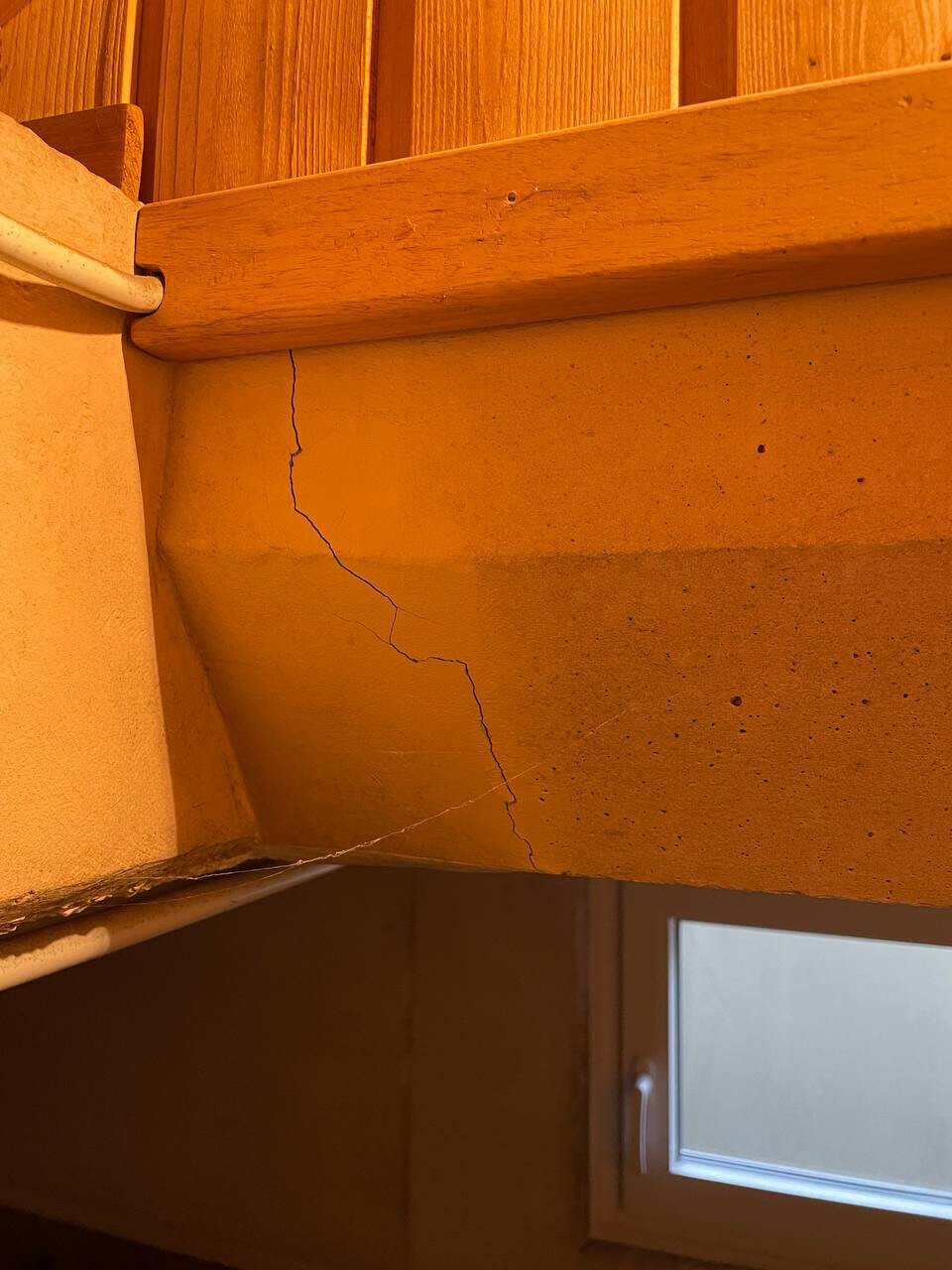

Interior: Wood paneling, crack in yellow wall under beam, window at bottom right.
At first, the crack was more like a slight indication, but it has been getting wider over time. There was also a crack at the bottom at the beginning, and now both cracks are essentially connected.

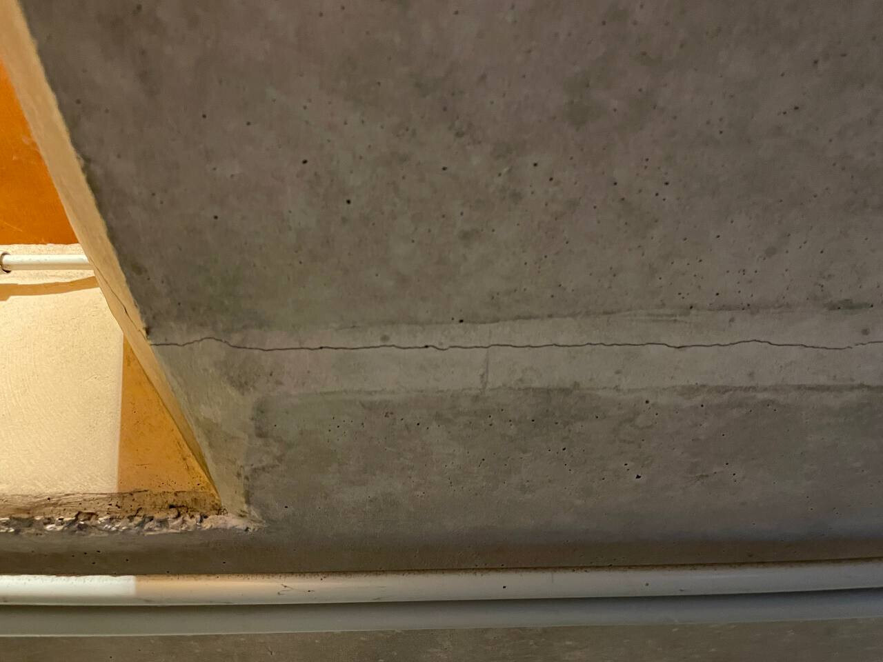

Crack in gray concrete wall; left orange corner, white pipe visible at bottom.
The ceiling also does not appear to be level; one panel seems to be slightly lower than the other.
In der Ruine27 Feb 2025 17:53
35 years old, nothing should still be shifting. Have you made any structural changes? The concrete slab has already been patched before. The reinforcing steel will probably hold it together, but it still needs to be checked.
