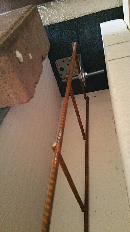

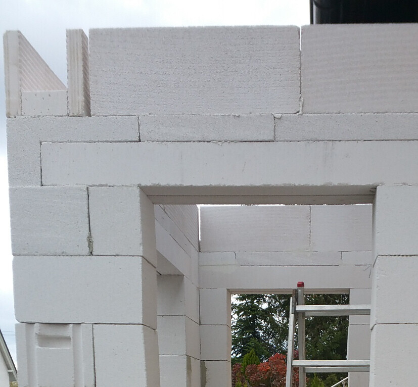

I have a problem that should be simple for roofers, but I want to try to solve it myself.
I have built a new porch in front of the entrance door. It needs to be roofed. I have already installed the rafters and purlins and am now sheathing the porch roof.
Now I have the following issue. The porch is positioned perpendicular to the ridge line of the main house roof. The porch roof is supposed to be under the eaves of the main house roof. However, at the height where I am sheathing the porch roof, I am already hitting the gutter of the main house roof!
I have attached some pictures of the situation.
What can be done here? How do you connect roofs at a crossing point?

Thank you for your reply! There is indeed a downpipe on the other (left) side of the same eaves line (of the house). However, it is only decorative. If the gutter’s slope is adjusted, it could be put to practical use. Still, the main question remains: how do you connect the two roofs? The 10cm (4 inches) gap will not be enough to fit the ridge tiles of the porch under the main roof at the junction.

Understood! However, this is not so easy because of the ring beam I placed under the purlins. I don’t want to damage it by taking it down.

I would always assume that the original poster has not confused fundamental details, especially since they remain consistent. Is it really plausible that the original poster has forgotten that a ring beam was installed, or that window and door openings including lintels were created??? And it fits with the fact that the height difference has increasingly decreased!

@11ant is right. Either remove the ring beam and rebuild it deeper, or raise it significantly higher with the roofing felt so that it can be properly integrated with the existing roof structure. As it stands, it's problematic in every way. Alternative: standing seam roof or bitumen membrane.

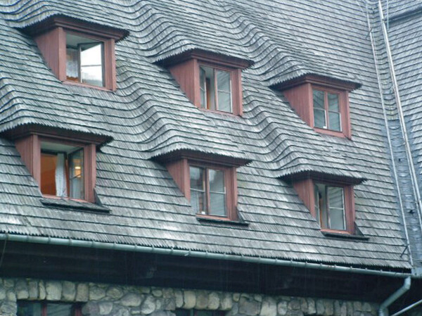

Mottenhausen28 Aug 2019 09:41Respect for the effort put into this. Normally, in a case like this, the ring beam is installed at the same time as the lintel – at lintel height. This is all much oversized now for the small porch? Even screwed to the wall, what you built there is rock solid. I also understand now why a dismantling is out of the question.
I don’t see a proper integration of both roofs, since the peak of a dormer is usually an unattractive metal finish that, matched to the dormer size with a long valley, is less noticeable. But in your case, only this critical section remains, and I think it’s just not possible to make it look nice.
One solution to connect both roofs would be the option shown in the picture below. But this will be extremely complicated to build, and whether it will look good in the end… doubtful…
