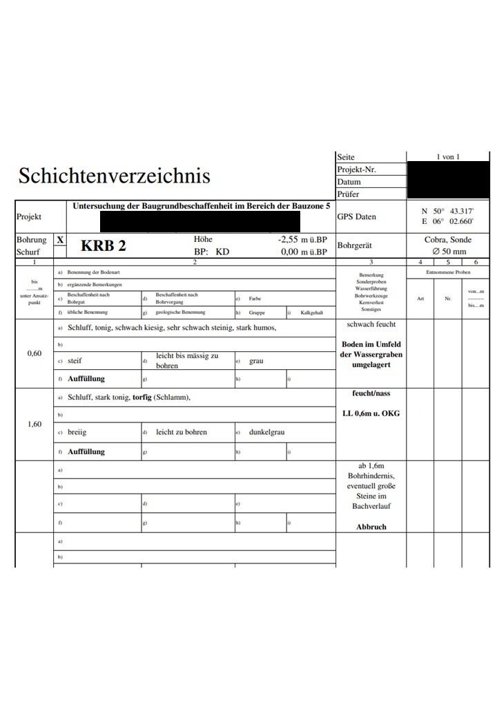

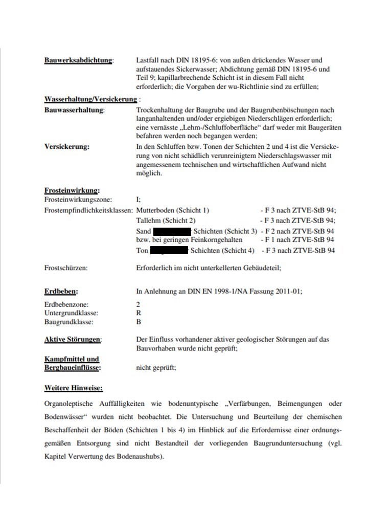

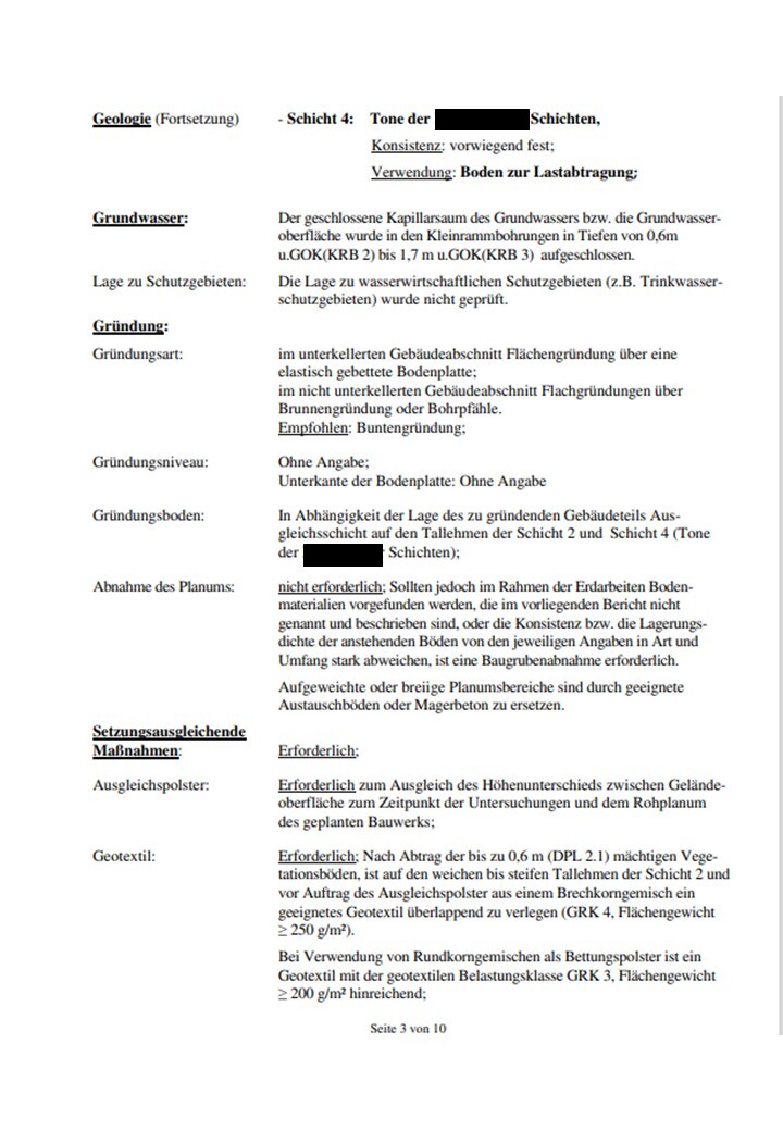

Narnulf136811 Feb 2023 21:09Update:

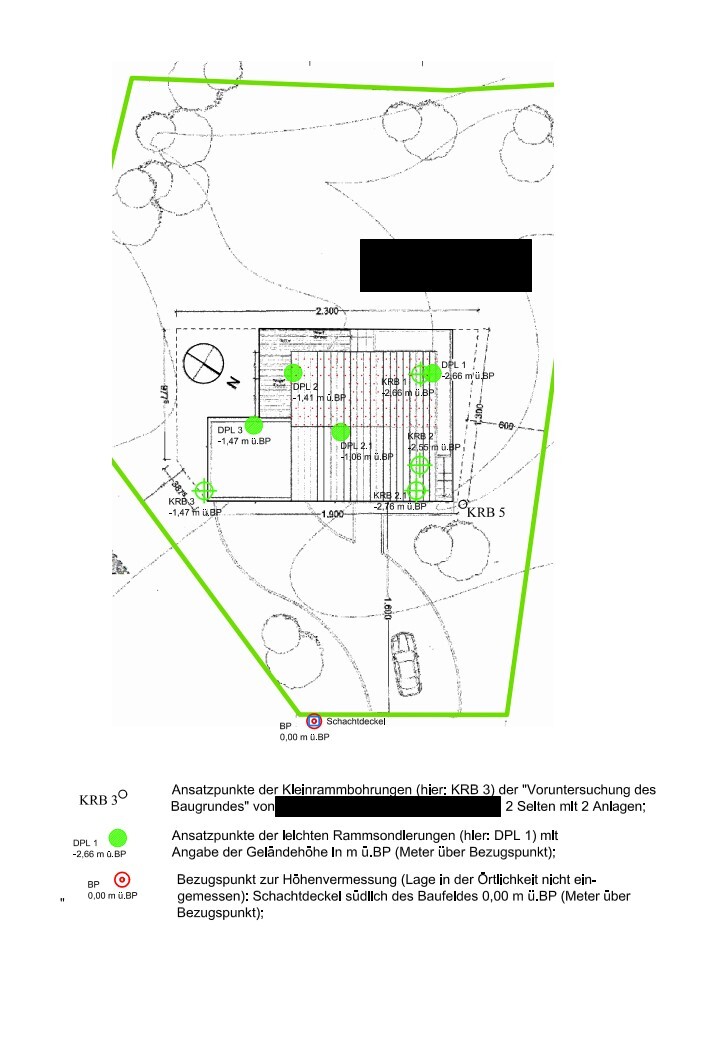

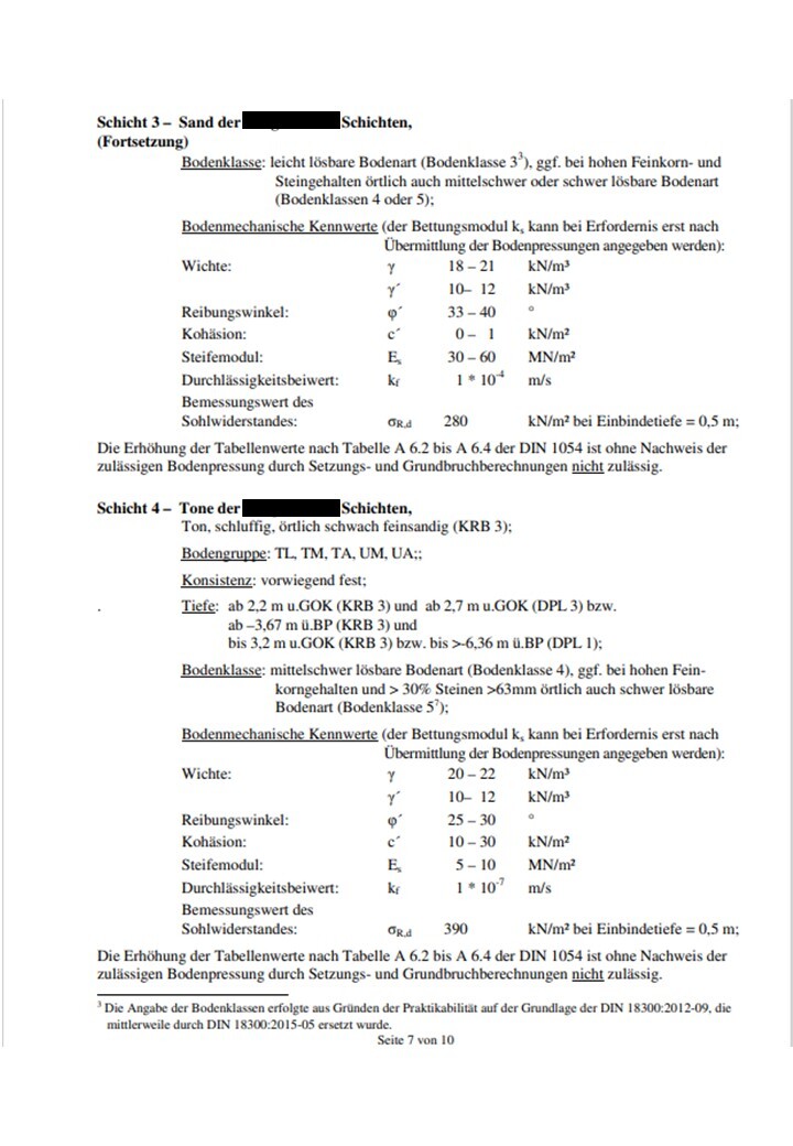

Here is the geotechnical survey report.
It states the foundation type as follows: in the basement section of the building, a raft foundation on an elastically supported slab; in the non-basement section, shallow foundations on pad foundations or drilled piles. Recommended: combined foundation

xMisterDx13 Feb 2023 20:31Well, it also states that infiltration is hardly possible in layers 2 and 4. This means your basement will be submerged in water for a significant part of the year.
You definitely won’t get that basement for 60,000 EUR; it will cost six figures.

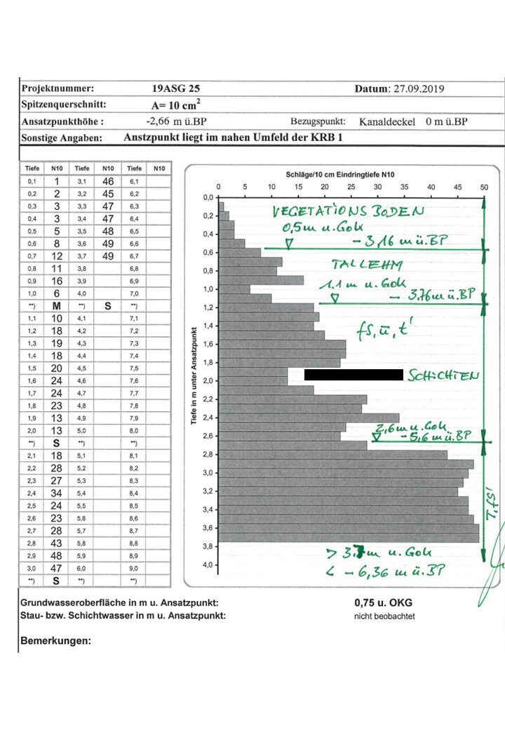

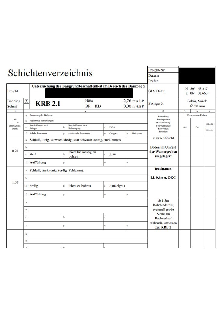

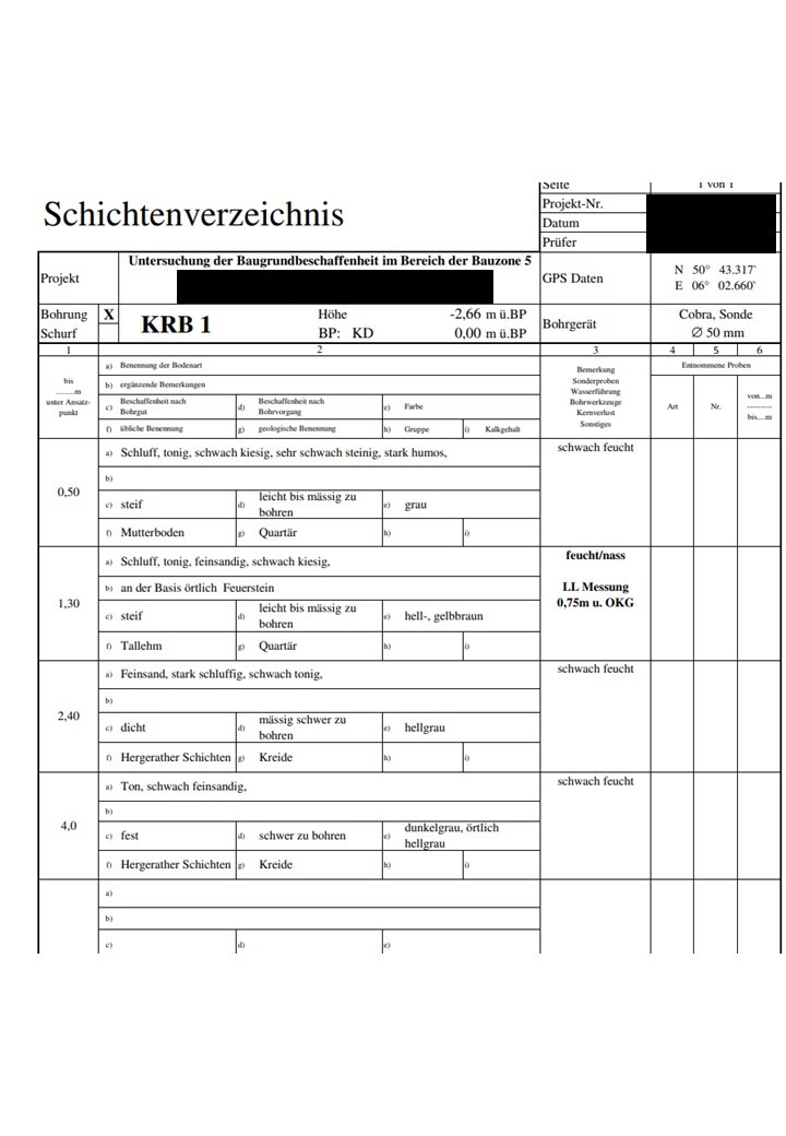

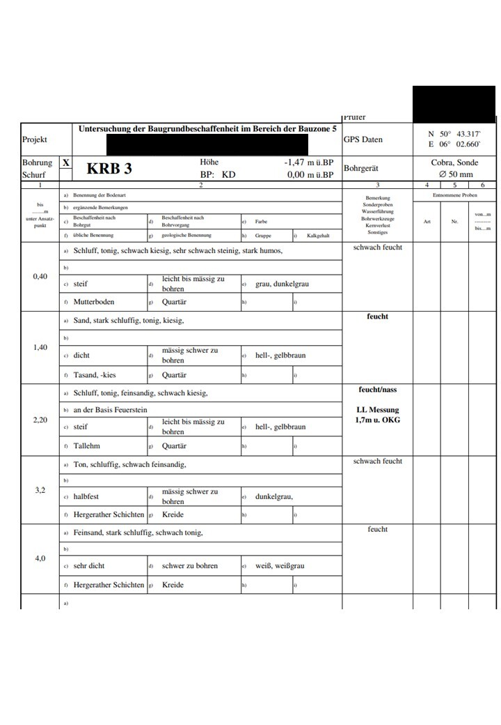

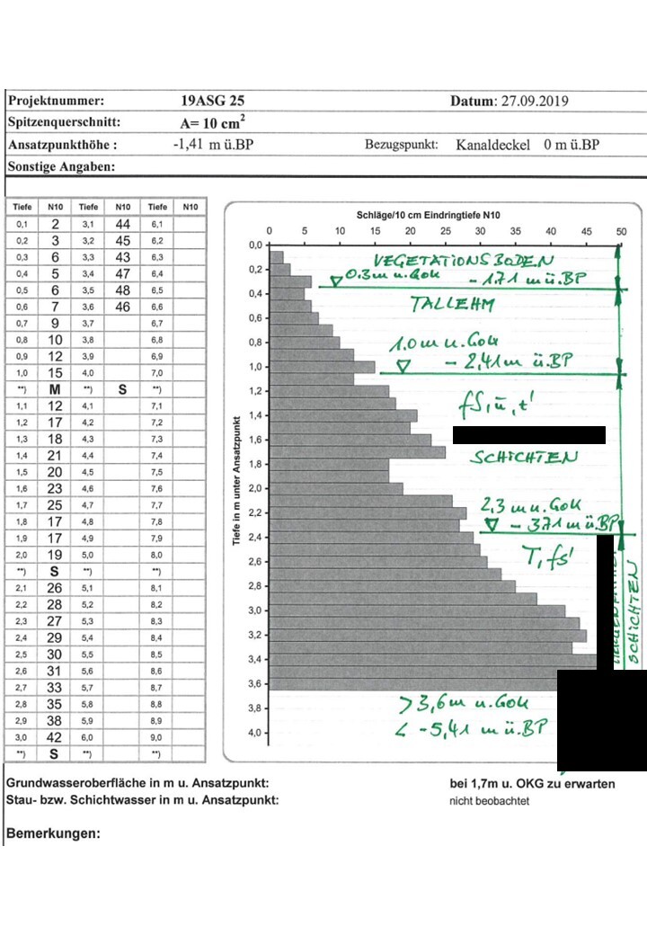

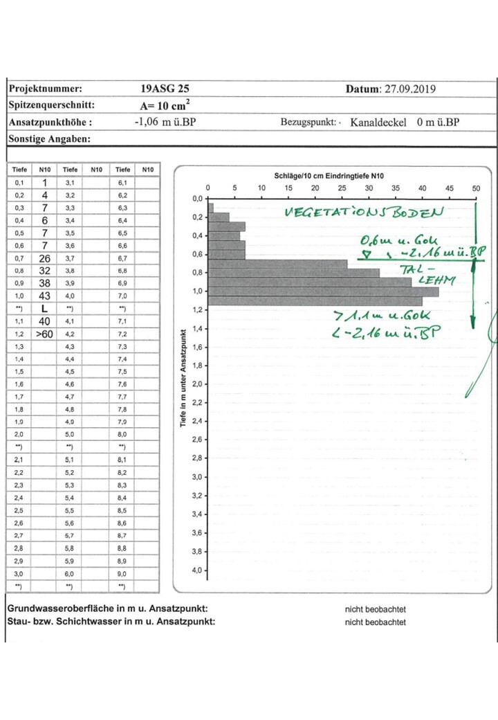

Besides the fact that the report is already several years old, based on the soil layers I don’t initially see any real need for a deep foundation. To make a final assessment, I would of course need more information about the plot, or from the soil report. DPL and borehole profiles would be helpful.
I would suggest getting a new report done that is specifically tailored to your house.
Best regards, Tobi
Best regards, Tobi

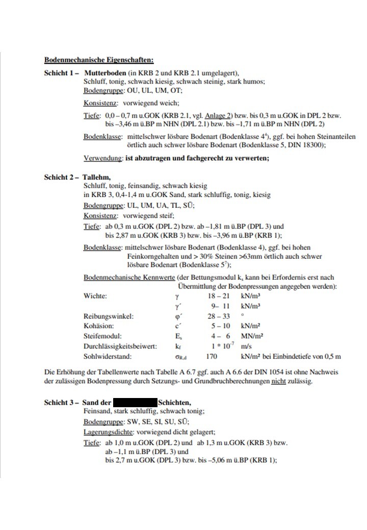

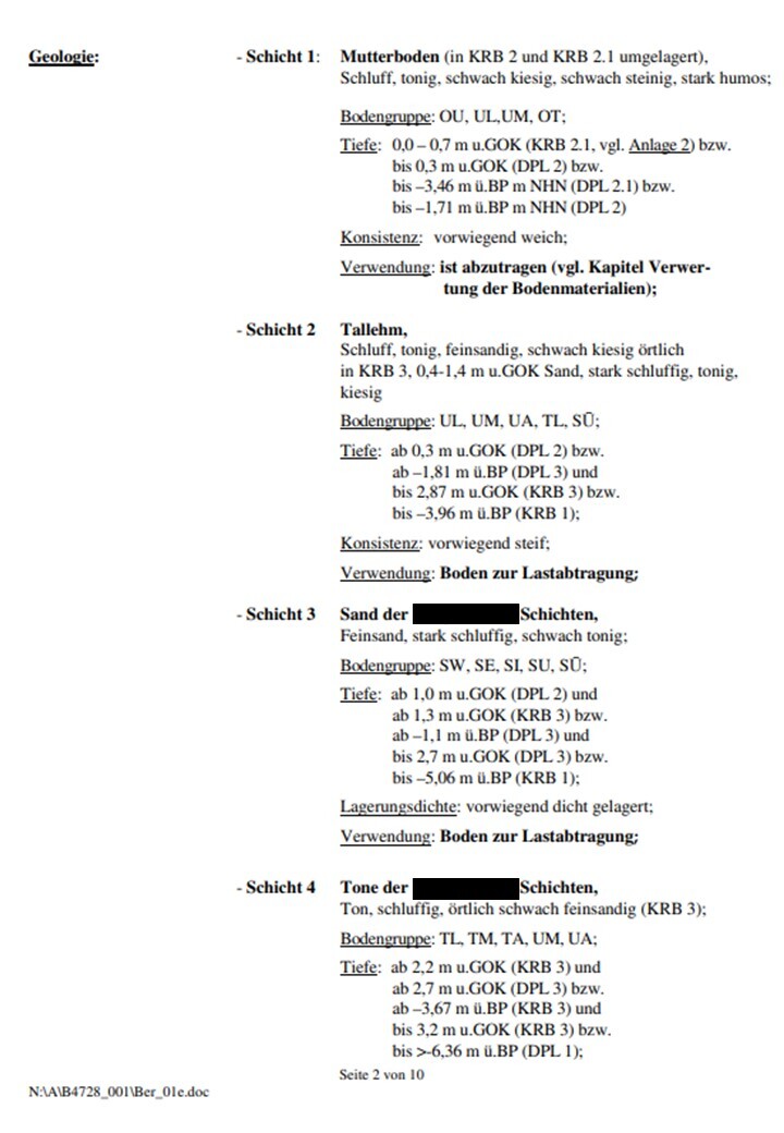

Narnulf136814 Feb 2023 08:31Cronos86 schrieb:
Aside from the fact that the report is already several years old, based on the soil layers alone I don’t see a real need for a deep foundation.
To make a final assessment, of course I would need more information about the site, or from the soil report. Drill logs and borehole profiles would be helpful.
I would consider having a new report done, tailored specifically to your house.
Regards, Tobi Hello Tobi,
thank you for your reply!

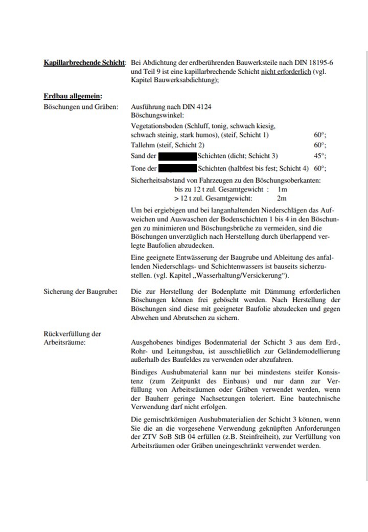

Here are the remaining pages of the geotechnical soil report. Is this enough to assess the situation, or do you need anything else?
We will commission another report once we have the structural calculation for the house. But as I understand it, it makes the most sense to know exactly what kind of house and where it will be built first.
We are just trying to roughly estimate how high the costs for a shallow foundation could be and to compare that with the costs of a basement. We have to decide that already when submitting the building permit / planning permission application.
