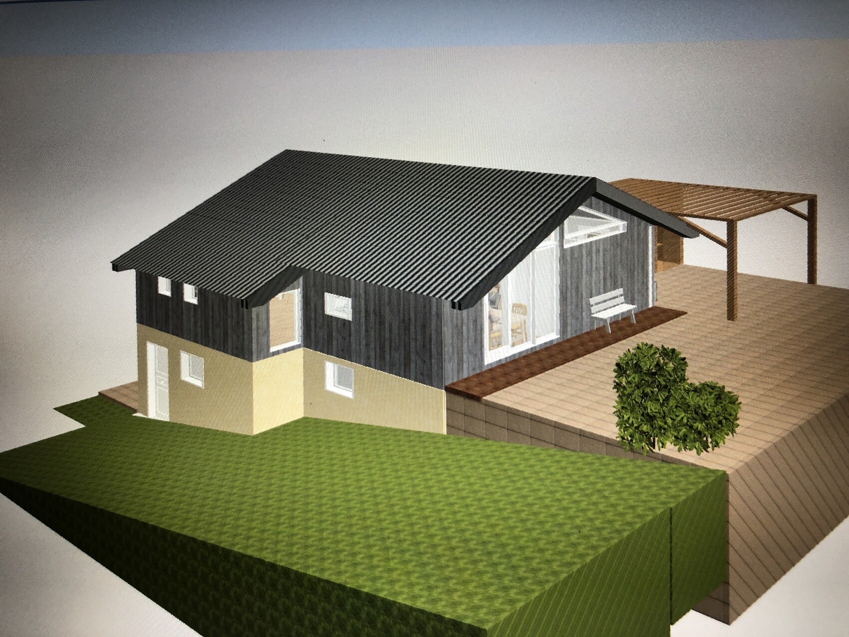

Hello dear forum,
The house contract has been signed, the basement contract is upcoming, and now it’s about excavating the slope for the basement.
The excavation volume will be around 210 m³ (275 cubic yards) and does not need to be disposed of – soil class 3.
What costs should I expect for excavation, backfilling, and spreading the remaining soil on the property?
(I only find prices online that include disposal of the excavation and are several years old.)
Has anyone recently dealt with the same issue?
Thank you very much
