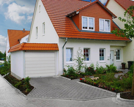

Unfortunately, I don’t have the "façade" at hand right now, but I do have a more affordable alternative (graphic). Ask your building authority whether this alternative is approval-compliant.
