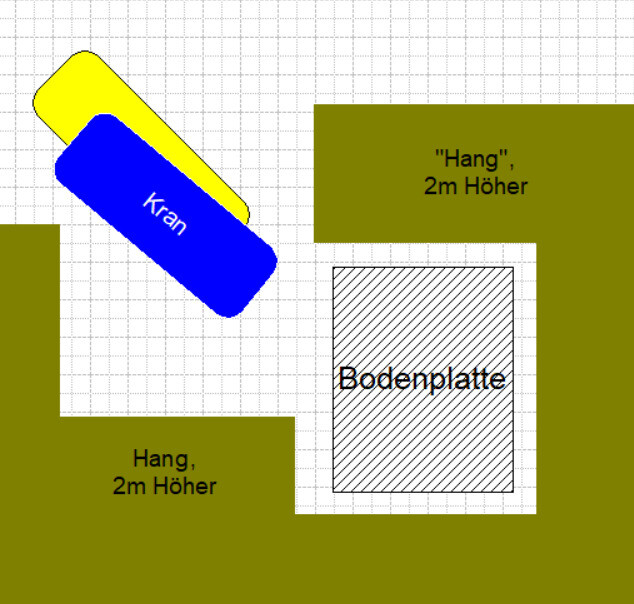

Osnabruecker22 Mar 2023 19:43darksun schrieb:
could have easily driven up to 4 meters (13 feet) to the base slabAccording to which opinion? Load-free strips must be left at the excavation site, especially with such high point loads.

this concerns a mobile crane that arrived for the basement construction and left after two days.
There is no "excavation pit" as such; due to the slope, the side where the mobile crane worked is at the same level as the ground/slab. So, access was possible almost up to the slab level (and not into an "excavation pit"). On three sides around the slab, the ground rises.
Attached is a rough sketch. The slab measures 9 x 11 meters (30 x 36 feet).
Yellow shows where the mobile crane was positioned, blue indicates where it could have been placed as well.
