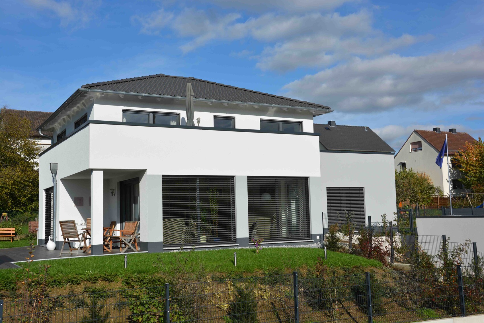

AxelH.3 Apr 2020 16:05
eugensit schrieb:
Or am I overcomplicating this?
Although the question wasn’t directed at me, this was our situation:
Reinforced concrete ceiling for the entire ground floor – included in the price.
Flat roof with tapered insulation and appropriate waterproofing – included in the price.
Parapet capping in anodized aluminum – included in the price.
So, for the calculated house price, only the additional rows of masonry had to be added. This had about the same negligible impact on the overall house price as plastering the extra brick rows.
Additional costs arose only from the protective mat placed between the waterproofing and the roof terrace, and from the terrace construction itself using WPC decking.
Axel
