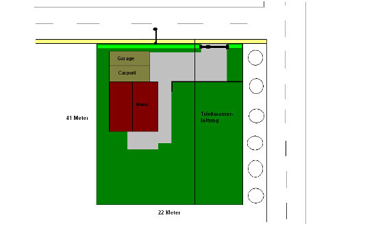

yesterday I received the cost estimate for our newly planned residential house. The plan is for a single-family home near Cottbus (in eastern Brandenburg) in a designated development area, 1.5 stories, with a gable roof and a knee wall of about 1.20 meters (4 feet), 140 sqm (1,507 sqft) including the following rooms:
1st floor: hallway, guest toilet, utility room, open living and dining area
2nd floor: hallway, bathroom, 2 children's bedrooms, master bedroom
In addition, a garage and a carport are planned. I roughly sketched it out with Paint:
