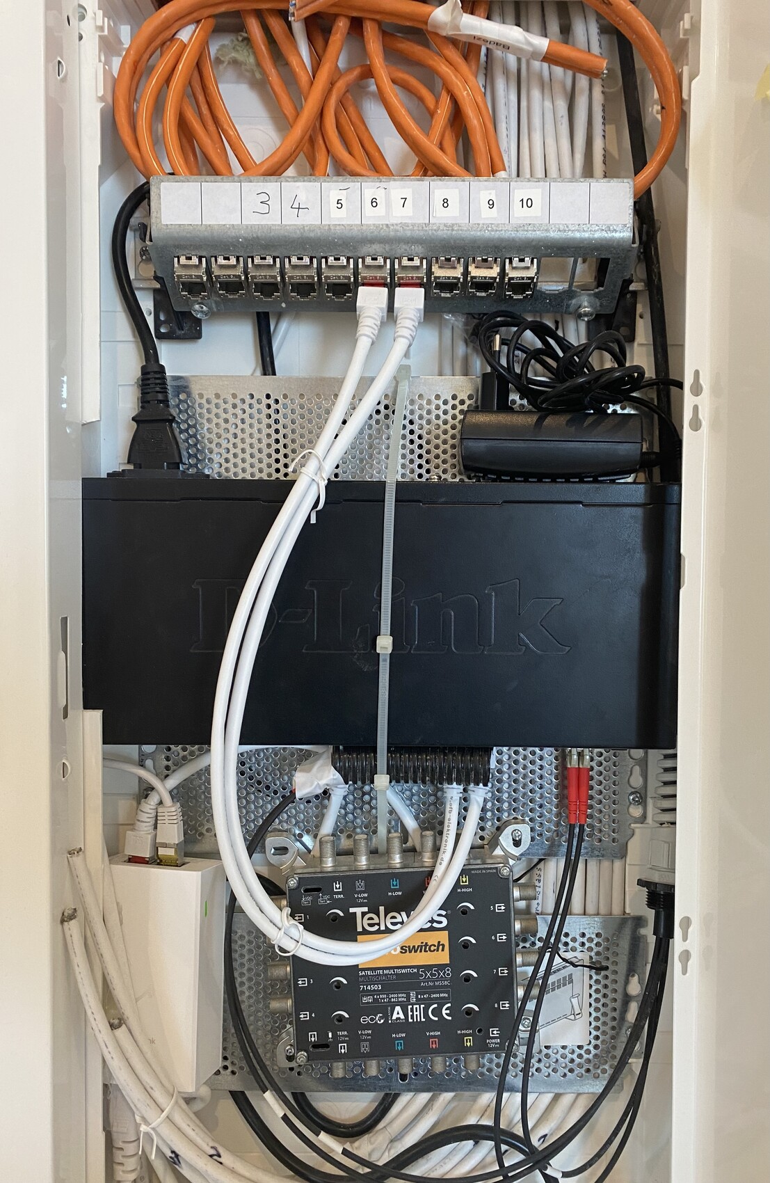

What I still don’t understand... what exactly is a media distributor?It’s a separate box, similar to the electrical panel. Otherwise, our modem would have just been mounted directly on the wall (which wouldn’t be a problem in the utility room), but instead, it is inside this media distribution cabinet, where all the LAN connections are routed from. We have a LAN outlet in the hallway and one in the living room. That way, we can connect our TV or an additional Wi-Fi extender.
Maybe try negotiating with the contractors as well. We told the drywallers that we already had another offer. Lo and behold, we got a better deal for taping and sanding.
In case anyone wants to see what a "media distribution cabinet" is.
This one is located on our upper floor and serves only that floor.
Orange – LAN cables (duplex) from individual rooms to the patch panel
White (currently only two active) – LAN cables that provide internet from the switch (D-Link) to the respective outlets
Televes – multiswitch, in case we want to use more than 4 TVs or activate all satellite outlets (currently only one TV in use)
White box on the left – power supply for an access point (Wi-Fi “router” for the upper floor), since the switch installed here does not support PoE
Two red connectors on the switch – fiber optic cables carrying internet from the network cabinet on the ground floor to the switch on the upper floor (plus two spare lines reserved)
Material cost for this cabinet with contents is approximately 300–400€.
…where the current approach seems to be “better to have and not need than to need and not have.” For example, only two of the possible 16 LAN ports on the upper floor are in use.
I should also mention that the electrician only installed the LAN cables; patching and connecting can be done by hand using standard tools for under 50€.

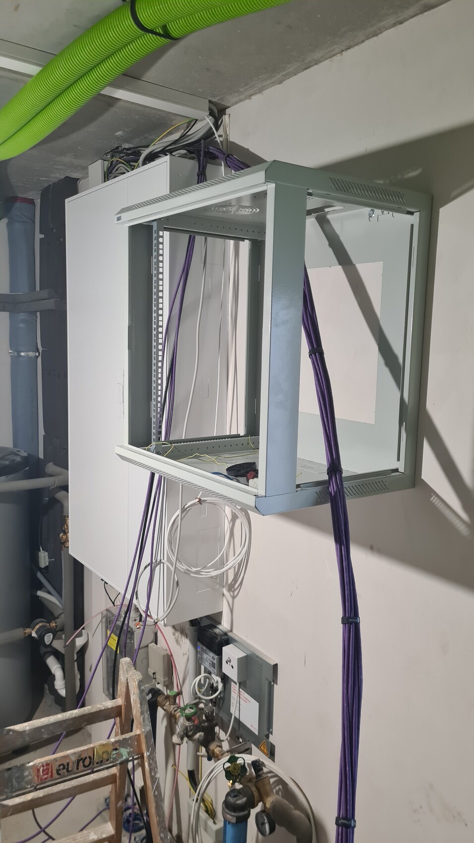

Our electrician also wanted to charge double the price for the "double" network outlet. So I decided to have only single outlets installed everywhere – plus roof overhangs at the corners of the house. There is no telephone or satellite/antenna cable throughout the entire house. I preferred to invest in network cables instead (these were lump sums with the general contractor).
The electrician installed the outlets flush with the wall – I did the rest myself. I had to redo about 50% of the outlets anyway (installed incorrectly or loosely).
The electrician would have probably charged me around 2,000 euros for a 10-inch (25 cm) cabinet and patch panel… Of course, they need to make a living too – but the prices being asked here were really unreasonable…

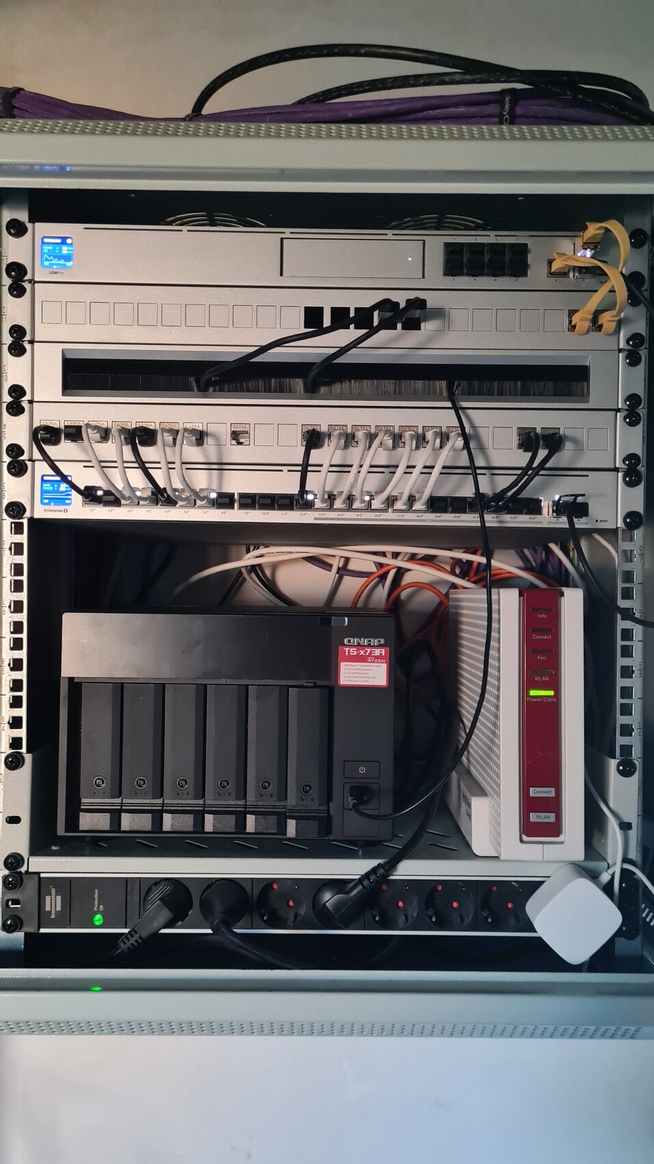

This is the cable connection – but only for internet access. The "cable" goes from the back into the Fritzbox in the server cabinet. Recently, fiber optic has been added as well, but only a small contract as a backup. There was an offer recently to have fiber optic installed and to get the connection into the house for "free" – I prefer to pay 24 times 20 euros rather than 1,500 euros later just to have fiber installed.
