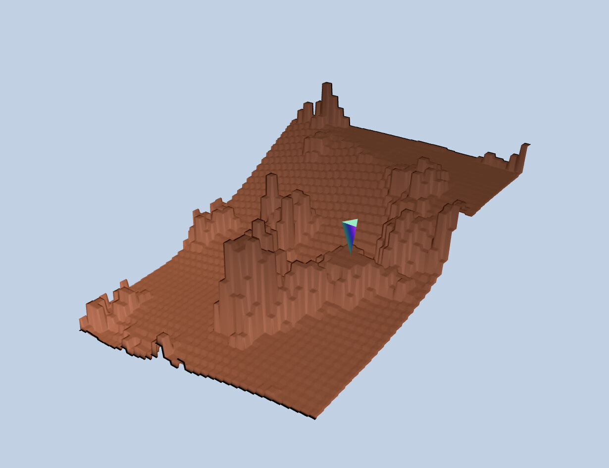

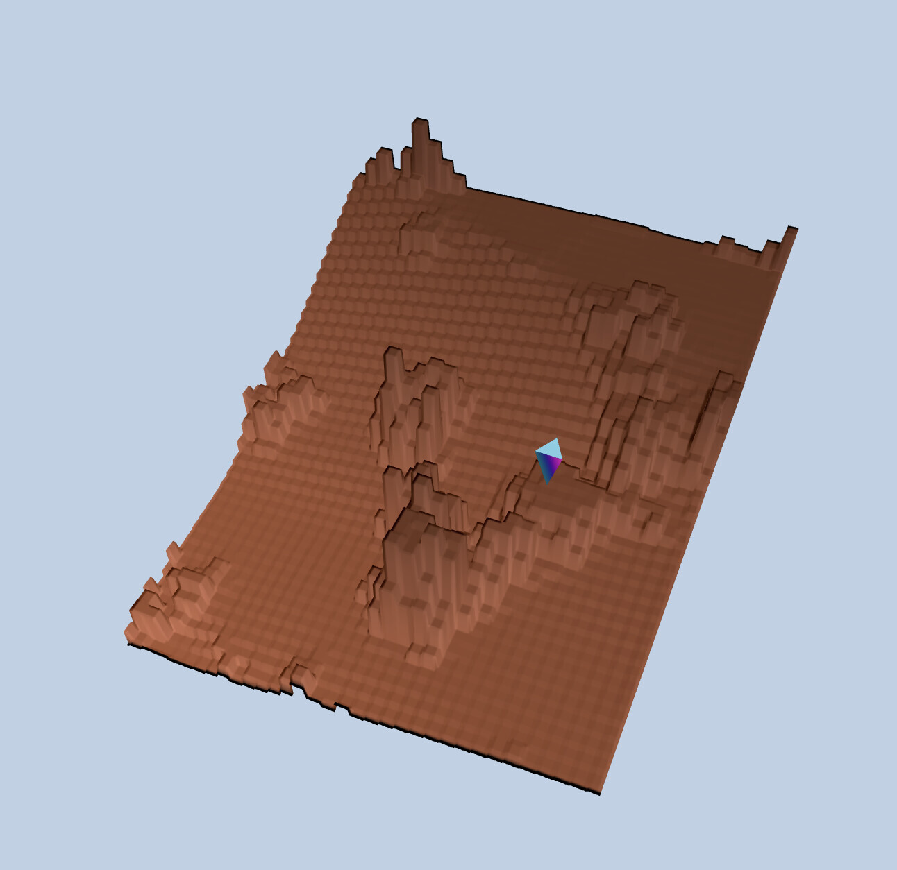

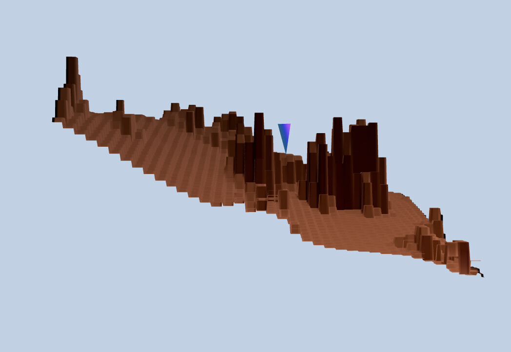

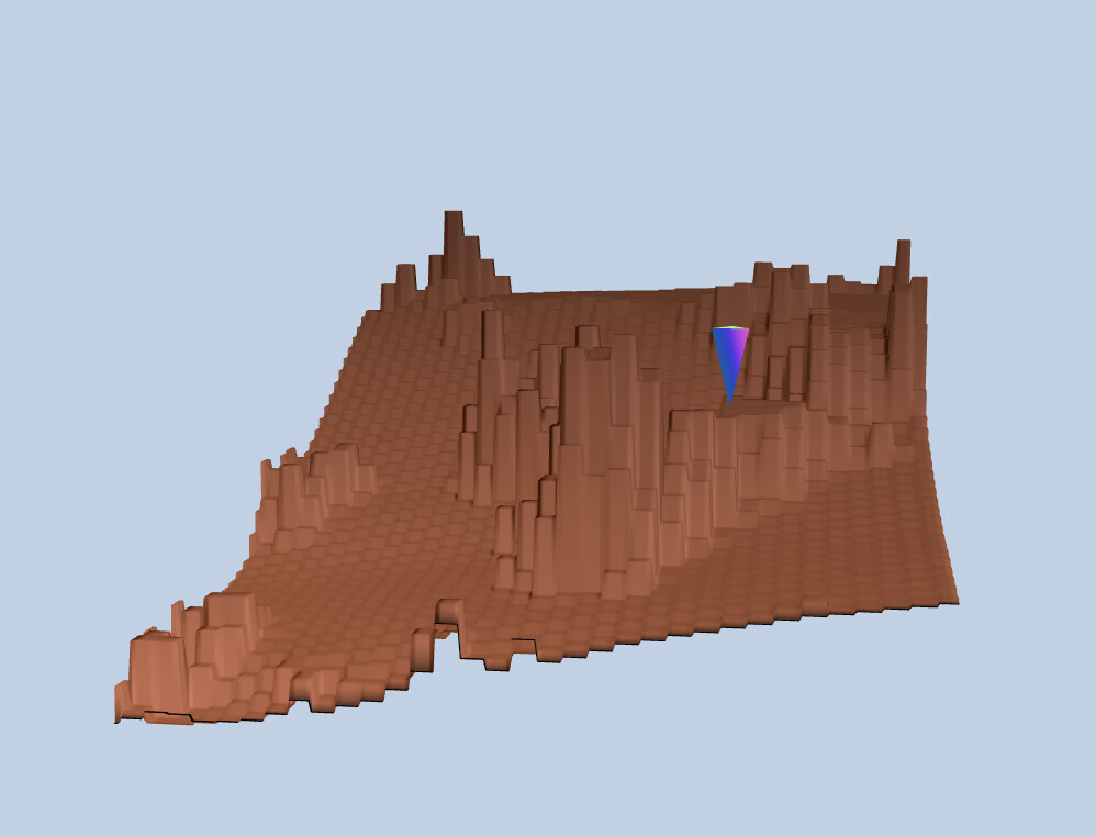

Is the plot accessed from the top or from the bottom?From the southeast, so from the bottom.
More pictures....
The marker should be the cabin, the rest I believe are trees... unfortunately, I can’t remove them.

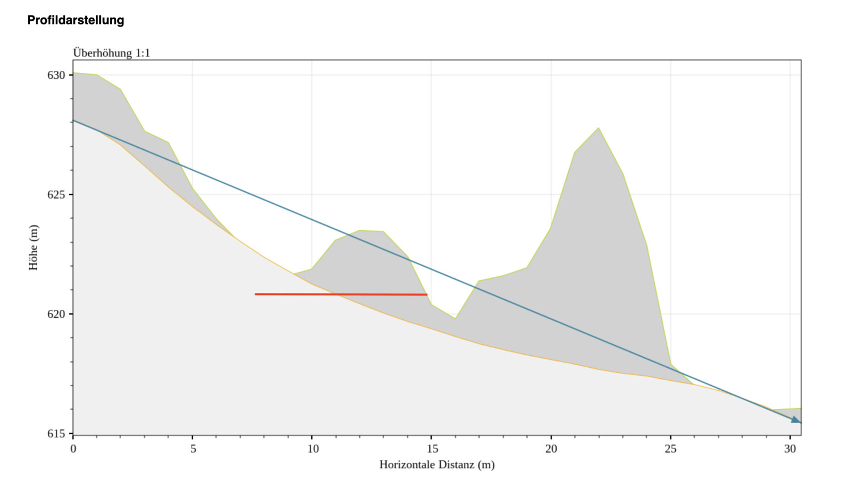

IIIIIIIIIIIIII4 Jan 2024 12:09xMisterDx schrieb:
I think your 100,000 EUR for land grading would be a better down payment here... How much do you think something like that would cost?
Here’s another profile of about the "western edge of the cabin."
Then you will have to set the house lower than where the cabin is located. The driveway and stairs will be costly, become steep, and need to be cleared and salted during winter. There are nicer things than coming home after a day's work and not being able to get into the garage because the driveway resembles a ski slope.
Additionally, the utility connections. Even in Austria, every meter of pipe or cable that needs to be laid will cost money.
IIIIIIIIIIIIII schrieb:
My current idea is to have only the wall directly against the slope in the ground floor made of concrete, and to build the rest from timber. (No idea if that is structurally possible.) You’re forgetting that it’s not just the back facing the slope, but roughly half of the sides will also be embedded into the slope. The slope will continue to run along the left and right sides of the house as well.
Structurally, many things are possible. But combining different types of exterior walls in the same story is bad construction practice.
