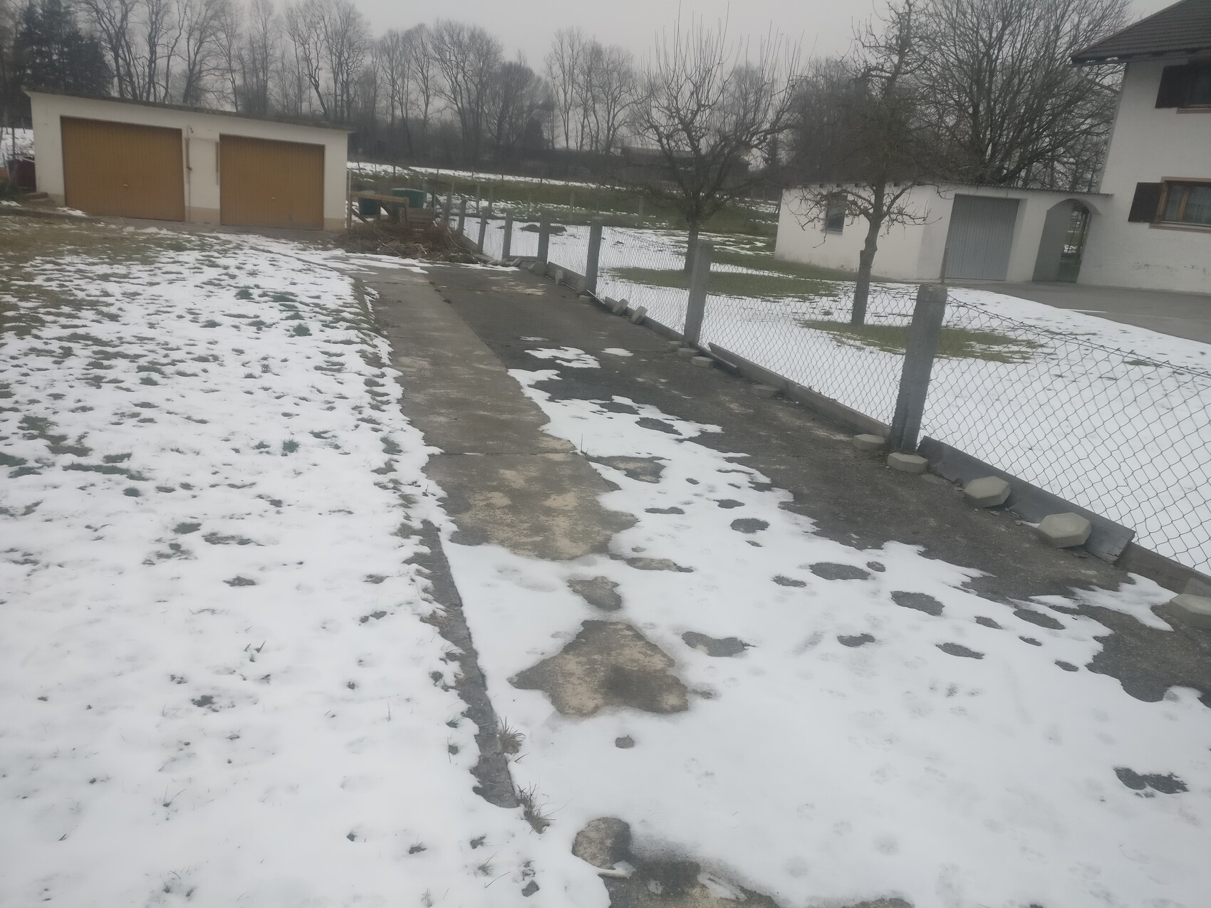

Now I’m wondering which option makes more sense:
I hope the situation is clear from the picture below 🙂
- demolishing the concrete driveway together with the old garage (probably cheaper?), but then trucks, cranes, etc. would have to operate on bare soil, or
- first demolishing only the garage and only after the house is completed removing and repaving the concrete driveway? (that’s what my husband prefers)
Oops... I think I forgot to mention an important point: the garage will be demolished before construction begins. The new house will be built in its place and beyond.
The question is whether the concrete driveway should also be removed during the demolition, so everything is done at once, or only after the house is completed, to prevent the crane and trucks from getting stuck in the mud.
So you also think the concrete slabs should stay until the house is finished? 🙂
haydee schrieb:
If the crane can and should be placed there (dismantling still possible once the house is standing), leave them in place. Otherwise, the slabs will be removed and gravel will be added afterward.
