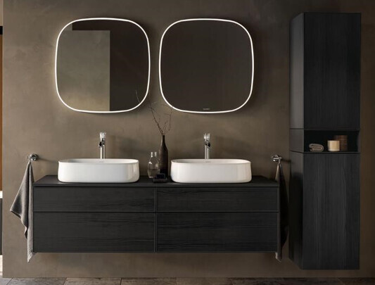

I'm looking for pictures like these on the internet. You should try doing that too.
Although I wouldn't think of searching for Villeroy & Boch.Oh, we’ve already done that as well and have a rough idea of how it should look:Just in terms of style... colors, etc., don’t quite match. Mainly, we’re interested in personal user experiences here 🙂.
@kati1337 As far as I understand, you can easily use a vanity cabinet for vessel sinks under a wall-mounted sink. The difference is that the sinks are additionally fixed to the wall and not just resting on the cabinet. The Collaro series from VuB, for example.

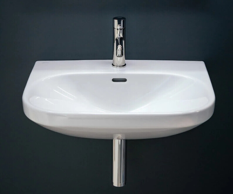

Oh, right – that really depends on the sink. Most wall-mounted sinks included as standard by construction companies are not very modern in design and usually have a curved bottom rather than a flat one.
They often look like this or something similar:
Of course, a vanity cabinet can fit underneath, but I think it looks less elegant. Also, you need to be careful about the clearances. Instead of a regular siphon, you would need a space-saving trap or furniture trap, and the sinks must be mounted on the wall with specific distances so they fit into the cutouts of the countertop or vanity.
