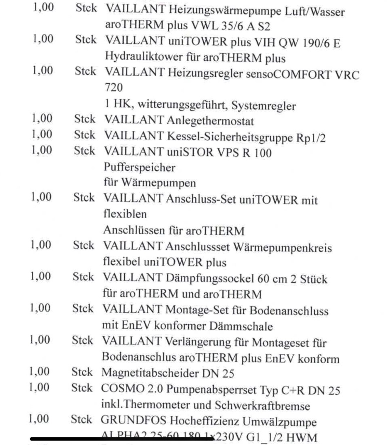

I actually had to choose the 75 size instead of the 55 only because of the pump capacity. Thanks for the tip, I will ask about that. I will receive the design analysis next week; I assume they also used the Vaillant tool for that.
Here are the parts of the offer—maybe something useful can be found there.
