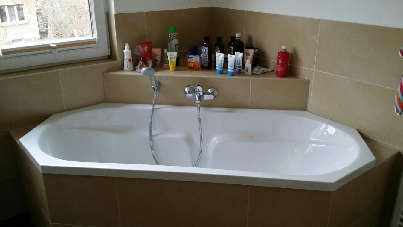

So, we had a corner bathtub installed... and we would definitely do it again...
It simply offers more space inside... we have a 300L (79 gallons) water heater, so there is no issue with water supply... since we can only use the bathtub about once a week due to time constraints, the water consumption remains reasonable...
The manufacturer is a company that has existed since the East German era, and the model has been offered for decades, so I don’t foresee any problems with replacements...
