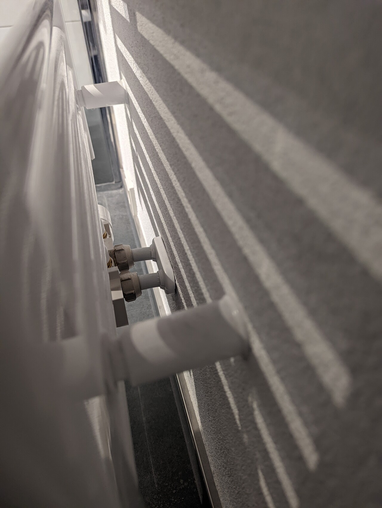

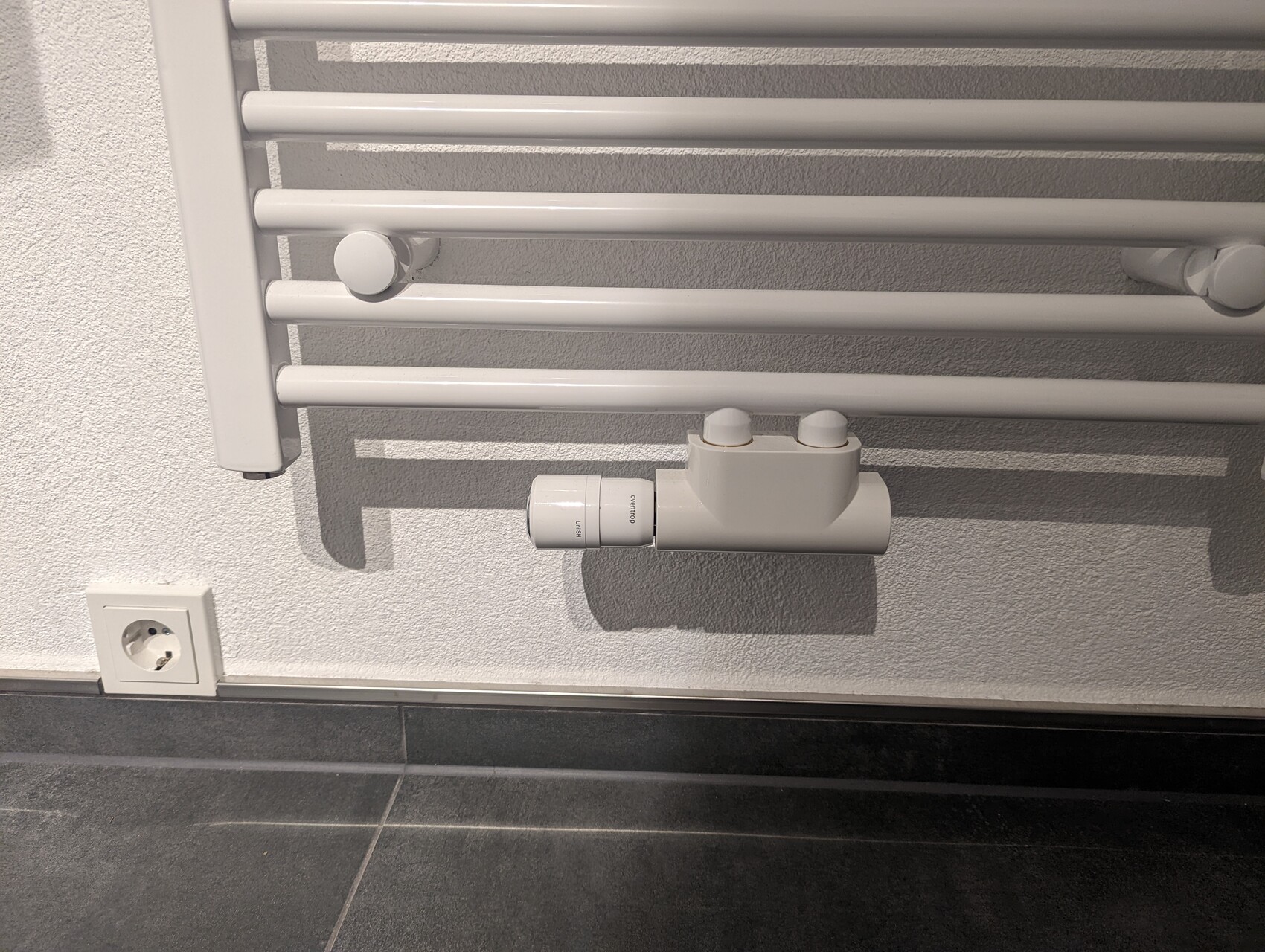

@Pamiko ... unfortunately, the glass balls are currently out of stock 😉 😉 .. you can’t really say anything about the type of your radiator yourself, so it would be helpful if you could take a photo of the connection situation of your radiator. Then someone here will surely be able to give you more useful advice.
You definitely need fittings for the central connection of the towel radiator, or you will need a completely new one.
The pipes coming out of the wall must also be connected together so that a complete loop is formed, as we do not know whether they are arranged in parallel or in series within the bathroom heating circuit.
A towel radiator can also be operated with an additional electric heating element without separating it from the flow and return of the heating circuit.
A timer can then be used to activate the electric element at the desired times.
If you want to separate it specifically because of rusty water, the heating medium must not come into contact with iron anywhere in the entire heating circuit.
This starts with the circulation pump.
