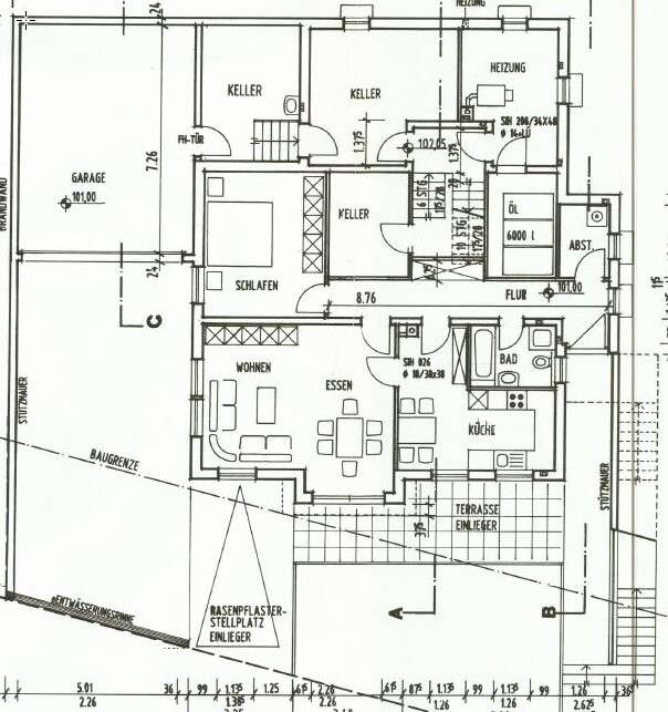

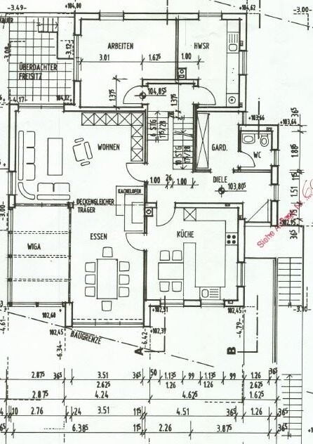

Shortly before retirement, we are facing a familiar problem. The children have left the house, which is now too large in its current form. Our son would like to come back and live in the upper part of the house, if a separate apartment can be arranged somehow. We can’t use the secondary apartment because it is occupied by the grandparents. So, in addition to the secondary apartment, we somehow need two separate apartments. We have thought about it back and forth but can’t really make progress because of the split-level design.

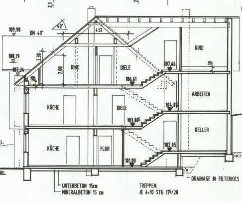

Does an elevator make sense for old age??? If you can’t manage any steps, possibly. However, there are other options. What exactly do you need an elevator for if you want to separate the living spaces? For the five steps to the intermediate level?

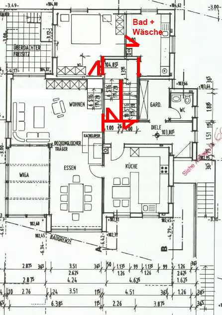

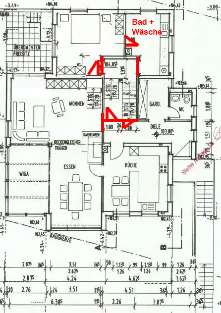

Here is an initial idea, hoping I have read the plans correctly:
The basement apartment remains unchanged.

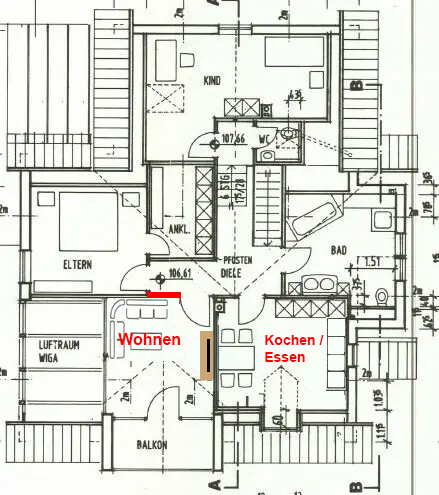

Upper floor: The wardrobe will be shared. The family upstairs can also install a narrow hook board at the height of the stair landing.
I am still not entirely sure about the purpose of the conservatory. Could the home office be located there?
If it is possible to close off the open space and add a ceiling, I would do that. Then the office could be downstairs in the conservatory, and upstairs either the living area could be larger or, even better, a large balcony could be added.
The washing machine would have to be integrated either into the bathroom upstairs or, if necessary, into the kitchen.

Problemchen12 Aug 2024 11:00K a t j a schrieb:
Edit: Sorry, there was a missing wall between the basement stairway and the stairway to the attic apartment.
[ATTACH alt="Eltern.jpg"]87150[/ATTACH] Thank you very much for the quick response. That was actually our approach as well. The conservatory is currently being used as a workspace and music room. A ceiling can be installed there without much difficulty to create a separate apartment on the upper floor.
