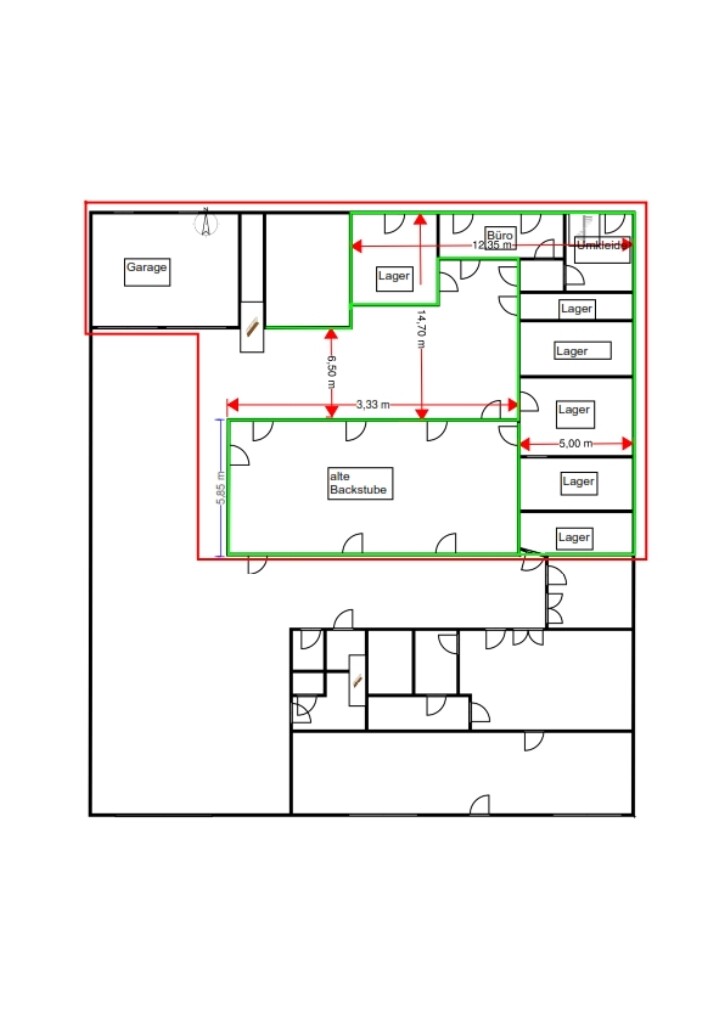

My wife and I plan to purchase a courtyard property where a multi-family house is located at the front and is currently rented out.
We would like to convert the rear area, marked in red, which was formerly used as a bakery with adjoining rooms, into a residential unit (floor plan/sample) and move in there ourselves.
The layout should include 2 children’s bedrooms, 1 master bedroom, a living room with dining area and open kitchen, a guest toilet, and a large bathroom. If there is space for an additional room, we would gladly accept that as well. I have marked all the existing windows on the plan.
The space between the bakery building and the new unit, with a distance of 6.50 m (21 feet 4 inches), is intended to be used as a terrace and should extend to the end of the bakery, where there is vehicle access to the garage.

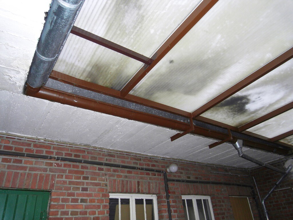

The floor plan is attached again, and the walls highlighted in green are the load-bearing walls.
Maybe you can provide better suggestions this way.
The walls are about 35 cm (14 inches) thick, and the ceilings are made of concrete. I have also attached photos showing the ceiling construction.

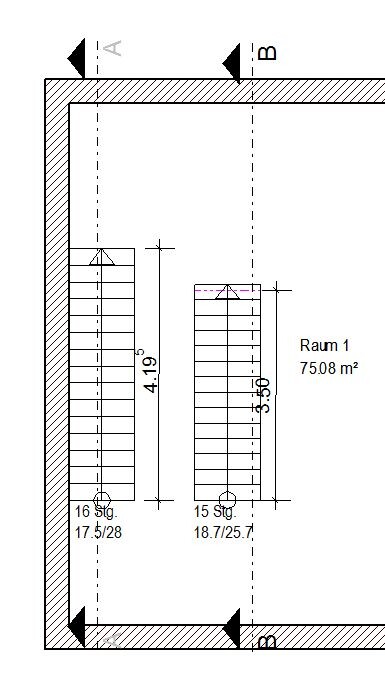

Should the staircase be located at the top right of the floor plan in the room that is only 320 cm (126 inches) wide?
That won’t work. Here are some example space requirements for staircases.

And why are there 3 children's bedrooms again on the ground floor?
Unfortunately, the floor plans are not very clear. Where is the hallway, and where is the main entrance?
