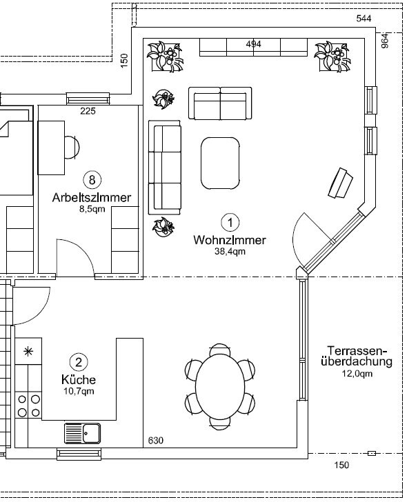

The living/dining area has 38.4 m² (414 sq ft) with an adjacent open kitchen of 10.7 m² (115 sq ft) and a large south-west facing window front with triple glazing (greenhouse effect). See the floor plan as well. Furthermore, the ceiling in the living/dining/kitchen area is full height up to the roof ridge.
