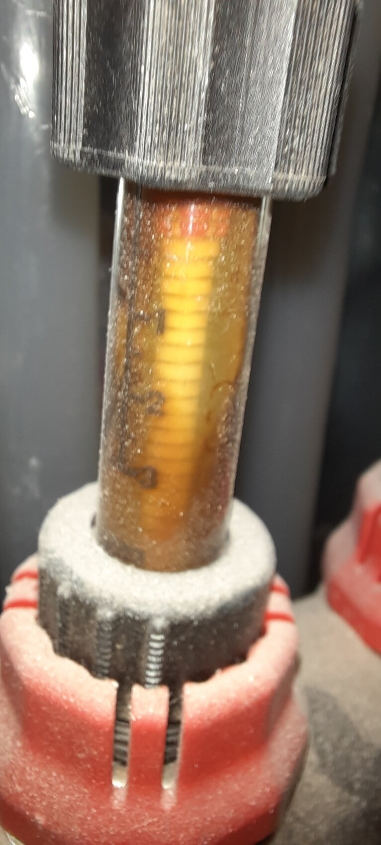

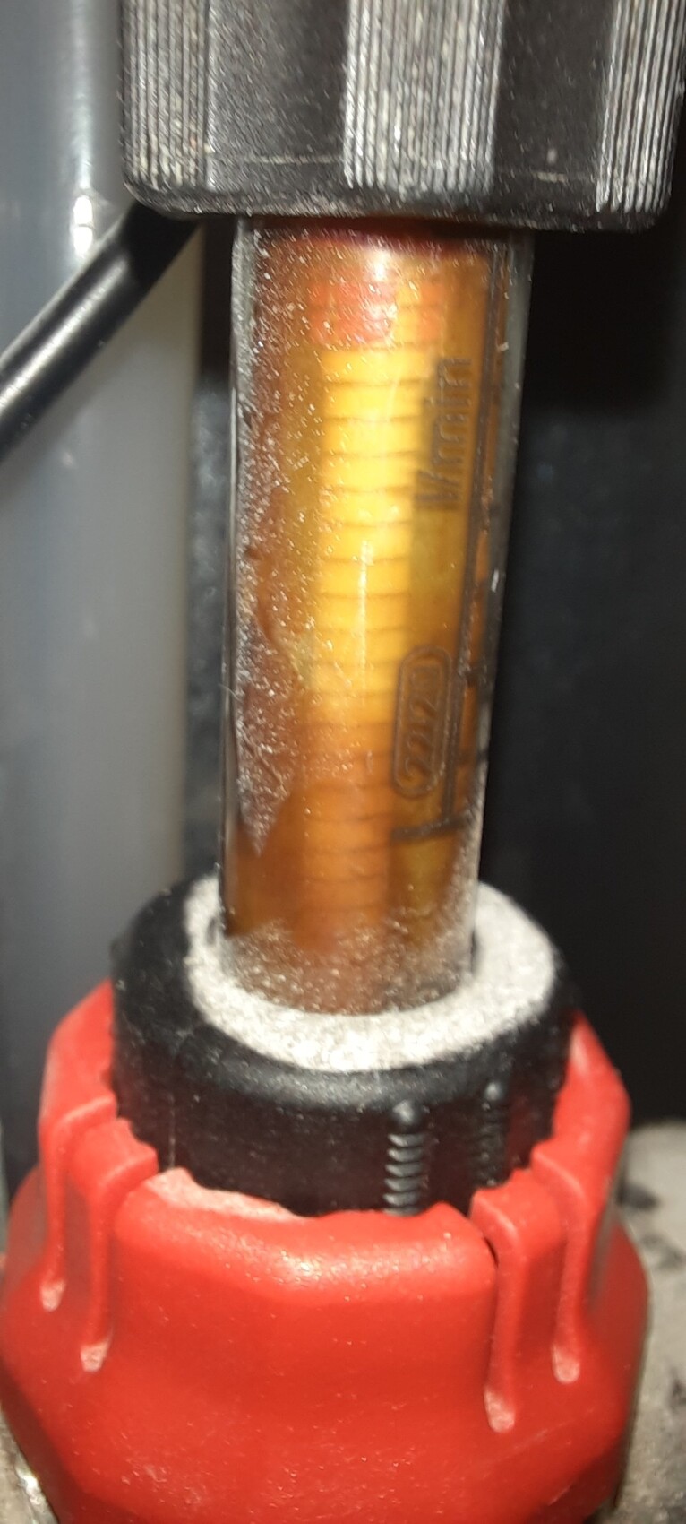

My underfloor heating system has been running for about 6 months now, and I noticed some time ago that the control valves’ actuators are very dirty. It looks like there might be algae or something similar on them.
I don’t think this is normal. But is it common? Could something have gone wrong here?

In my perception, it is disputed whether the system is functionally limited or if it is just an aesthetic issue. Otherwise, the solution would be to empty and flush the system.
Do you have a sludge separator in the system? Flush it!
Mycraft9 Jun 2021 07:13
There is still a warranty, and you could have the system builder at least perform the flushing and refilling with deionized water.
If necessary, you could also have a sludge separator installed (if not already present) and replace components made of plain steel with ones made of precious metals or stainless steel.
