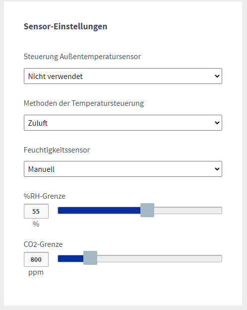

Sensor settings: outdoor temp off, supply air, manual humidity sensor, RH 55%, CO2 800 ppm
For the sensor settings, I lowered the relative humidity (%RH) limit to 55% and set the sensor to “manual.” Only when set to “manual” can I adjust the threshold. If I set it to 55% and then switch it back to “automatic” above, the RH limit resets to a much higher value.
So I assume manual is correct? But I would still like the ventilation to automatically reduce humidity during operation if the measured value exceeds the threshold.

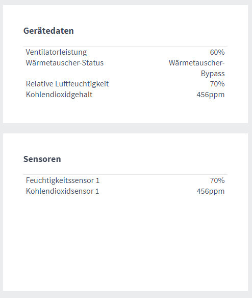

UI view with two cards: device data (fan 60%, humidity 70%) and sensors (humidity 70%)

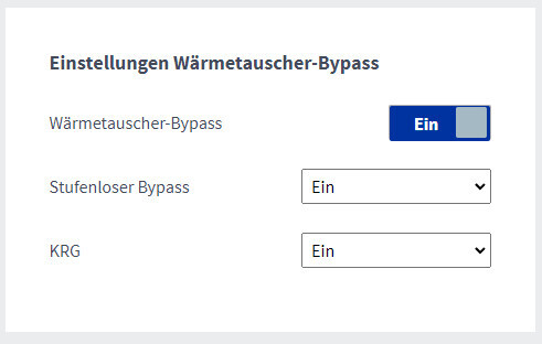

Currently, the humidity is at 70%, which is much too high for me. Also, in the device data, you can see the heat exchanger is set to the heat exchanger bypass. I assume that’s not useful since we are heating now. Should I therefore switch the bypass slider to “off” in the “special settings” menu until next summer?
Screen showing heat exchanger bypass settings with on-off switch and bypass options

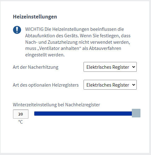

There are also these “heating settings”:
UI of heating settings: two dropdowns, 20 °C and blue slider
They are set to the values configured after commissioning. Is this reasonable? I have no idea what these are for. Our previous ventilation system was part of a combined unit with an air-to-water heat pump, so I don’t think it had anything like this.

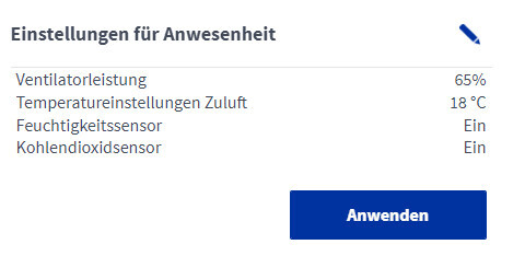

And lastly, these profiles you can switch between:
Smart home settings with presence, fan power, and sensors
All profiles have the supply air temperature set to 18°C (64°F). I read somewhere that it might make energetic sense to heat the rest via underfloor heating. However, I don’t want to lower it any further because I don’t want to risk a draft overnight if cold air blows into the room over the bed.
The basic fan settings are currently 50% for both exhaust and supply air – I neither know if that makes sense nor if these settings are applied anywhere. Because in the “present” profile, it is set to 65%. Which value is active then, or when is the basic setting ever used?

@kati1337 Do you mean the preheater coil? Does your mechanical ventilation system simply shut off when it freezes? Last winter, our preheater coil caused about 30 kWh of extra electricity consumption during frost periods. I found that quite acceptable.

I’m not sure about the preheating coil—on our system, the settings say heating coil / reheating. However, the plumber said we don’t have one.
