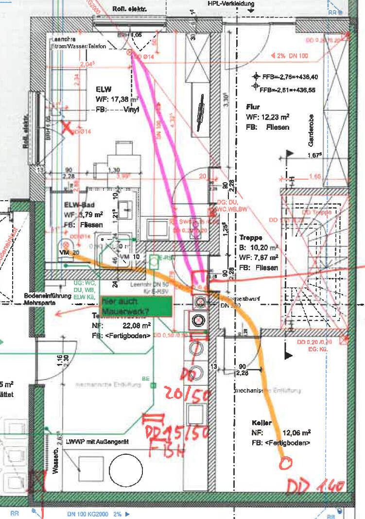

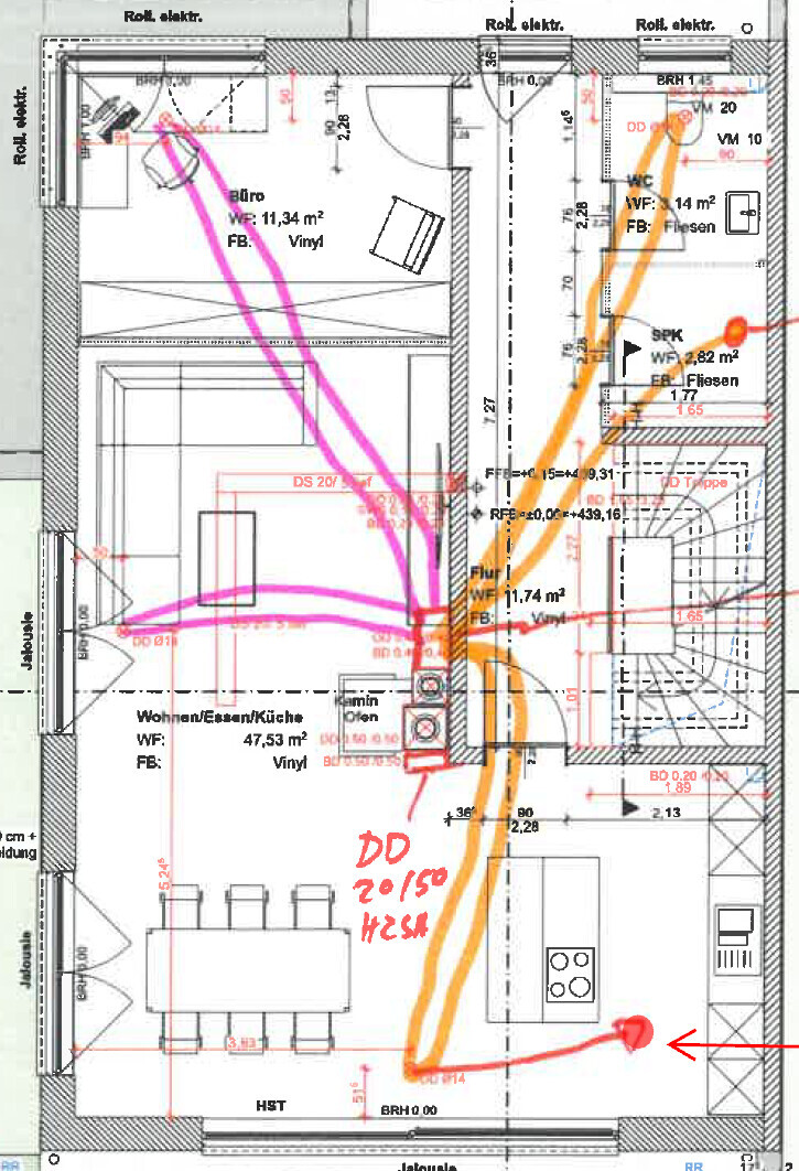

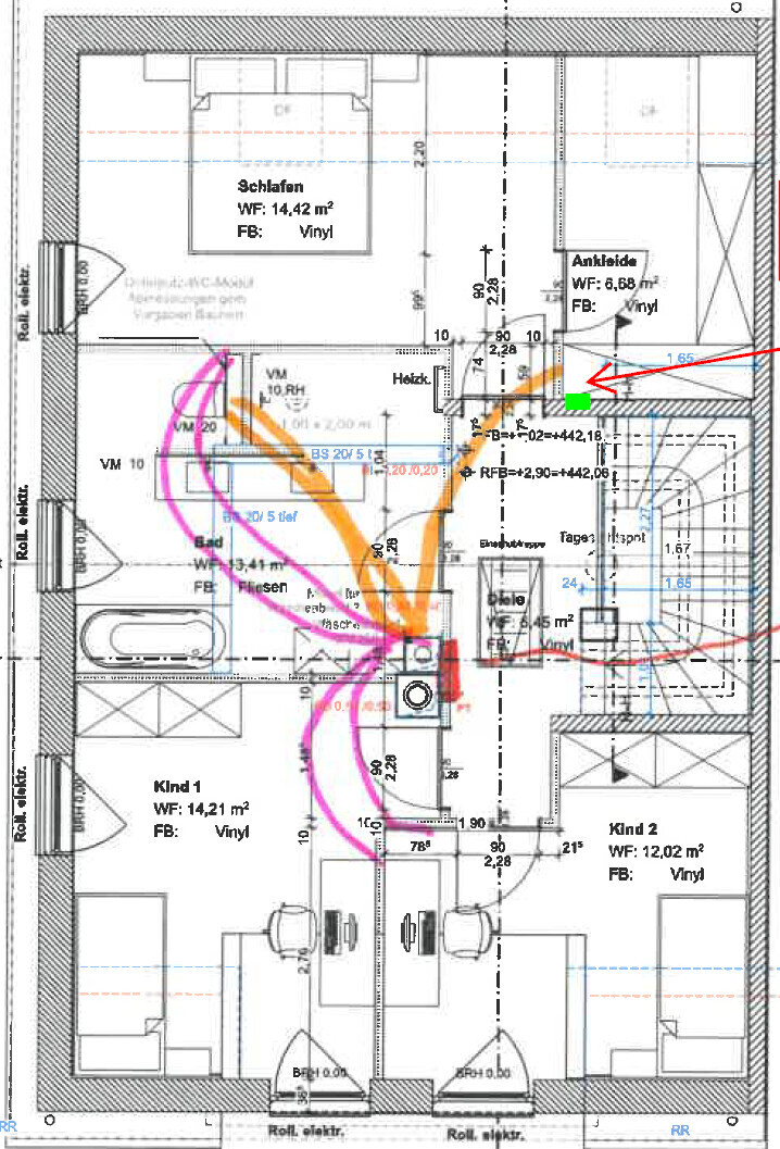

Since this is generally about the question of positioning, I would like to use your thread to ask for opinions regarding our current planning. I hope that’s okay? We are planning a mechanical ventilation system with heat recovery and today received the hand-drawn sketches from the plumbing company.
To my knowledge, orange indicates exhaust air
Purple indicates supply air
From the plan, as a layperson, the following questions arise for me:
Basement: looks plausible to me at first, and I assume the air from the granny flat will flow through the hallway into the basement
Ground floor office: I wonder if the position of the supply air above the seating area is well chosen? Wouldn’t you feel a constant draft there? Would it make more sense to place it in the bottom left corner?
Ground floor living room: is the distance to the sofa sufficient, or would there be a noticeable draft? If so, where would be a better position?
Upper floor dressing room: I don’t yet understand where the exhaust air is supposed to go since there is a closet right there. But I assume the planner knows what they are doing
Upper floor Child1/Child2: I once read that the supply air should not be too close to the door to ensure proper air mixing in the room. Would this be achieved here?
If you need any more information, please let me know. Although I currently don’t have much more info myself.
Thank you for your support!
