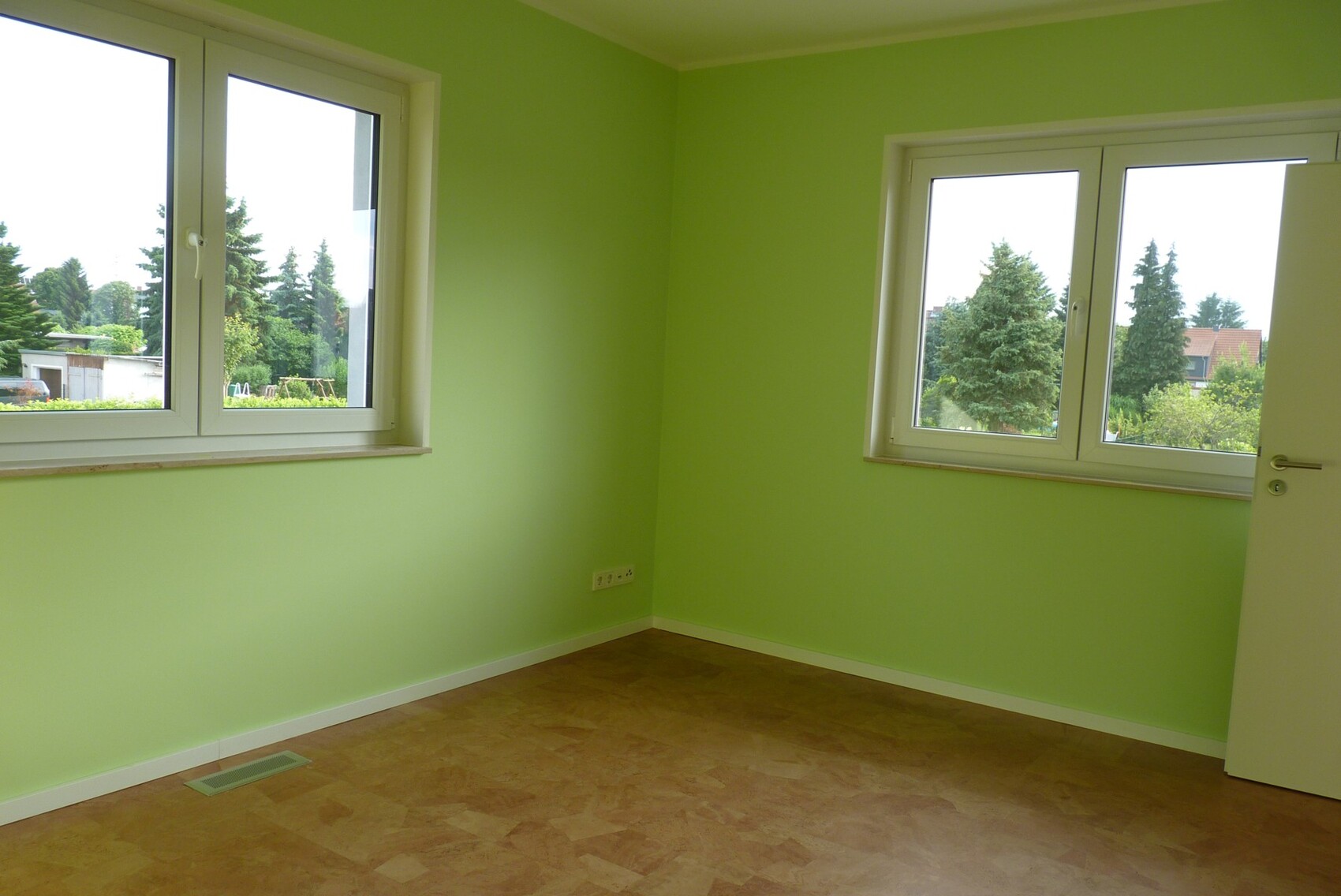

Bieber081520 Apr 2017 07:50Floor air vents are common and work well. We have them too. The gentle airflow is enough to prevent dirt from accumulating (meaning the vent grilles are always slightly cleaner than the surrounding floor). Otherwise, I assume that vacuuming is done occasionally.
Exactly, it works… Dirt, dust, pet hair, etc., cannot accumulate there because of the constant airflow… we are not here to convince you… we are simply sharing our experiences and observations.
The video only demonstrates the physical principle. Of course, the effect at the controlled ventilation outlet is less and not strong enough to levitate a tennis ball, but it is sufficient to keep common household dust and similar particles away.

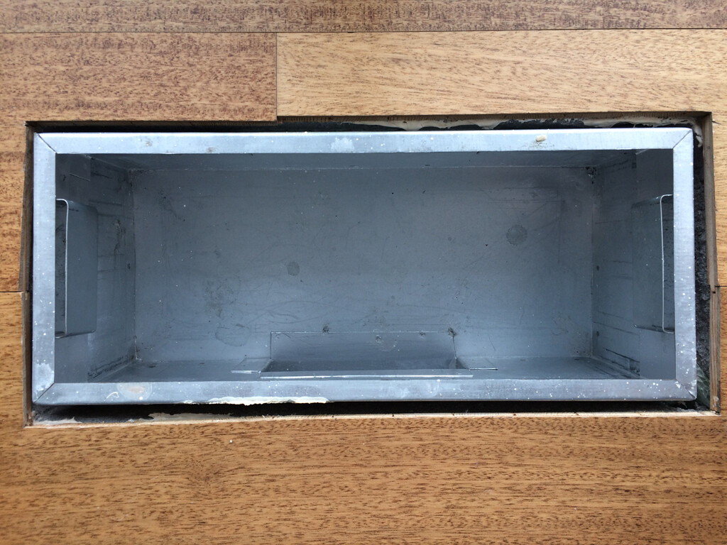

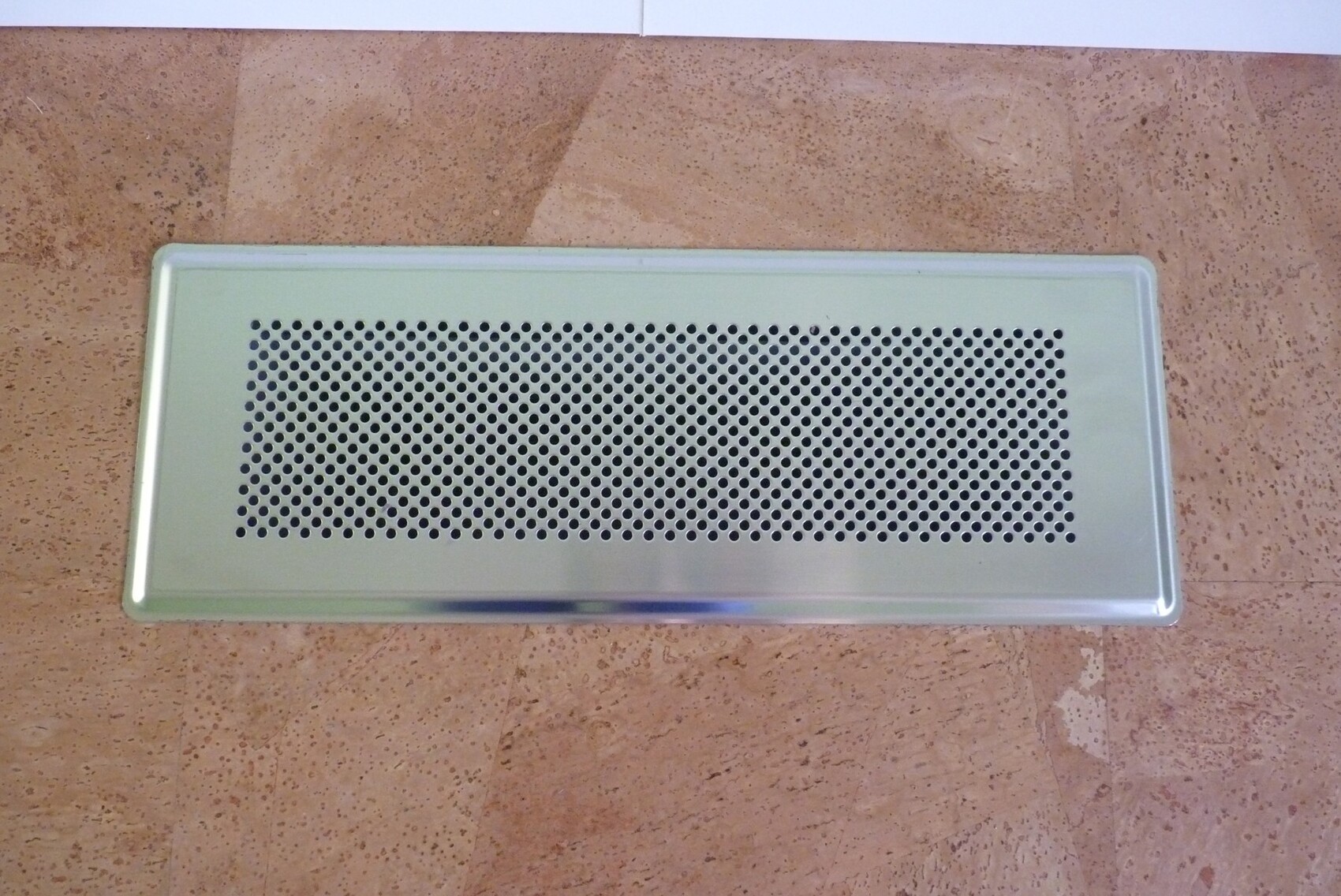

Here are two pictures showing the condition after 6 years of continuous operation. They were not specially cleaned but only vacuumed and wiped damp regularly. Sorry for the quality; they were quickly taken with a phone. One without and one with the grille.
By the way, we have two indoor cats, so there is definitely no shortage of loose hair.
The appearance should not be an issue, as floor drains come in a wide variety of options (size, shape, color). If you don't like ours, that's fine... it’s really just about having the option. In my opinion, a floor drain on the upper floor is the simplest and most cost-effective solution for everyone... meaning there are plenty of other areas in house construction where money can be spent or lost.
