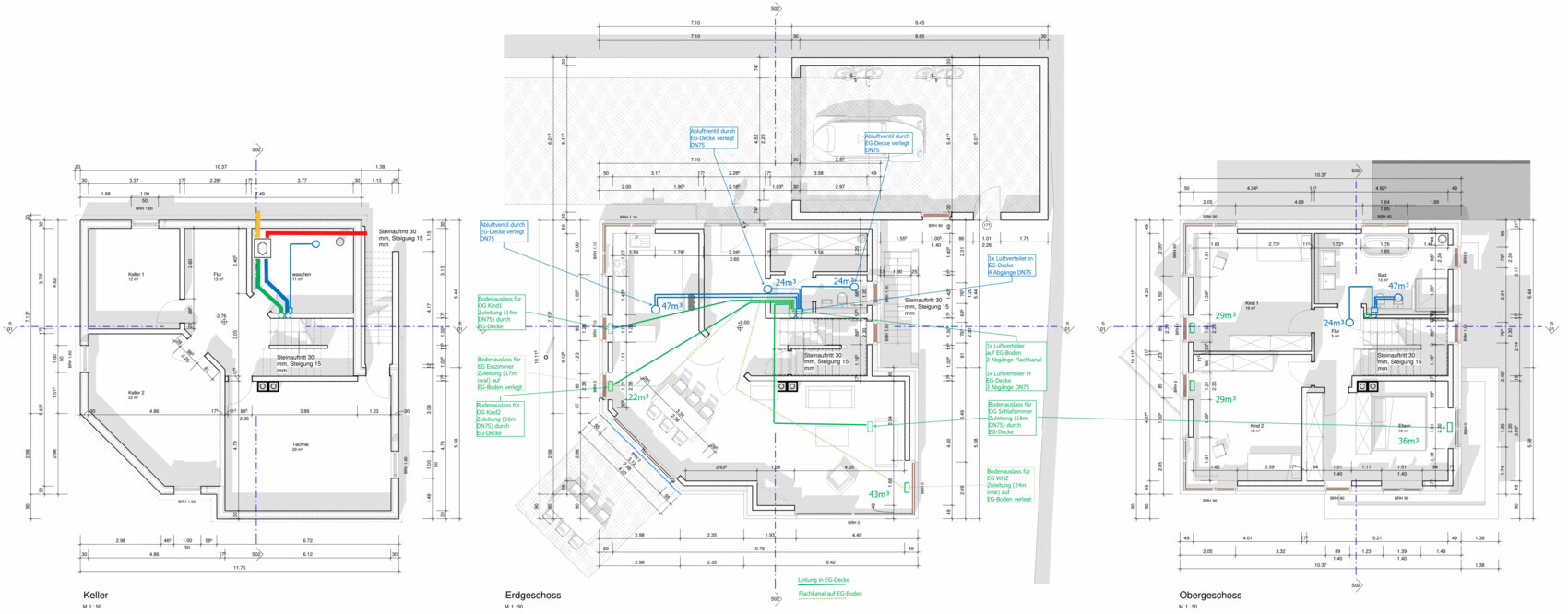

Another topic: duct routing and distribution. (Should I start a new thread for this?)
Supply air on the ground floor (DINING and LIVING ROOM) is routed on the basement ceiling / under the screed. -> floor outlet.
Supply air on the upper floor (CHILD 1 & 2 and bedroom) is routed in the ground floor ceiling / on a precast concrete slab -> floor outlet.
// There is also a floor outlet planned in the attic (not visible in the plan excerpt).
Can I pass this on to my structural engineer like this?

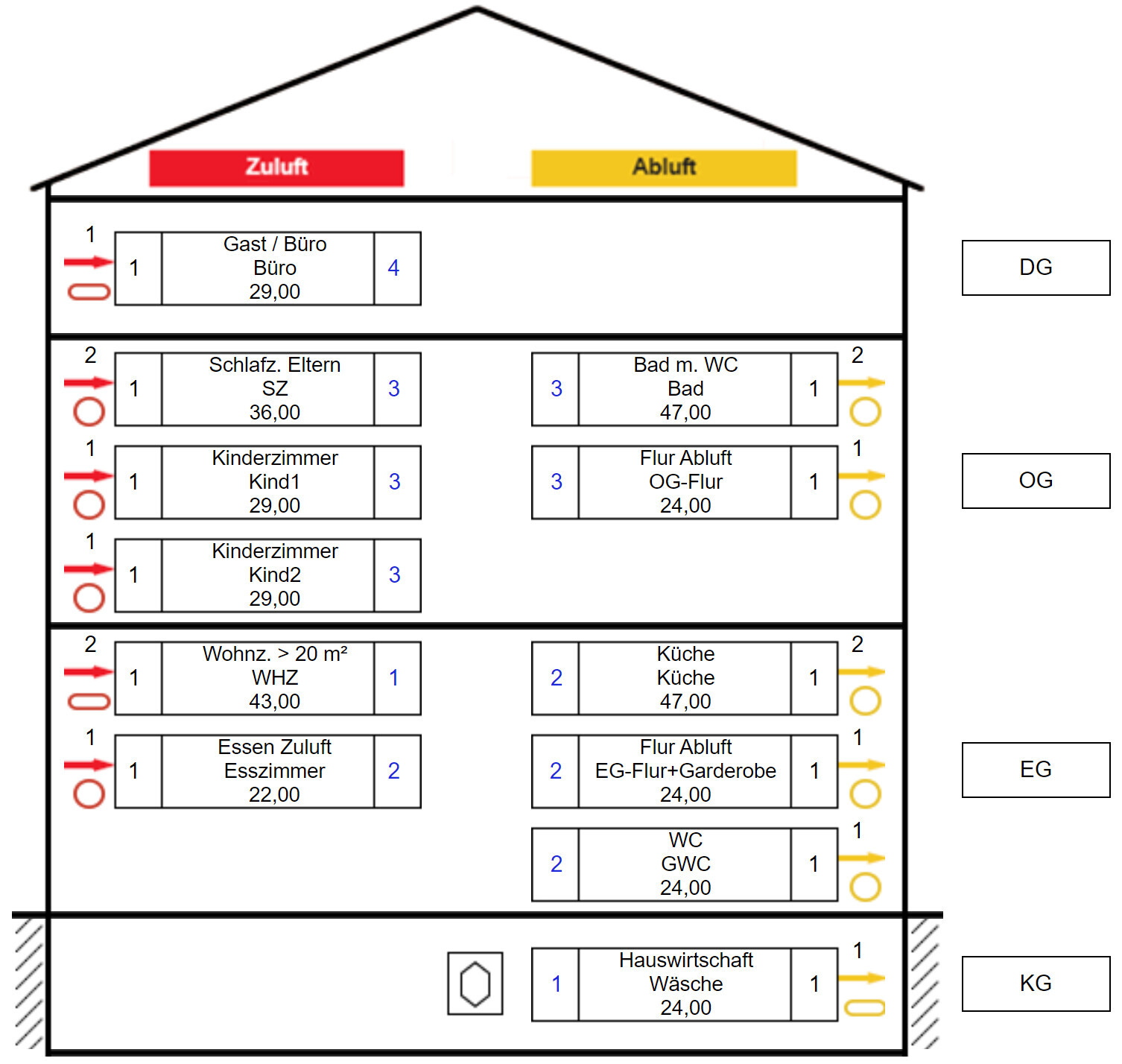

Is 47 m³/h (28 CFM) at one valve (kitchen) okay? Or should this be split to two valves?
In hallways, no exhaust ventilation is needed because these are overflow areas. If you do plan to include exhaust vents, the current setup is sufficient, and you won’t need to install an additional vent in the kitchen. However, the planned vents will need to be slightly larger or adjusted to match the required airflow volume. But that is already understood.
In the basement, there is no supply air planned, even though exhaust ventilation is planned there.
Mycraft schrieb:
In hallways, exhaust air is not necessary because these are overflow areas. If you still plan to include them, the current setup is sufficient, and you do not need to install an additional vent in the kitchen. However, the planned ventilation needs to be slightly larger or adjusted to deliver the appropriate airflow. But that is obvious anyway.
In the basement, there is no supply air, even though you have planned exhaust air there.Can someone show me pictures of the supply and exhaust air ducts in the floor? It looks kind of strange (I recently saw it on Instagram from a homeowner). Are there different coverings or sizes depending on the manufacturer, similar to air-to-water heat pumps?
