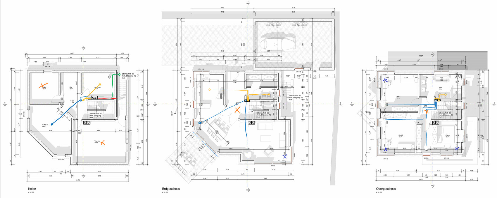

The position of the valves in your setup does not work at all; I would arrange it like this instead. There are planning tools available for this, for example from Zehnder.
Architekturplan mit drei Grundrissen: Keller, Erdgeschoss, Obergeschoss, Maßlinien und Symbole.

Talk to a planner who is experienced in this area and make sure that the pipe lengths are suitable.
Be careful that too much air does not flow through a valve or a pipe.
A slower airflow is usually also a quieter airflow.

Both proposals for the valves are still less than ideal. It’s best to have a professional handle it—they do this daily, and usually the planning is free, as already mentioned. Not only with Zehnder.
