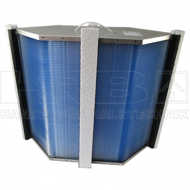

Mycraft15 Feb 2018 08:42
Simple crossflow heat exchangers are usually not made from a single sheet of metal either.
Basic plate heat exchanger:
Large blue cylindrical container with ribbed surface in metal frame and protective padding.

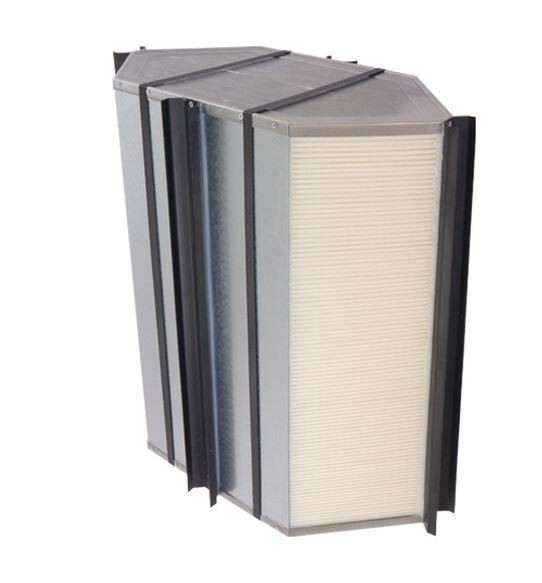

The same one as an enthalpy heat exchanger:
Multi-part rectangular air filter with folded filter media and metal frame.
