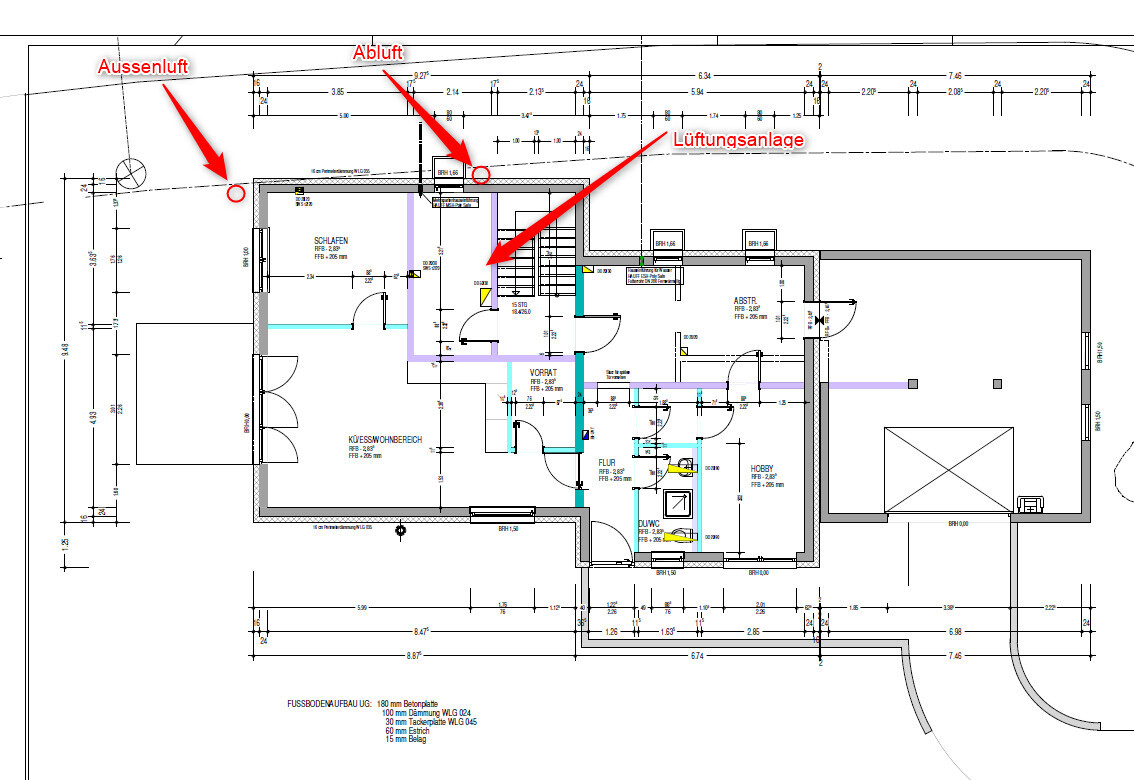

Thank you for the tips. I’ve attached a plan showing how I would proceed based on the input here.
I’m still considering the intake box—it’s actually not a bad idea.
A quick note about duct routing:
Inside the house, it’s clear—I’m using the insulated duct (MT-R160) from Maico.
For the underground section to the outside air, I would use PVC drainage pipe, with a slope leading toward the utility room.
I don’t necessarily want a geothermal heat exchanger; if anything, I would prefer a brine ground heat exchanger.
Right now, I’m considering installing about 120 meters (390 feet) of brine piping around the house in the utility room. It’s not particularly expensive, and it would prepare me for all scenarios.
