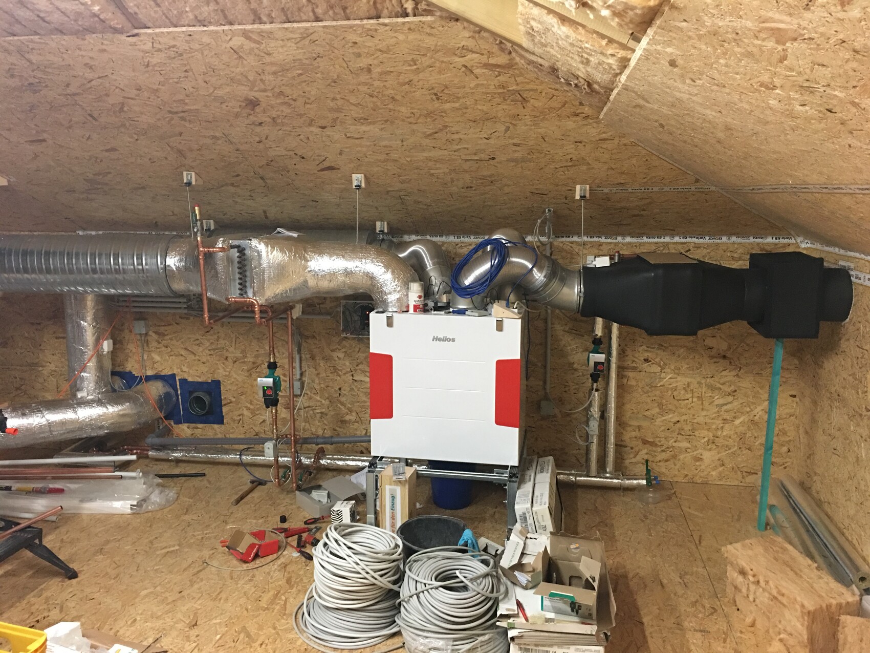

I would set it up like this: [outdoor air -> G2 or M5 at the mechanical ventilation intake -> mechanical ventilation unit -> F7 filter inside the ventilation at the supply air outlet -> activated carbon filter box].
That’s how I did it back then (roughly), my box on the right side is my G2 filter box; in your case, it should be on the left with the activated carbon filter.

Nixwill224 Nov 2022 19:20
Oh, you wouldn’t actually connect the box to the outside air but rather to the supply air! Is that correct?
So like this:
Outside air – M5 filter (in the mechanical ventilation system) – F7 filter (in the mechanical ventilation system) – activated carbon (in the box) – supply air into the ducts
Which brings up the question of insulation and the metal box again: would it even need to be insulated? It would basically only be exposed to the temperature of the air going into the ventilation ducts, right?
