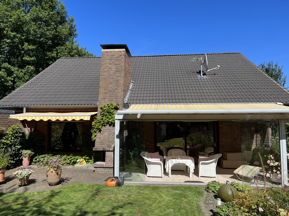

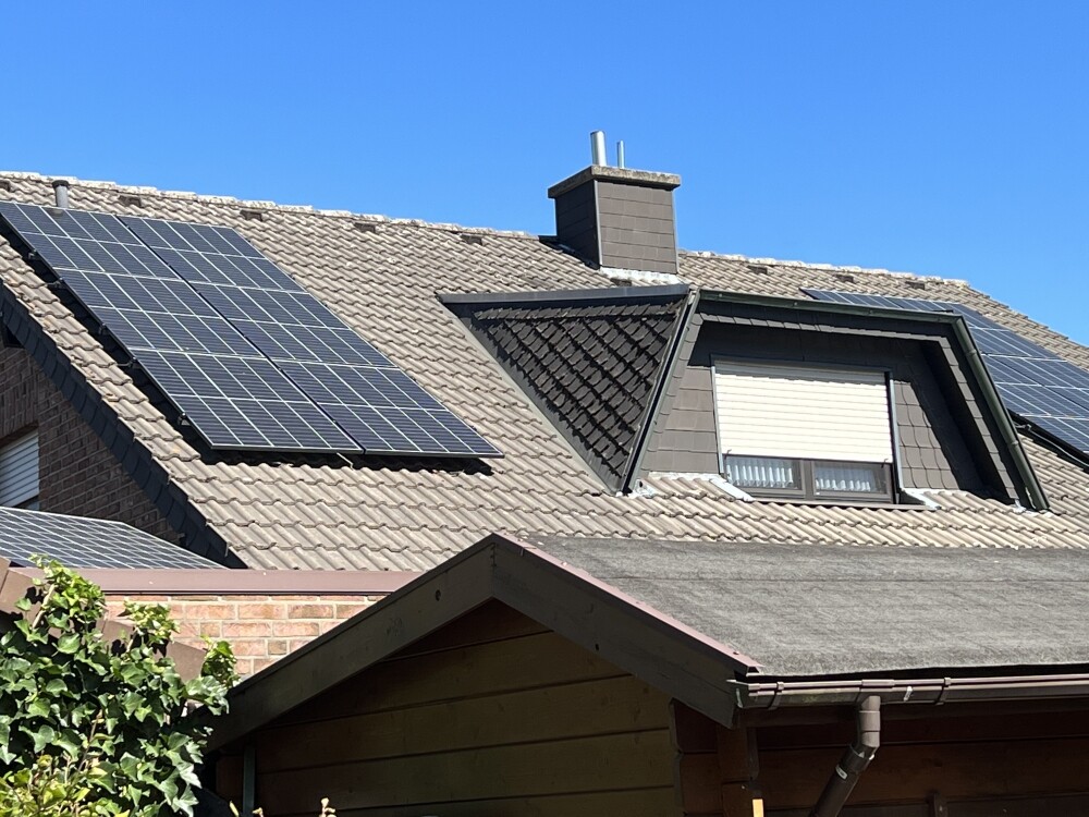

I have a house roof with a 32° pitch, on which 12 solar panels will be installed. In photo 1, you can see the roof. On the right and left sides of the chimney, 6 panels each are to be mounted in two rows. The second photo shows my neighbor’s roof. I want the arrangement to be the same for my roof.
The panel dimensions: Length: 1722 mm (68 inches), Width: 1134 mm (45 inches), Height: 30 mm (1.2 inches). The model number is JA Solar JAM54S-30-405-MR-BF 405 W mono.
Which mounting brackets do I need for this roof and these panels? How many of each type?
There are many different hooks offered online; which ones are suitable?

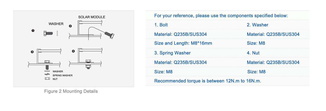

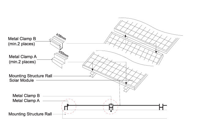

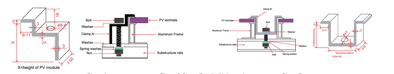

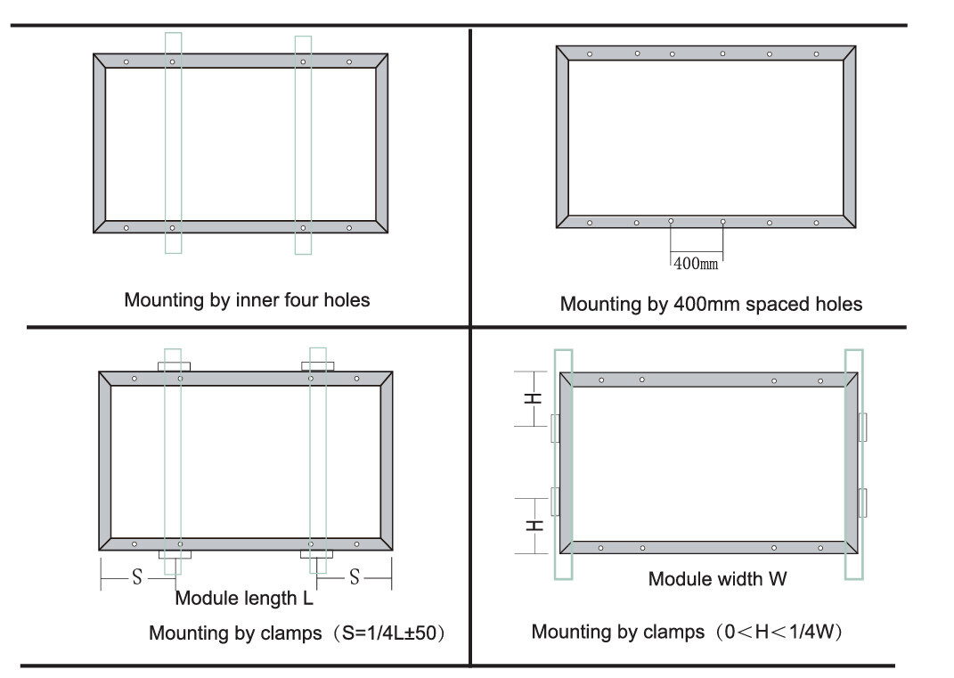

You’re welcome. This is a home construction forum, not a DIY forum. By the way, the modules are usually not installed directly on the roof but mounted on a substructure, which depends on the roof type. What kind of substructure have you chosen?
In the installation manual for the modules, you can find information on different mounting types.
Mounting details: screw with washer, spring washer and nut on the solar module.
Schematic installation: mounting rail, clamps A/B, solar module attachment, 2 pieces each.
Technical diagrams for PV module mounting: aluminum frame, screws, substructure, dimensions.
Four mounting methods for a frame element: inner holes, 400mm (16 inches) hole spacing, clamps.
