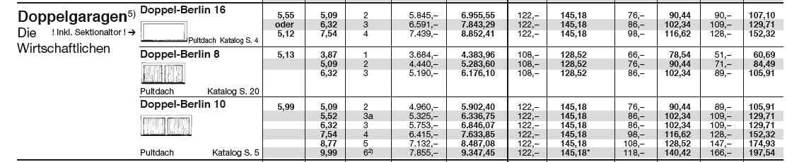

I am considering a 3S as a garage.
They offer the size I am looking for at the price I am willing to pay. 😀
