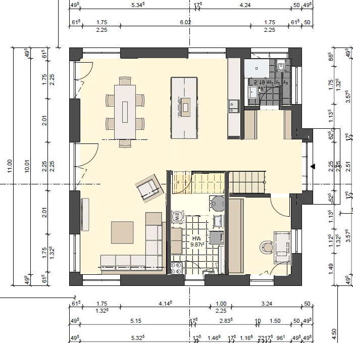

I sketched an idea for the layout:
Floor plan of a house: open living/dining area with dining table, kitchen island, sofa, stairs, bathroom/WC.

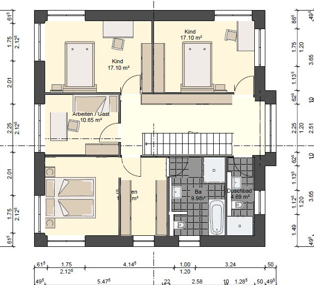

Upstairs, the staircase then switches sides. Move the children’s rooms closer to the office and place a closet (because the office downstairs is smaller). Enlarge the master bedroom, make the bathroom slightly narrower and access it through the dressing room. However, you won’t be able to have symmetrical windows on the east side. But I don’t think that’s a problem!
Attic floor plan: two children’s rooms, office/guest room, bedroom, hallway, stairs, bathroom
Dribbdebach
5 Aug 2022 14:08
Würfel* schrieb:
I agree with ypg on that. I also find it clearly too tight. I don’t quite understand why you had to discard the L-shape. I would reduce the size of the office (a large cabinet still fits in!) and allocate more space to dining-living-kitchen. The utility room should include the space under the stairs. Design the first 5-6 steps of the staircase with built-in storage for shoes, etc.
[ATTACH alt="1659624303431.png"]73743[/ATTACH]
Upstairs, the staircase then changes sides. Move the children’s room closer to the study and place a wardrobe (because the office downstairs is smaller). Enlarge the master bedroom, make the bathroom slightly narrower and access it from the dressing area. However, you won’t get symmetry in the windows on the east side. I don’t consider that a problem!!
[ATTACH alt="1659625028273.png"]73744[/ATTACH]
The L-shape was basically an extension that reached further into the garden. The house was about 12sqm (130sqft) larger. That way, the dining area next to the kitchen would have been almost outdoors, in the garden area.
Before the L-shaped design, the office was smaller as well. Good point, I have revised that and downsized the office again.
Your design for the upper floor was almost identical to an earlier version we had. What bothered us was that the bedroom door would then be directly in front of the wardrobe in the dressing area. Also, we wanted the bathroom to open towards the hallway. That’s why we switched the staircase to the other side.
On the ground floor, we had the office and toilet switched. Personally, I feel the utility room is not well placed between the office and the living room. It’s not ideal in terms of noise or plumbing. In my view, the toilet and kitchen should be adjacent. That also seems more logical given the east side orientation.
Thank you very much for your plan and suggestions. I have incorporated your and ypg’s ideas and will show you the optimized version shortly, including the actual placement of the furniture.

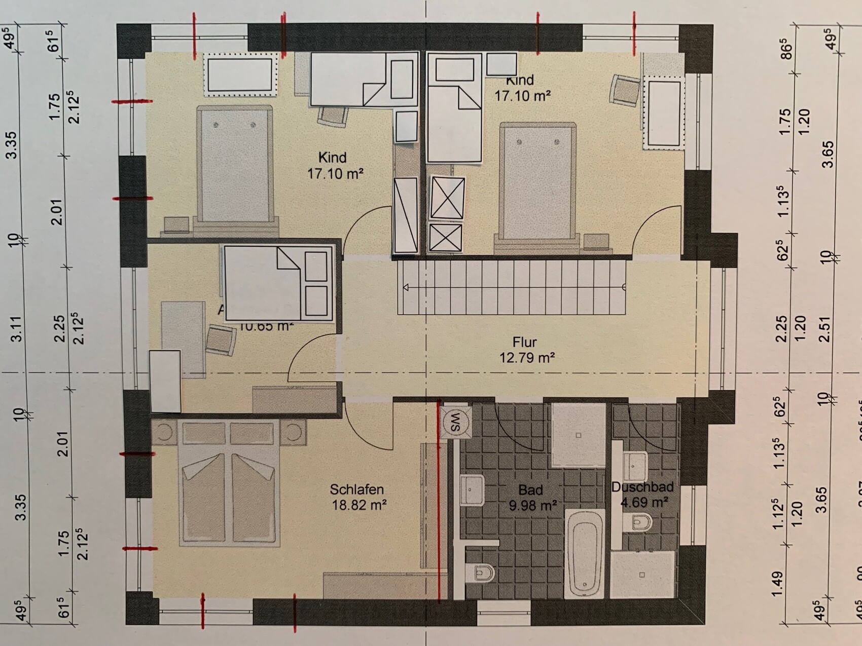

Dribbdebach
5 Aug 2022 17:04

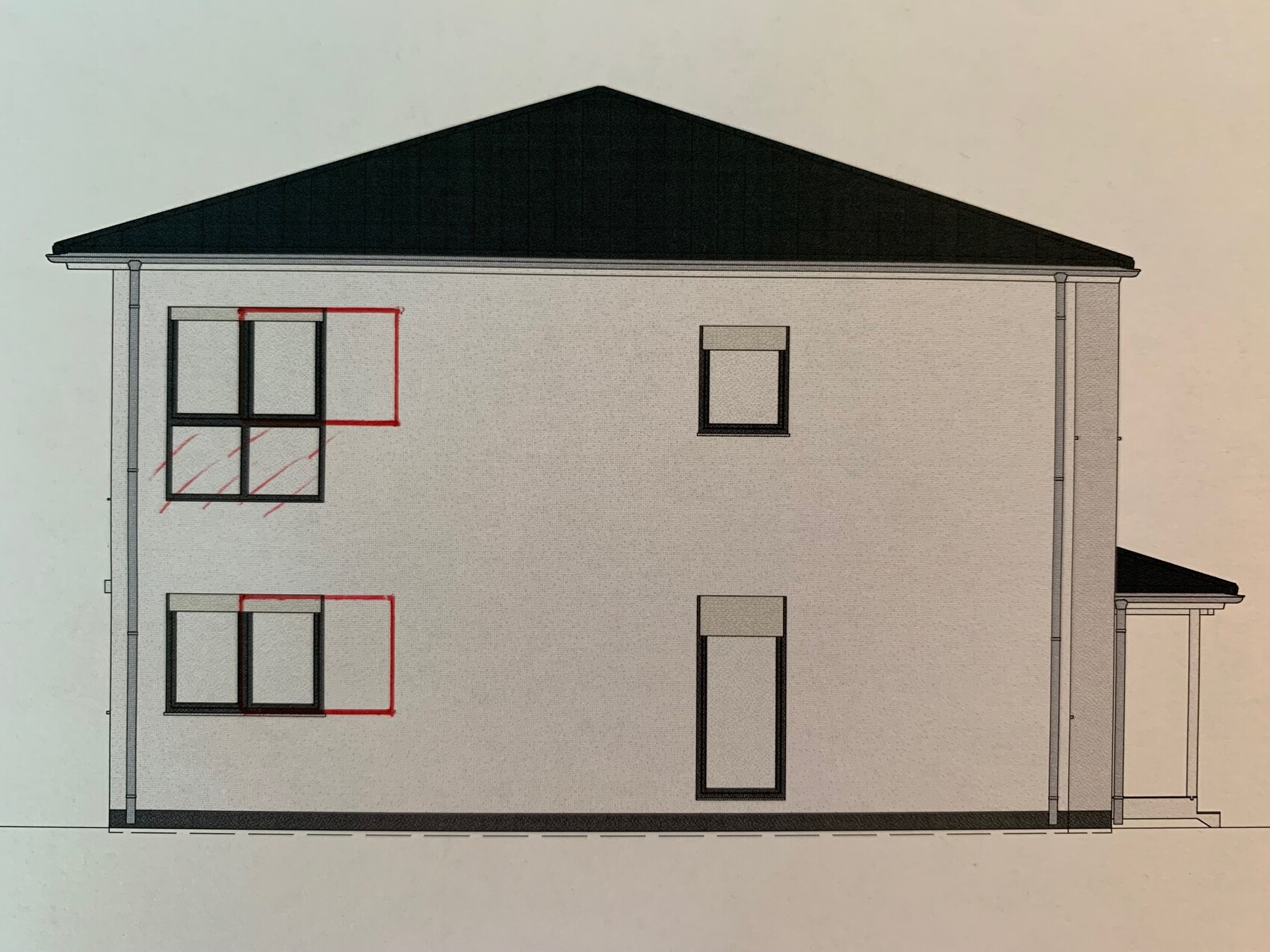

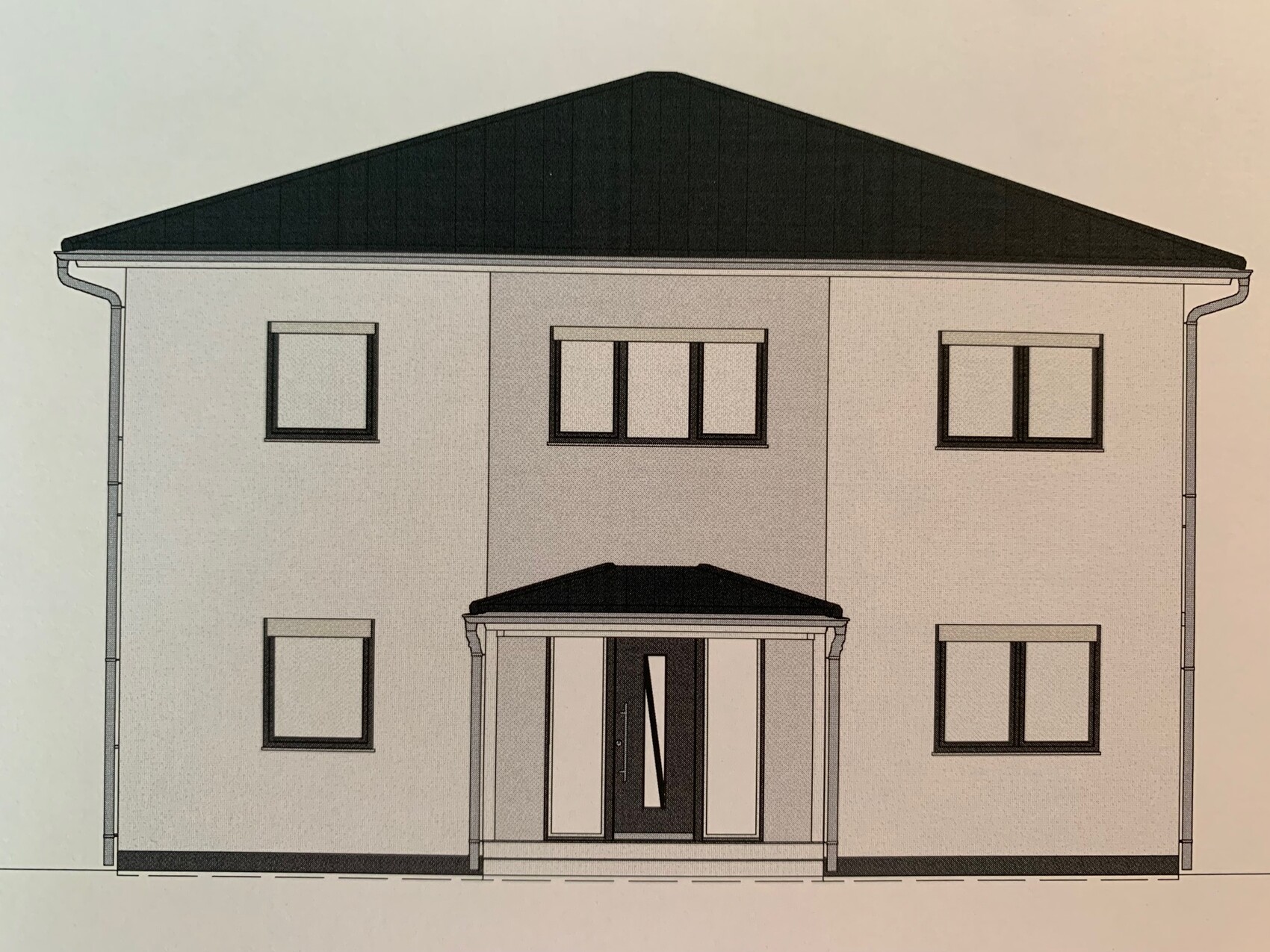

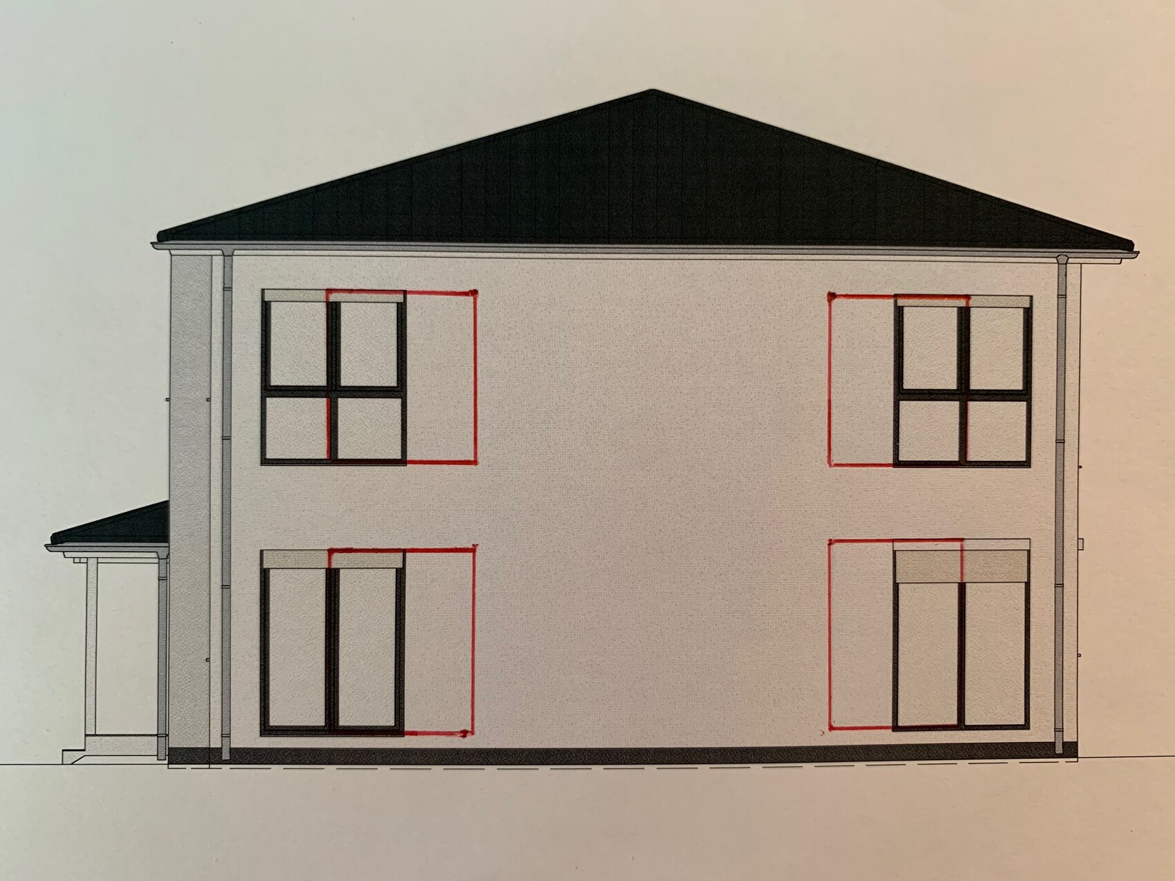

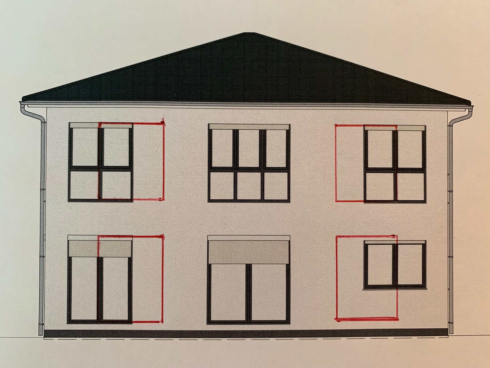

Thank you for your suggestions. Attached is what I have made from them.
All the windows should now look better from the outside.
The guest room on the upper floor will keep its size. The windows in the children’s rooms should now provide better lighting, and I have accurately shown the planned furnishings.
On the ground floor, the kitchen will have a full-height door instead of a window due to the relocated window.
The living area is enlarged, and the study is reduced in size. This creates a more relaxed space, and the TV is no longer on the window wall.
Our dining table measures 1.80 m x 0.80 m (approximately 5 ft 11 in x 2 ft 7 in), so it is a bit smaller than in the previous draft. (I have included a table measuring 1.80 m x 1 m (approximately 5 ft 11 in x 3 ft 3 in) in the sketch in case a larger table is wanted later.) In the current arrangement, you do not sit with your back to the garden when seated at the long sides. It could also be rotated, and in my view, it would still be far enough away from the living area. Alternatively, the plan could be made without an island, moving the dining table closer to the kitchen. However, then the table would partly be in line with the hallway/window.
The “free” space in the southwest corner could be furnished with an armchair. But I would rather reserve that as a play and craft area, leaving some airier space for decoration.
Here it would also be possible to depart from symmetry with the windows and move them further away from the corner. If the living area is arranged differently, there would be space for a TV or furniture there. However, this would be counterproductive regarding the window layout on the upper floor.
Have I overlooked anything with these changes?
Thank you very much for your support!

Zweistöckiges Haus mit zentralem Vordach-Eingang und symmetrischen Fenstern.
Zweistöckiges Haus mit Satteldach; linke Fenstergruppen mit roten Markierungen.
Frontansicht eines zweistöckigen Hauses mit Satteldach Fensterrahmen, rote Markierungen um Fenster.
Zweistöckiges Haus mit Satteldach; seitliche Fassade, vier Fenster, rote Markierungen um Fenster.

Würfel*
10 Aug 2022 11:35
A few things I would reconsider:
The wardrobe will not be sufficient for four people, even with a depth of 60cm (24 inches), and you are planning:
Dribbdebach schrieb:
There is a little space for coats under the stairs,
However, I would find the view from the dining table to the front door and the stairs, as well as the items stored underneath, unattractive. That’s why in my idea I tried to avoid exactly this line of sight. You could also simply add a door to the living-dining area; then, naturally, you wouldn’t see—or wouldn’t see as much—anymore.
I think the sofa and TV look very cramped there. But if the living room is not a priority for you and you don’t have a large TV, it should be fine.
Upstairs, the children’s room on the left side of the plan doesn’t seem nicely furnished to me. The bed is uncomfortably placed facing the door. It would be better positioned along the wall adjacent to the study. However, that would mean the window would have to be moved back outside.
If the children are supposed to have access to the master bathroom anyway, I would consider removing the small shower bathroom entirely. I don’t think it’s necessary to have two toilets upstairs if there is one right down the stairs. This would have the advantage of giving you space for a dressing area and/or a larger bathroom.
