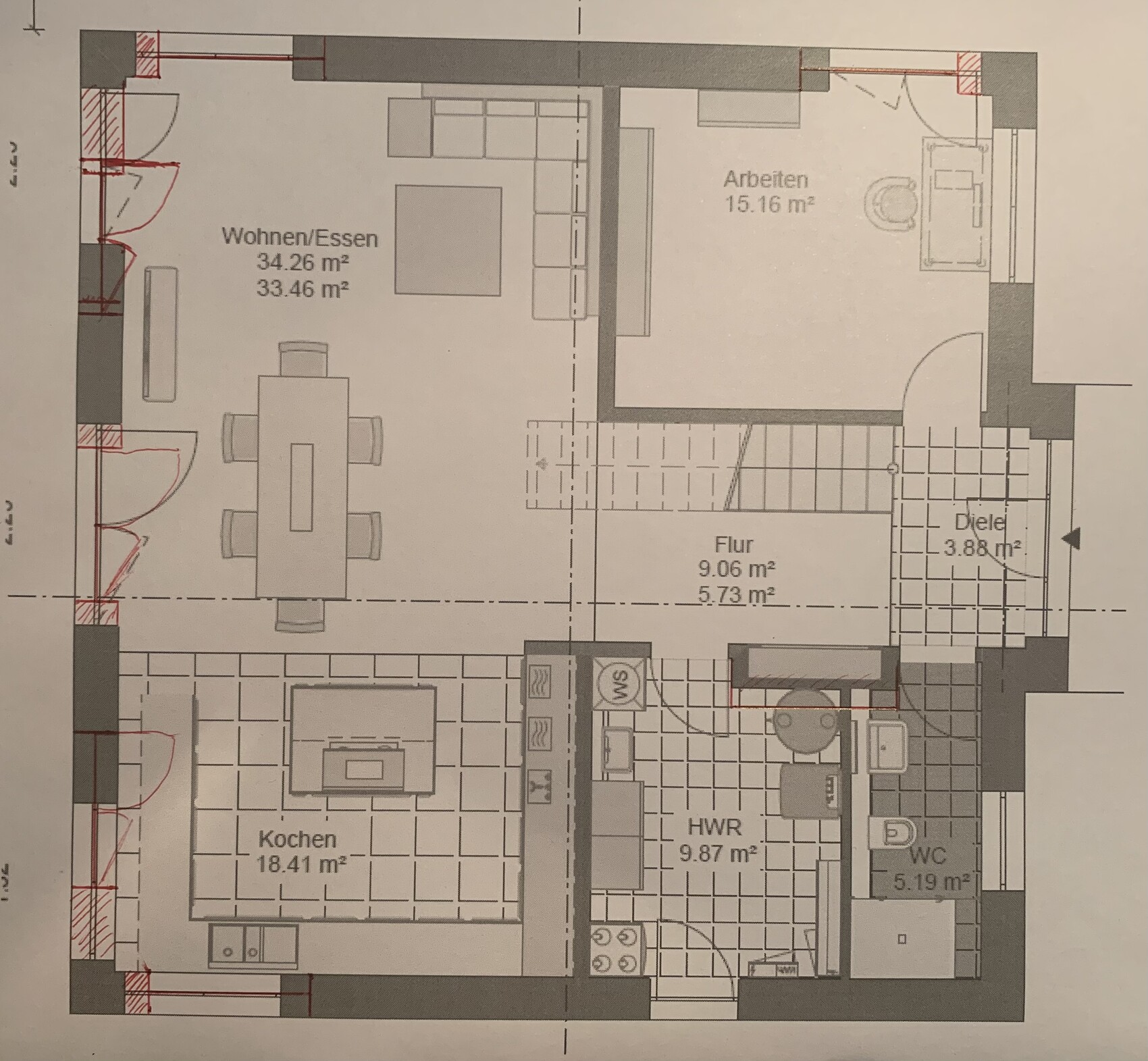

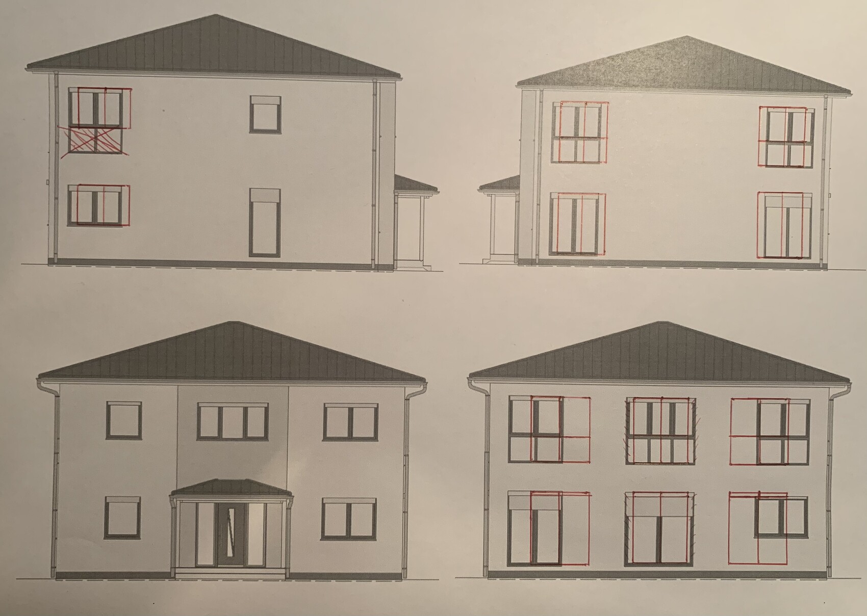

Attached are sketches showing possible changes. Please excuse the poor image quality. The focus is only on the red changes; otherwise, the images correspond to the latest floor plans.
I like almost all the changes. Only the narrower terrace door on the south side leaves me uncertain. Not all windows need to be the same—perhaps the advantage of a wider door for the view from inside out outweighs the less favorable appearance from the south side.
What are your thoughts on the changes?

2 Aug 2022 23:25
1. Regarding the reduction of the office size: that is not necessary. The bedroom and children's room will have light switches at the wall edges. This is more of an advantage than a disadvantage. I would keep the office as it is.
2. Office window not improved. In theory, 1 square meter (11 square feet) is sufficient for working. More would actually be tiring.
3. South façade, or rather the ground floor window layout: poor furniture arrangement options due to window placement in general. I would also not necessarily arrange town villa windows symmetrically. They can handle some variety.
Children’s room windows, the office, and the living room could benefit from being pushed about one whole meter (3 feet), or possibly even more, further into the interior space.

2 Aug 2022 23:37
I wouldn’t reduce the size of the office. There’s no reason to do that, right? These pseudo corner windows don’t appeal to me in the renderings either. What exactly is the reason you want them like this?
Dribbdebach
2 Aug 2022 23:53
Yosan schrieb:
I wouldn’t reduce the size of the office. There’s really no reason to do that, right?!
I also don’t like those pseudo corner windows in the elevations. What exactly is the reason you want them like that?
I suspect that the narrow section just after the doors looks strange, and I wanted to create clear, rectangular floor plans for the rooms again. Basically, 9 sqm (97 sq ft) would also be enough for the office.
We had enlarged the office so that a 1.60 m (5 ft 3 in) wide bed or sofa bed could fit there. But 1.40 m (4 ft 7 in) would also be sufficient — and this works with 9 sqm (97 sq ft).
I’m still thinking it over. If you don’t see any problems with these “corners,” maybe it can stay as it is.
At the model home exhibition, there were several houses with corner windows or windows meeting at the corner. They created very nice spaces inside. I like it inside — but I don’t really like how it looks on the outside.
It doesn’t have to be that way, so the windows have now been moved in the sketch.
Dribbdebach
3 Aug 2022 00:02
2. Office window not improved. In theory, 1 sqm (10.8 sq ft) is enough for working. More can be tiring.
3. South facade: or rather windows in the ground floor layout: poor furniture arrangement options due to window placement in general. I wouldn’t necessarily arrange the windows on an urban villa symmetrically either. They can handle a bit of variety.
Children’s room windows, the office, and the living room can benefit from being pushed about a whole meter (or even more) into the interior space.
Regarding point 2: I like large windows and plenty of light. A small window would be too little for me and wouldn’t visually fit the ground floor either.
There’s a choice between about 1.75 m (5 ft 9 in) and 2.30 m (7 ft 7 in). I actually find the wider version on the ground floor more attractive, while the narrower window suits the upper floor better.
Regarding point 3: There’s no furniture placed along the south wall—maybe the TV, and even that tends to be elsewhere. So I don’t necessarily need a large uninterrupted wall without windows.
The windows are recessed 1.40 m (4 ft 7 in) from the exterior, with an inner dimension of 0.8 m (2 ft 7 in). If you move them even further, you end up roughly in the middle of the upper floor rooms—making furniture placement significantly more difficult there.
The liveliness of the windows would already be achieved by the wider central dimension… :-)
