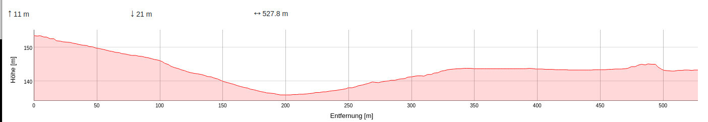

Are you really about 40m (130 feet) lower? Or was a larger size assumed?I calculated using a DN40 (1.5 inch) pipe and got about 0.5 bar pressure loss through the line with an online calculator. Regarding the slope, it depends on where the pipeline starts—the location is on a hillside. I’m attaching an elevation profile (from Tim-Online), showing about 8 m (26 feet) of slope from the town center (the supply is on the left side).xMisterDx schrieb:

xMisterDx4 Feb 2023 23:24You see, your data is completely plausible. DN40 causes a pressure loss of 0.23 bar over 600 m (0.23 psi over 1968 ft) at 30 liters per minute (7.9 gallons per minute). DN25 already has a pressure loss of 2.7 bar in this case.
That’s why it simply doesn’t make sense that using DN50 over 150 m (492 ft) would lead to such an extreme additional effort that would become unaffordable.
Because making the pipe two sizes larger is hardly a big deal. Does the excavator bucket for the trench have a width of 40 cm (16 inches)? Then you can fit both DN25 and DN40 just fine...
