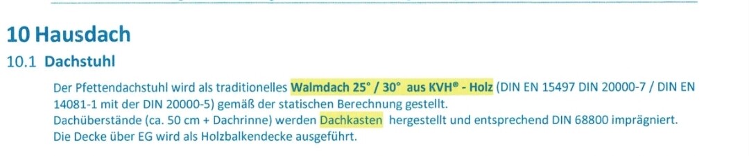

K1300S schrieb:
Check out DekoTop. They have a huge selection of decorative finishes.According to the building specifications, I understand that the roof box is made of wood.
