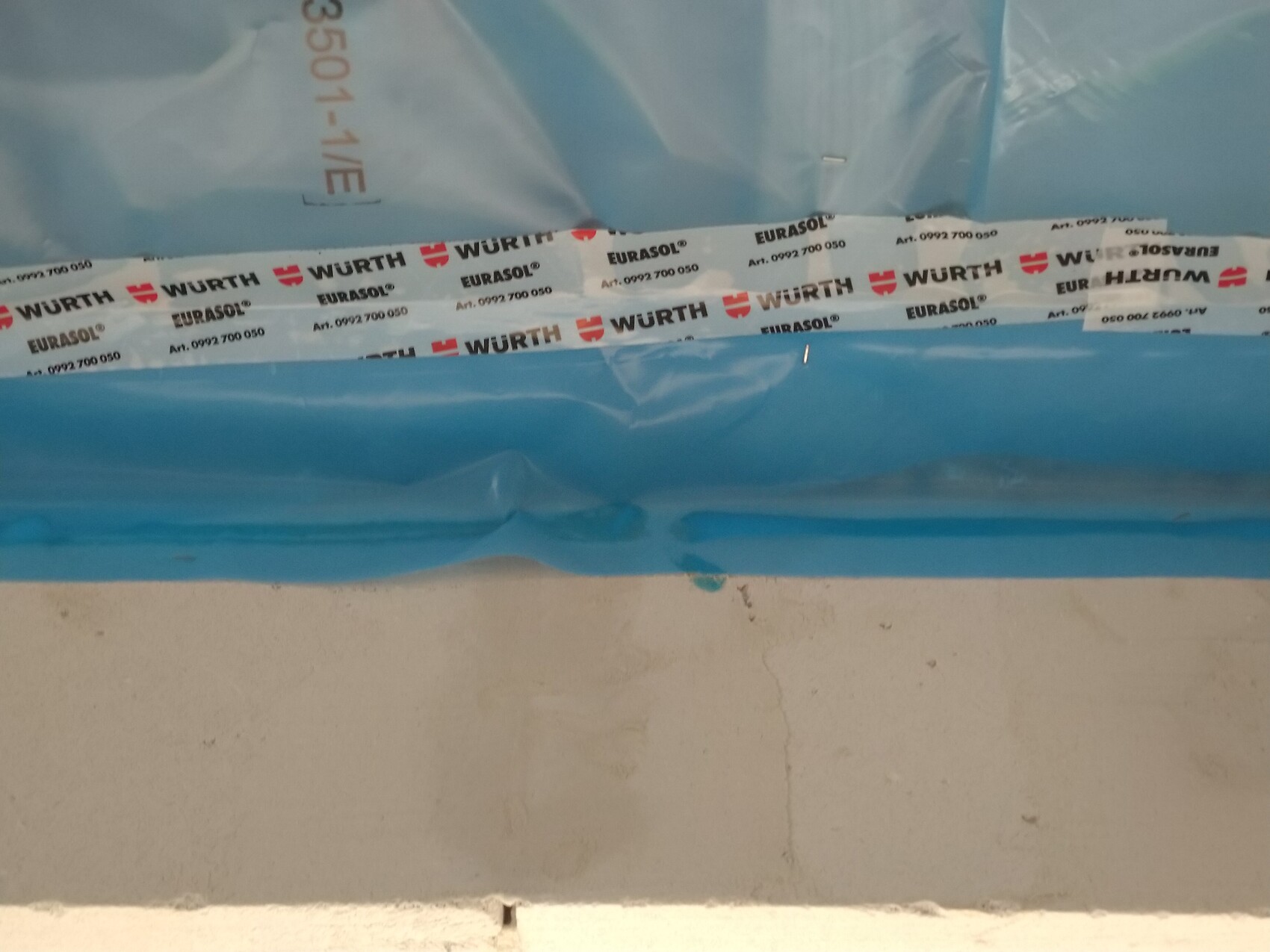

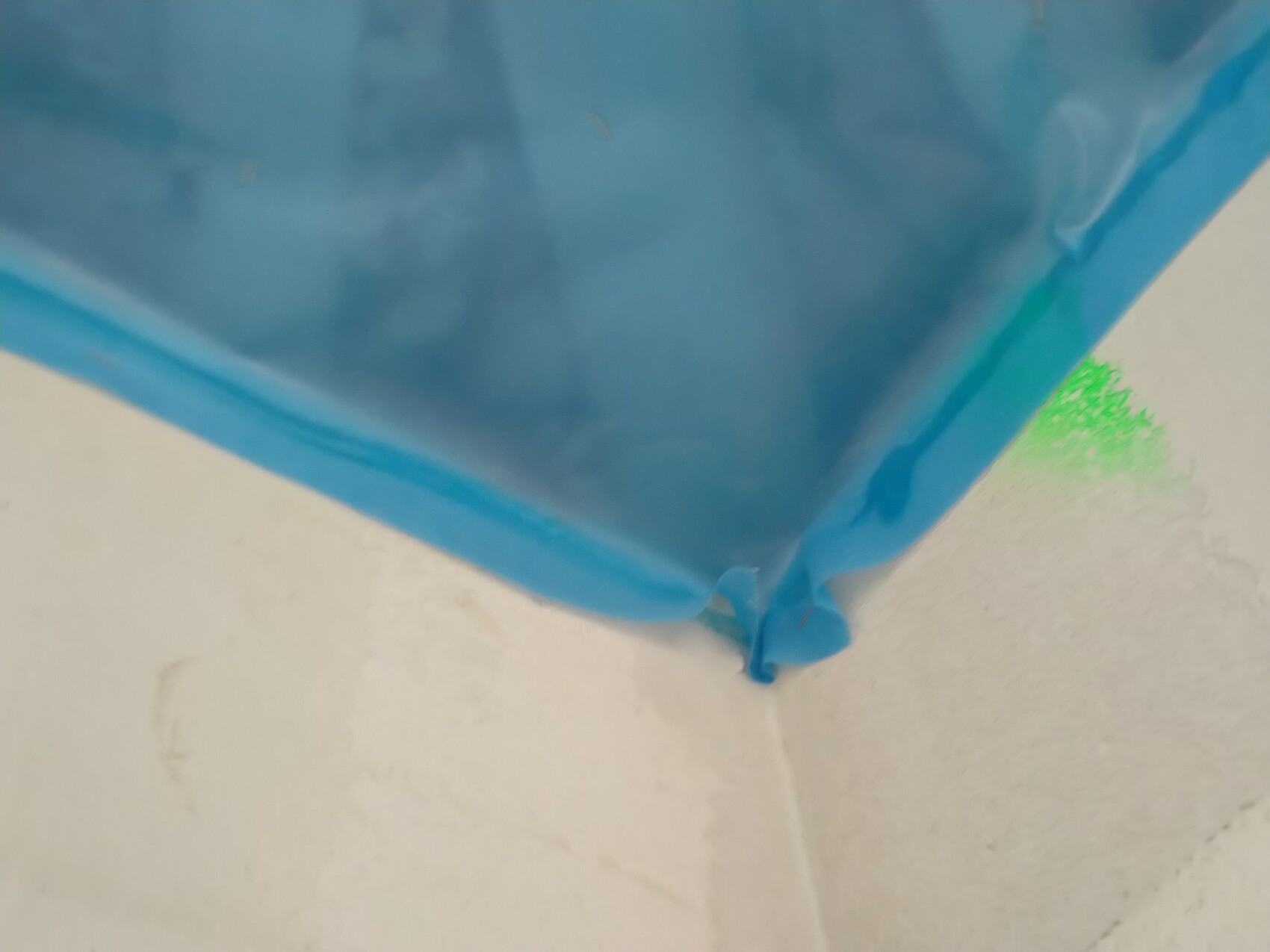

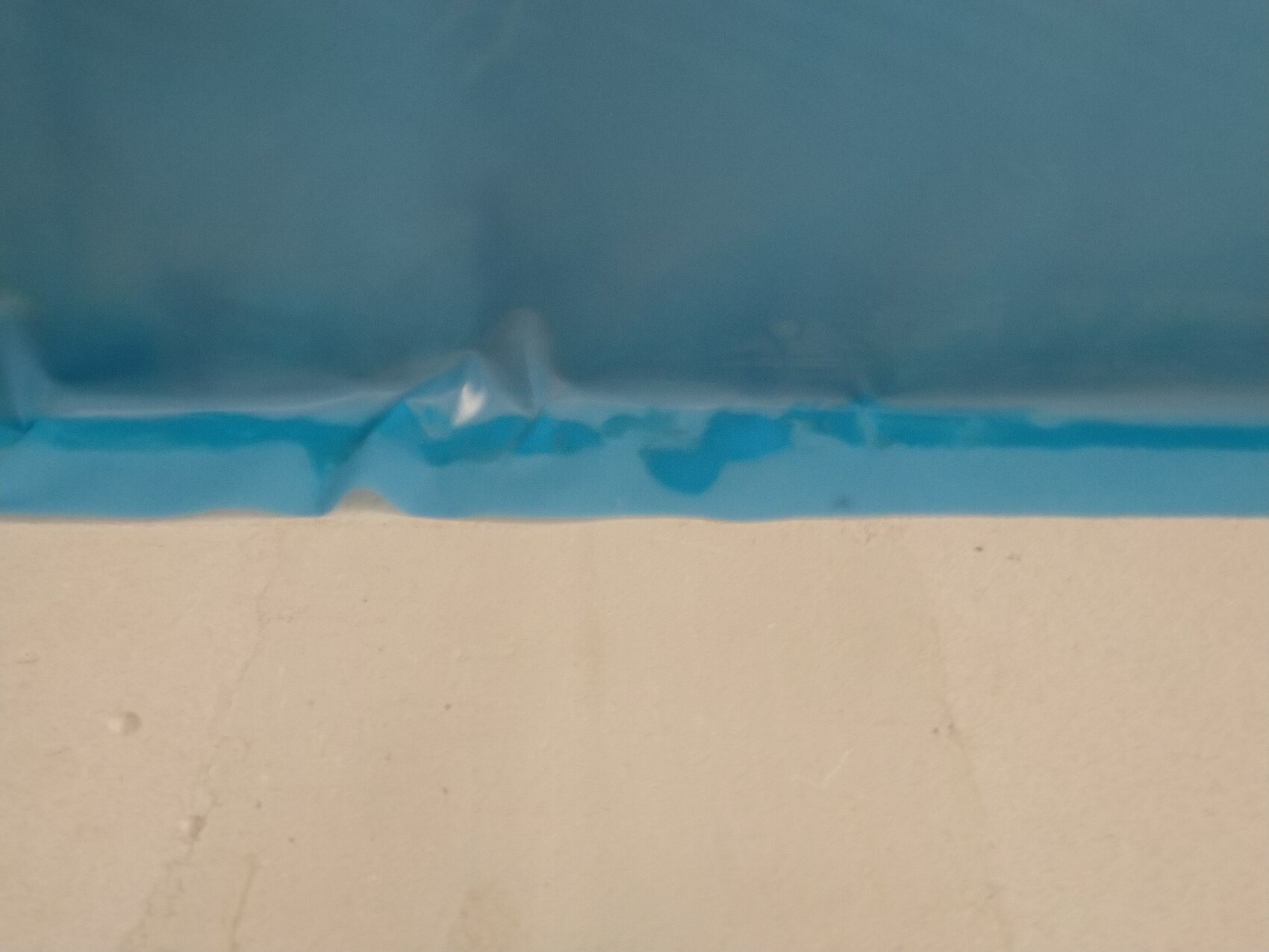

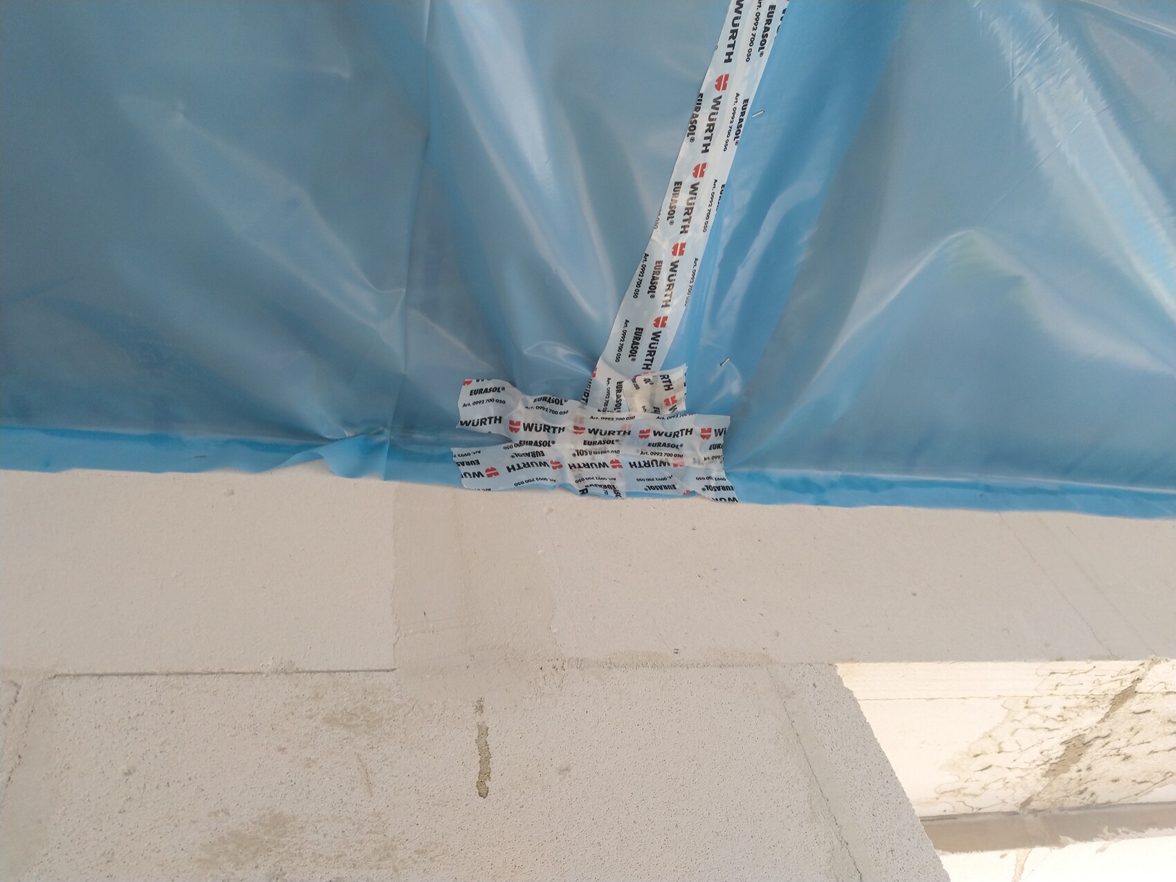

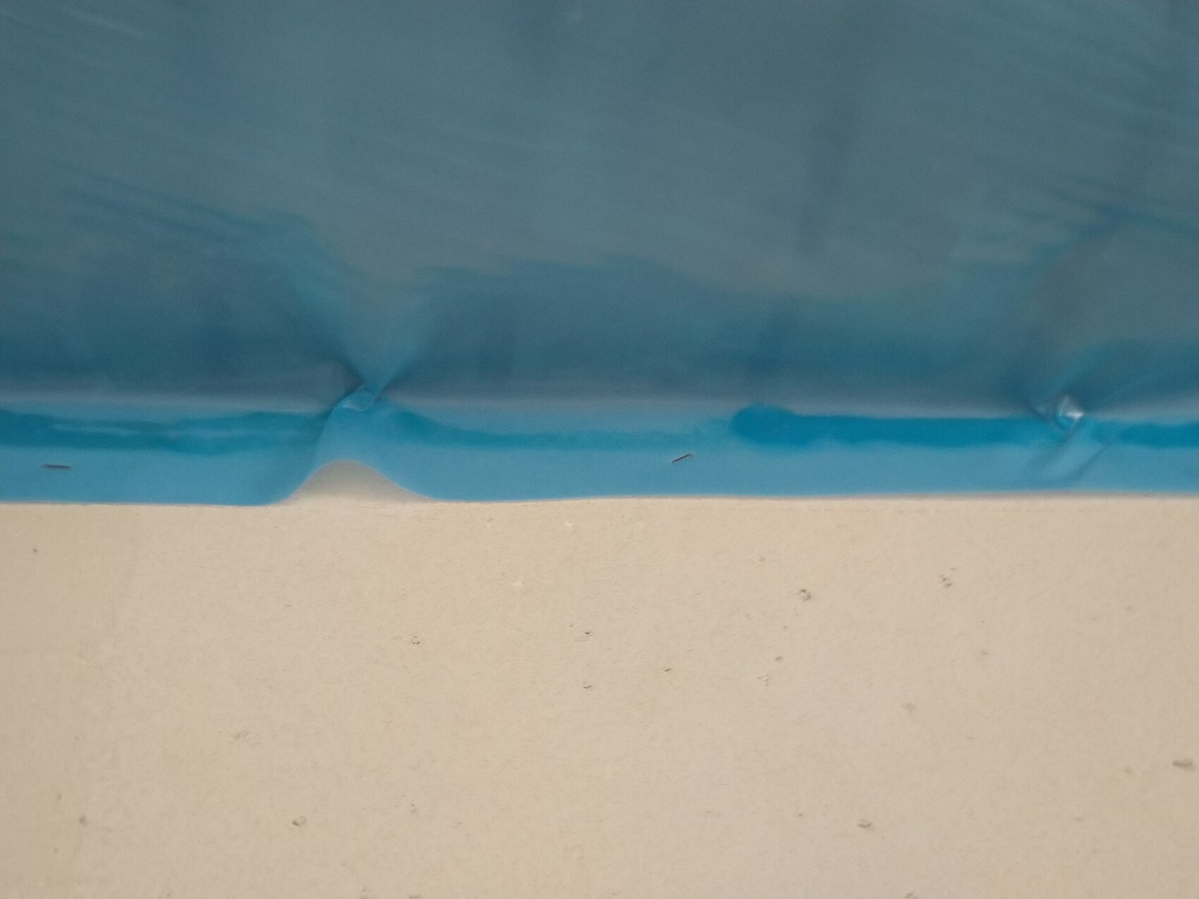

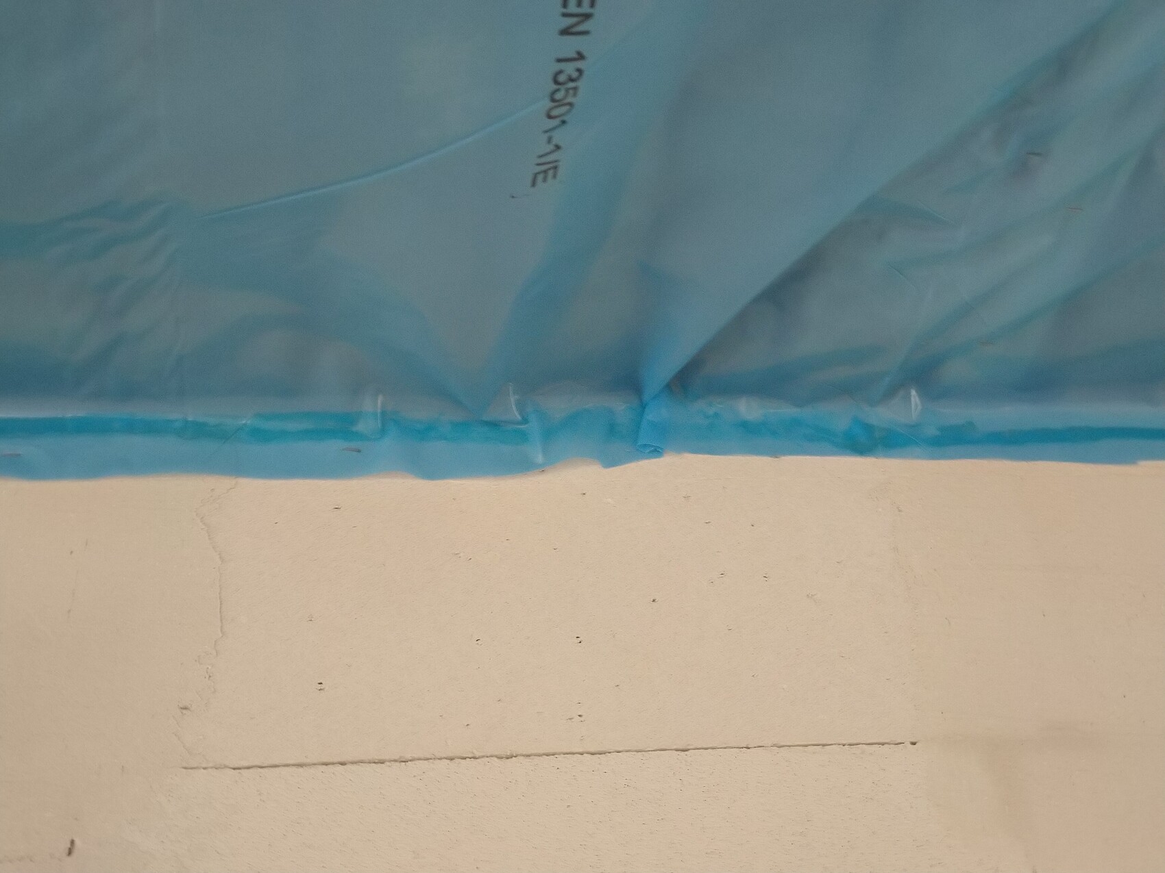

Our construction company has attached the membrane on the ceiling to the wall. The connection points do not look very neat to us, so we are unsure if the intended insulation will be fully effective.
This is the first upper floor, with gypsum boards installed above. Above that is the attic, followed by the hipped roof.
We would greatly appreciate your opinion.
Thank you in advance.

Mycraft13 Mar 2020 20:10
Have them come by again to make further adjustments.
trksglm
13 Mar 2020 20:47
...so our concern is justified?
Nordlys
13 Mar 2020 22:17
Yes, it doesn’t seem to be properly sealed. And it needs to be airtight.
