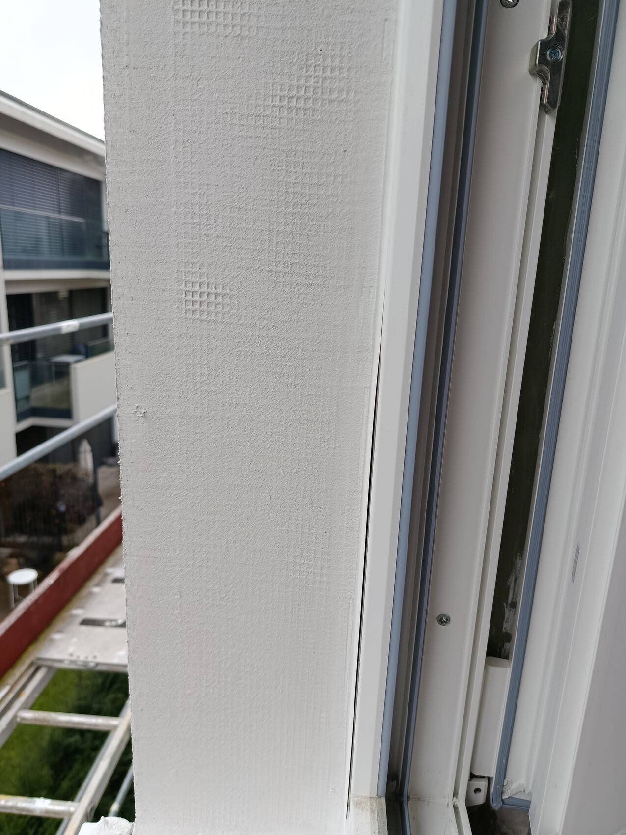

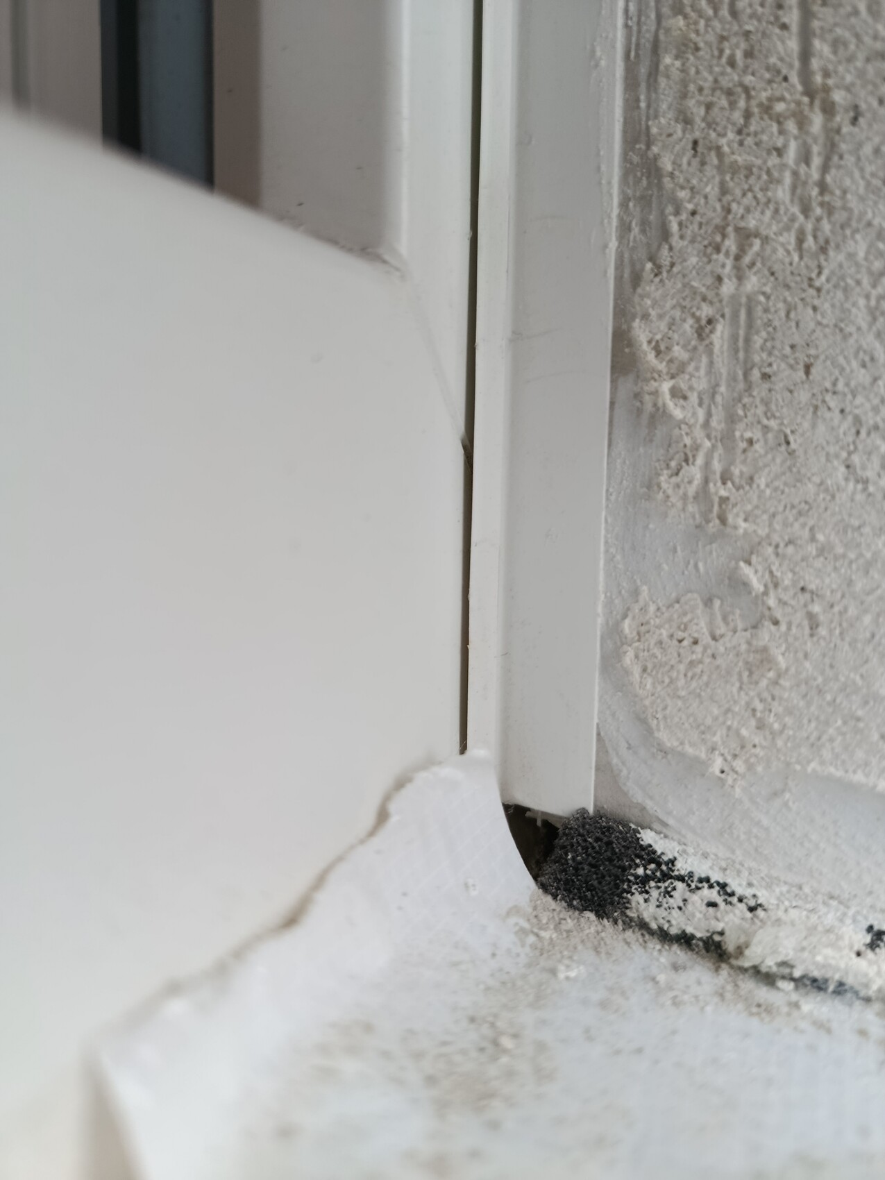

I have an Aquapanel facade with plaster. An edge trim profile has been installed at the window reveals. A compressible sealing tape (Kompriband) has been applied at the lower area but does not extend all the way to the frame. Photos attached.
Substructure: timber frame with insulation, weather-resistant membrane (underlay) sealed to the frame using Soudal window connection tape, and a second waterproof layer below the windowsill.
Question: Does this meet the standard connection details according to DIN/manufacturer specifications (rain-tight, flexible), or is rework necessary?
Thanks for any advice!
