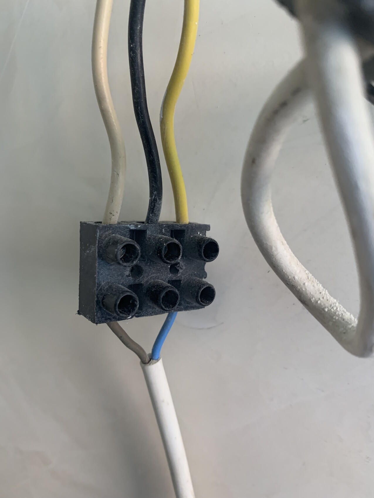

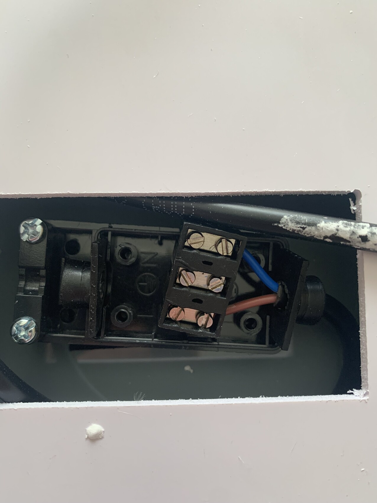

I’m not sure which cables need to be connected together. Could someone possibly help me here? It’s strange that the black cable always shows voltage with a non-contact voltage tester, but it’s not switched.
Thank you very much for your feedback.
Close-up of an electrical terminal block with blue and brown wires in a wall box.
Terminal block with six holes; dusty, wires white, black, yellow, blue.

I think it’s quite smart to run a phase that is independent of the switch.

10 Feb 2023 14:58
