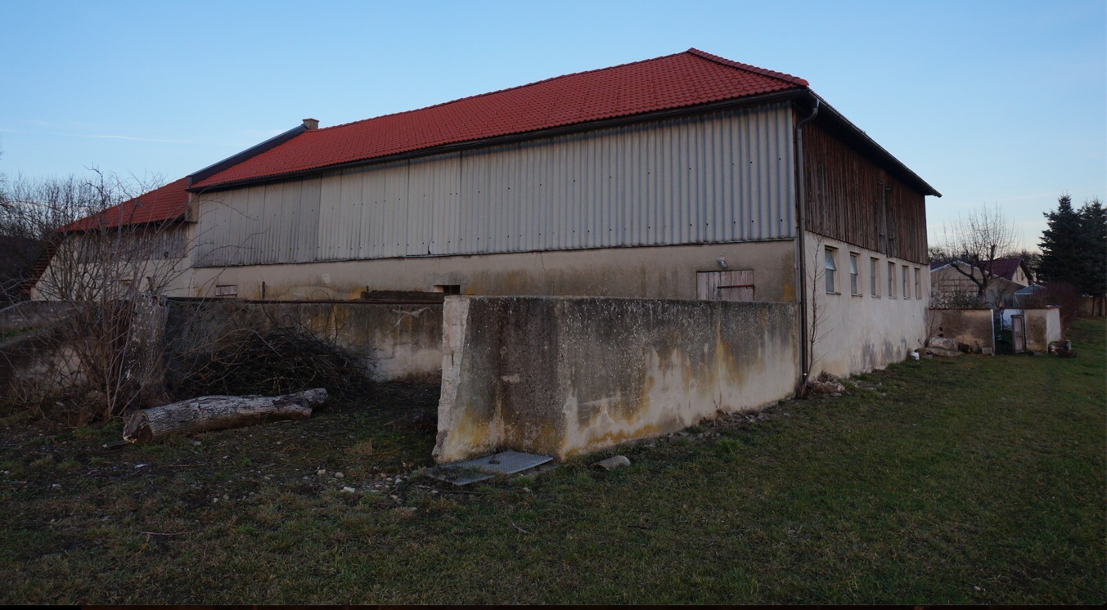

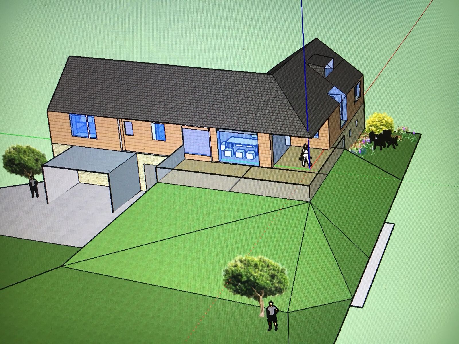

I am planning a loft conversion and, of course, also a terrace with garden access. The “problem” is the height; the terrace is about 3.10 meters (10 feet 2 inches) high. The length is approximately 6 meters (20 feet). Is it at all realistic or affordable to add fill to such a large height? I have plenty of space available due to the slope, so that wouldn’t be an issue. In the attached photos, you can see the current state as well as the planned future house.

Option No. 2: I don’t make the terrace level with the door, but instead go down a step or two before the terrace. That way, I gain about 50 cm (20 inches) and would need less fill. But I suppose that doesn’t really make much difference, does it?

Converting an agricultural building where the stables become a ground-level basement is misleadingly described as an "attic conversion."

The "stables" have been empty for decades and have been converted into storage and a workshop, and are partly occupied, so I don’t think the term "attic conversion" is entirely wrong in this case...

If you want to use a robotic lawn mower, the maximum slope should be 40%. That would be 8 meters (26 feet) of incline.
Filling material
Transport
Excavator
Compaction
Retaining wall on the left and right.
Structural engineering
Can the old wall withstand the pressure? For a 3.10-meter (10 feet) slope, you would need a massive retaining wall with a lot of steel reinforcement, not a regular stable wall.

Why don’t you build a large balcony with a spiral staircase into the garden instead?
