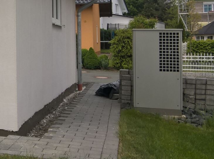

Yes, after seeing the gravel in your picture, I also thought about using a different (more permeable) gravel. At the moment, my eaves strip is filled with 0-16mm (0-5/8 inch) gravel (crushed stone), which is probably not ideal. It would likely be better to use 16-32mm (5/8-1 1/4 inch) rounded gravel, which creates more void space. What kind of gravel do you have, and how deep is it compacted in the eaves strip?
nasenmann2 Feb 2017 07:39Sorry Bieber, I just saw that you asked for a picture. Unfortunately, there wouldn’t be much to see on my side compared to yours. The outdoor unit is placed directly on a concrete base. The drain hose goes straight down into the pipe inside the unit. So, nothing is visible from the outside.
Edit, here is a quick picture where you can roughly see it:
Bieber08159 Feb 2017 09:00daytona schrieb:
What type of gravel do you have and how high is it filled in the eaves strip? Definitely 16-32 mm (5/8 - 1 1/4 inches). I don’t know the fill height, I would have to check the photos.
Coarse gravel (16/32) is definitely more suitable. The base area should not be exposed to any standing moisture.
