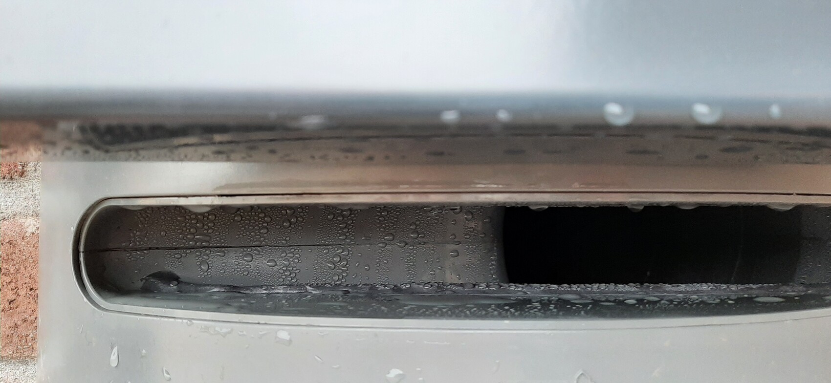

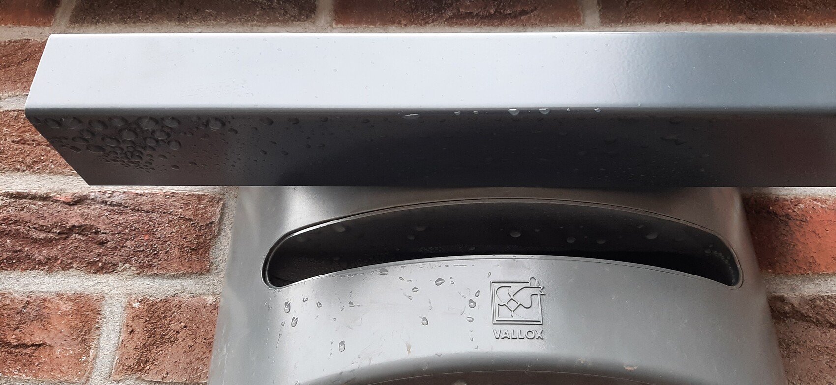

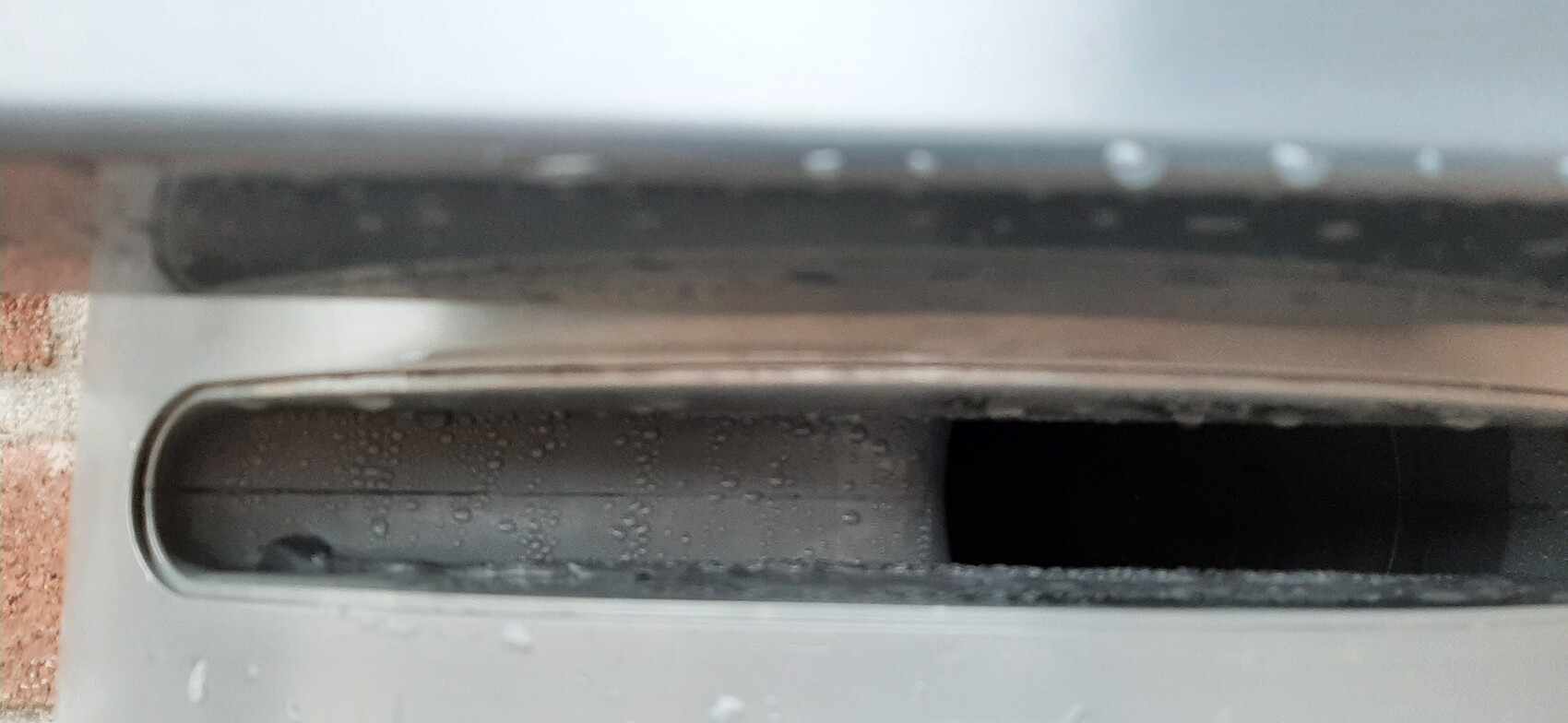

Hello, I’m struggling to control the condensation buildup we’re experiencing. The ducts for our ventilation system pass through the utility room wall into the garage and from there through the wall to the outside. We have a double outlet side by side. Condensation always forms on the exhaust hood, as shown in the pictures.
About half a liter of water accumulates quickly, which then collects inside the duct. I only noticed this when it started dripping in the garage (where the duct meets the exterior wall).
At first, I thought it was rainwater because there was so much water inside the duct. In a test, water also entered the duct when I poured water over the cover from above. I therefore screwed a metal sheet over it. The metal sheet extends outward to prevent driving rain from entering.
I’ve also already screwed the cover at an angle so most of the water runs off the front. Inside the cover, I applied a thin silicone bead to prevent water from flowing back.
Of course, the manufacturer has already been involved here. They said they had never seen anything like this before.
No condensation forms on the duct itself; it is always dry when I check. It’s the exhaust hood that causes the condensation.
What are your ideas? Different exhaust hood? Do you know of anything like this? The system is from Vallox.
Gray metal casing on red brick wall, raindrops on the surface, VALLOX logo visible.
Close-up of a metal slot with water droplets and dark interior.
Close-up of a flat metal slot opening with water droplets inside, presumably a toaster.

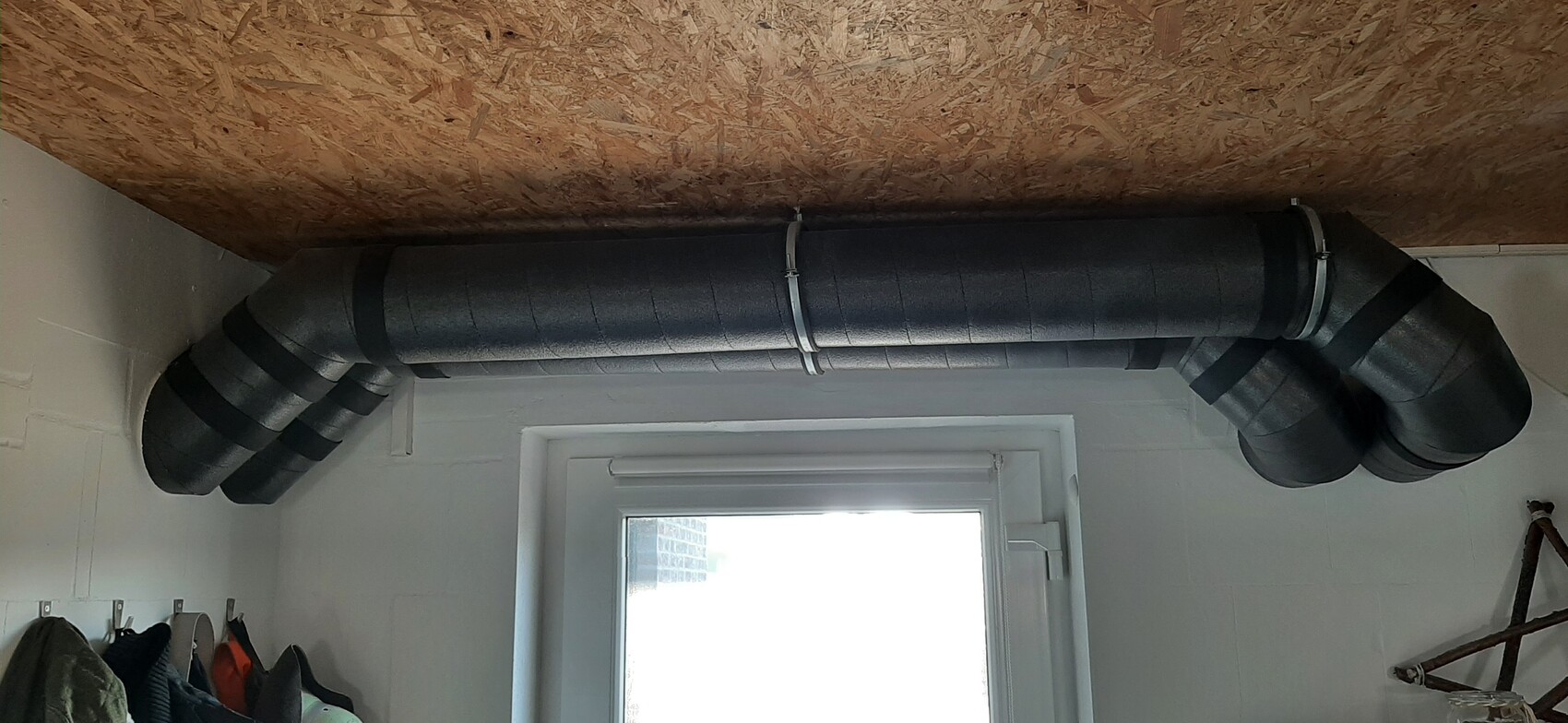

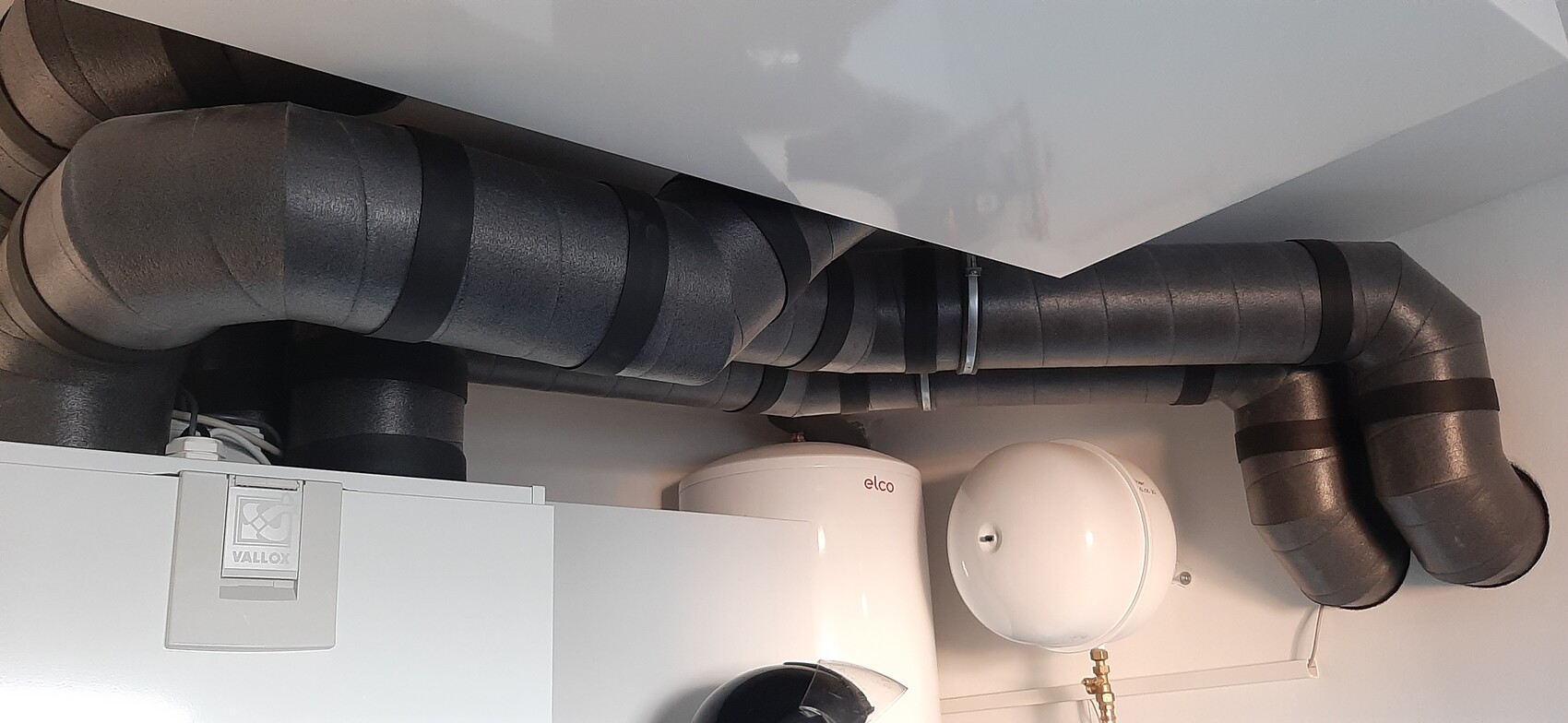

Here are some pictures of the pipe layout. In the garage, the pipe goes down again and then passes through the exterior wall (to the right of the door). That’s where it accumulates. So far, the only drain is inside the ventilation unit itself.
Large gray ventilation pipes with bends run under an OSB ceiling above a window.
Insulated metal heating pipes, expansion tank, and boiler visible.

How can the water flow back into the pipe if the exhaust vent is constantly running? It should actually be blowing the droplets outside. Otherwise, you could check the slope of the ceiling pipe in the garage. It looks to me like it might be sloping in the wrong direction.
