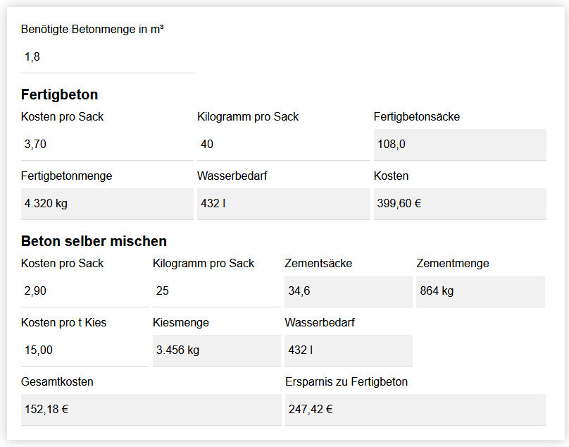

I ran these numbers through a calculator—please ignore the costs. This is just about the quantities.
