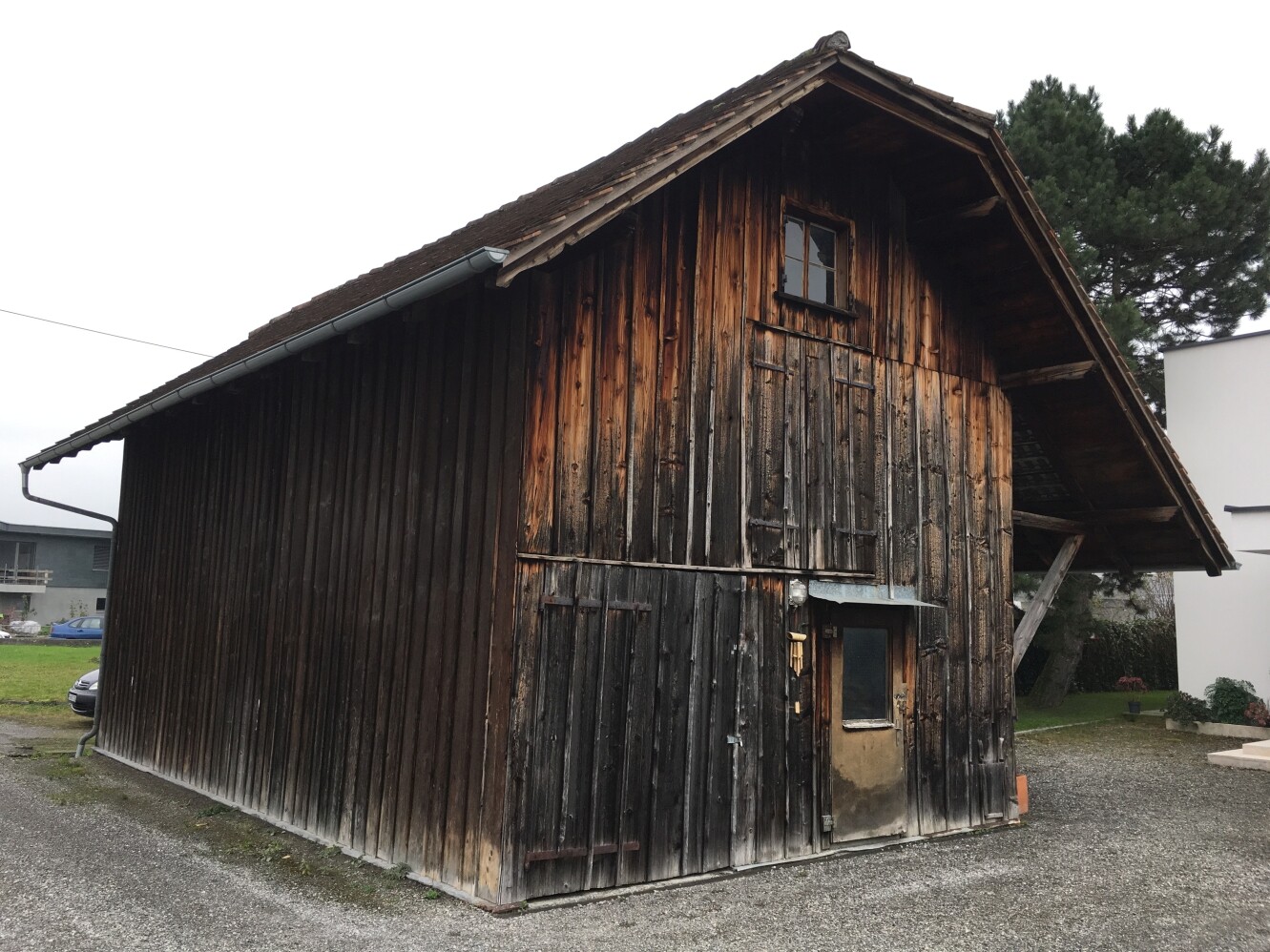

Next to my house, there is an old wooden barn that I am currently renovating. Now the question about the flooring comes up. A wooden plank floor would fit well and I could install it myself or with my father (a retired carpenter).
However, since I also distill spirits and have my distillation equipment in the room, there is a chance that mash might spill onto the floor. Additionally, the room is intended to be used as a party space, and wood flooring is not really ideal for that.

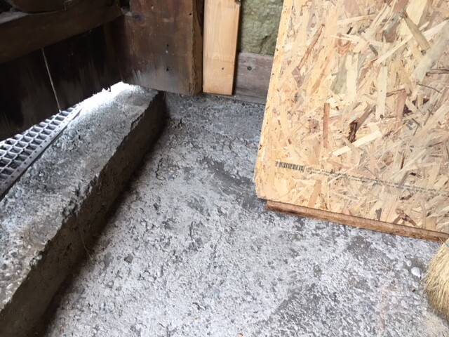

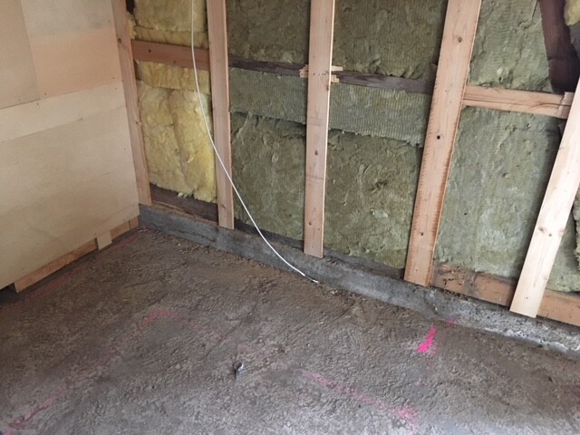

The current floor is also a very rough concrete surface. I plan to add 3cm (1 inch) of insulation on top of it, followed by an 8cm (3 inch) concrete screed layer.
Do I need reinforcement in this case? The floor only needs to support the interior furnishings and no additional loads such as walls.
