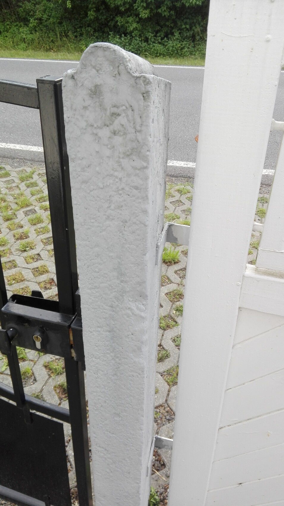

I have old fence posts that are set in concrete in the ground. They are made of concrete. I now have new fence panels that are narrower than the old ones, and I would like to widen the existing fence posts. My idea was to create a formwork and simply apply concrete with a thickness of 3–7 cm (1.2–2.8 inches) using the formwork.
The existing posts are painted with wall paint. My concern is that the new concrete might not bond properly with the old one. How can this be prevented? Or does anyone perhaps have another idea?
I look forward to your replies.

3 cm (1 inch) of concrete is insufficient; it will crack and fall off due to frost. The coating also prevents bonding from forming, so only a high-pressure cleaner can help. Why don’t you reinforce it with an appropriate squared timber instead?
Thanks for the tip. I can remove the paint with a pressure washer. The fence panels are made of metal, and wooden extensions don’t look very good. Since I also need different widths (the posts are sometimes a bit further apart, so a thickening between 3 and 7 cm (1 and 3 inches) is necessary), wood wouldn’t look great and would weather quickly here. (The wooden fence only lasted about 6 years despite maintenance.)

Why not just knock them off and install new wooden posts next to them? It’s easier, faster, and cheaper—or you could use lightweight metal posts.
An approach like the one you described will involve a lot of effort, time, and cost, and in the end, it still won’t look good.
