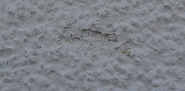

We have a new build that was completed about 2 1/2 years ago. The masonry is made of pumice stone blocks (Bisotherm). For the base coat plaster, our architect, who was also the construction manager, specified the material LUP222. However, the contractor used the material Super Lupp without consulting the construction manager or us. The exterior facade was not painted after plastering.
In July 2015, there was hail in our region that caused damage to the exterior walls on the weather-exposed side (west / south). The top coat plaster chipped off in hundreds of places. Before this, we had already noticed that our exterior facade is very soft. In many places around the house (about 20 spots), there were already similar top coat plaster chips that could have been caused by light mechanical impacts.
Over the weekend, I did another test: I leaned a metal ladder against the house wall, climbed up and down. At the spot where the metal ladder was leaning, the top coat plaster has now chipped/indented.
According to the contractor and manufacturer, this is normal for mineral plaster (Super Lupp).
