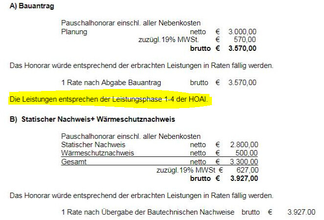

NeuerBauherr26 Jun 2020 10:27Lumpi_LE schrieb:
and once again the service phases got mixed up. This keeps happening throughout the thread.
The offer states $3,000 for service phase 4. While it is true that you cannot carry it out without the previous phases, so at least some effort is involved here, it is not comparable. I can’t shake the feeling that some either do not want to read properly or are unable to!! Nothing is mixed up at all, just take a proper look at the offer—it explicitly states service phases 1 to 4. I even highlighted it again for you @Lumpi_LE

Matthew0326 Jun 2020 11:15NeuerBauherr schrieb:
@Matthew03 and also your comment that I should answer something I have already written at least twice before, well... I’ll keep my thoughts to myself on that.
Since this is now getting off-topic, I’ll let the thread be closed.Are you otherwise doing well? It’s certainly frustrating when well-intentioned advice isn’t recognized as such, but then to add an air of arrogance really annoys me.
To clarify once again: The vast majority of general contractors (GCs), including regional ones, either create a floor plan and design themselves or do so through partnerships. You apparently encountered two exceptions, which is unfortunate. For the recurring issue you mention, a GC would probably be exactly the right fit for you. You might want to put more effort into this rather than just saying “I went to two who didn’t want to.” But hey, it’s your building project.
