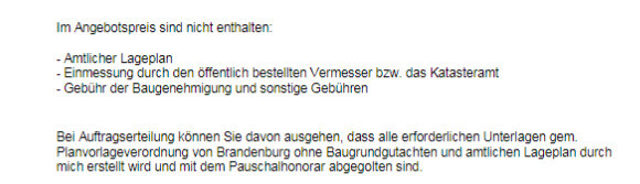

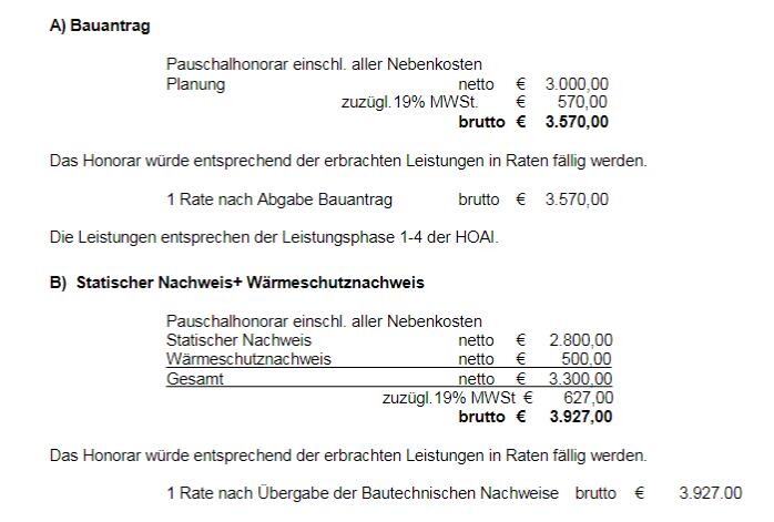

Since my thread was deleted without any explanation (for reasons unknown), I’m trying again here.
This is our offer:
Cost breakdown for the building permit application with net €3,000, VAT €570, gross €3,570.
Note: Documents not included (site plan, surveyor, fees) and flat-rate fee.
Is this okay? Can it be accepted?
Malunga
25 Jun 2020 16:15
3,000 euros for 1-4... If passion is included, of course
Ybias78
25 Jun 2020 16:18
If passion is included, then sure
So the architect is supposed to be good. I got a recommendation from an acquaintance. Of course, the tax will still be adjusted to 16%, but other than that, it seems doable?
Malunga
25 Jun 2020 16:47
If you like his projects and approaches, then I see no problem with that. The price is really very affordable.
